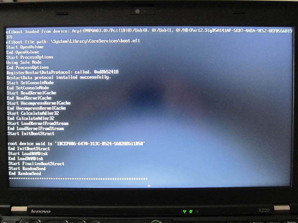

skoon432 Posted December 14, 2018 Share Posted December 14, 2018 (edited) tluck- I'll try an installation of High Sierra. I do have an untouched USB stick of that ready to go. If I have any sort of success, I'll let you know. Regarding a rollback to an earlier version of Clover.. There might be a way to do it from the Windows side but I'm far too much of a novice to know how to do that. I could roll back if I could get into OSX, but obviously that isn't happening at the moment Let me try an HS install and go from there. Thanks- Steve Edited December 14, 2018 by skoon432 Link to comment https://www.insanelymac.com/forum/topic/285678-lenovo-thinkpad-t420-with-uefi-only/page/180/#findComment-2653774 Share on other sites More sharing options...
skoon432 Posted December 14, 2018 Share Posted December 14, 2018 Well this didn't take long at all! High Sierra is suffering the same problem as Yosemite. It tries to start and it simply stalls out. OSX is seeing something it doesn't like, period. At this point, I give up. Whatever is wrong is far beyond my scope of understanding but I still firmly believe the fault lies in a bad version of Clover. I'm convinced that it had some sort of very bad bug in this specific version and it totally trashed up the OSX partition in some weird way. Oh how I wished I had just left it all alone and not tried upgrading to a newer Clover release. A lesson learned and now its too late! Link to comment https://www.insanelymac.com/forum/topic/285678-lenovo-thinkpad-t420-with-uefi-only/page/180/#findComment-2653780 Share on other sites More sharing options...
tasteTheBacon Posted December 14, 2018 Share Posted December 14, 2018 21 hours ago, tasteTheBacon said: Its all lead to the same result. To be pro-active: I've tried everything, even reset my bios settings, deleted and re-copied everything to the SSD ESP. None of these helped. But fortunately, I figured it out, sort of. The solution for me was to go in to the Clover Options menu while booting up and manually select a different config.plist and then re-select the default one (Which was highlighted by default). Without this manual step the boot hangs. With it it boots fine. I've even got the HD3000 kext loaded and brightness working with this step. If you ask me it doesn't make any sense to me. Can this be a Clover bug? Not sure if you have any tip on how to skip this manual step, but either way, thank you for the support @tluck , and also @goodguess for the tip. It's all highly appreciated. 1 Link to comment https://www.insanelymac.com/forum/topic/285678-lenovo-thinkpad-t420-with-uefi-only/page/180/#findComment-2653784 Share on other sites More sharing options...

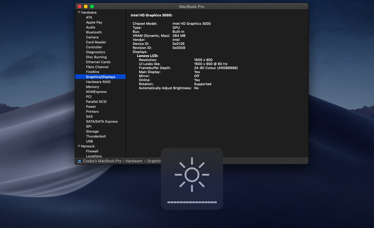

tluck Posted December 18, 2018 Share Posted December 18, 2018 (edited) so i figured out why the Panel LCD brightness slider is missing for some folks. WhateverGreen conflicts with the AppleBackupLightInjector so it is not setting the ApplePanel property correctly. it is missing F10Txxxx in its Info.plist So for now remove WhatheverGreen.kext from your ESP or /L/E or add this to the Info.plist <key>F10Txxxx</key> <data> ABEAAACMANgBNgGPAf4CowNFA+cExwU1B1oJHAsTDZsQ WRMS </data> to the WhateverGreen.kext/Contents/Info.plist right above F14Txxxx Edited December 18, 2018 by tluck Link to comment https://www.insanelymac.com/forum/topic/285678-lenovo-thinkpad-t420-with-uefi-only/page/180/#findComment-2654326 Share on other sites More sharing options...

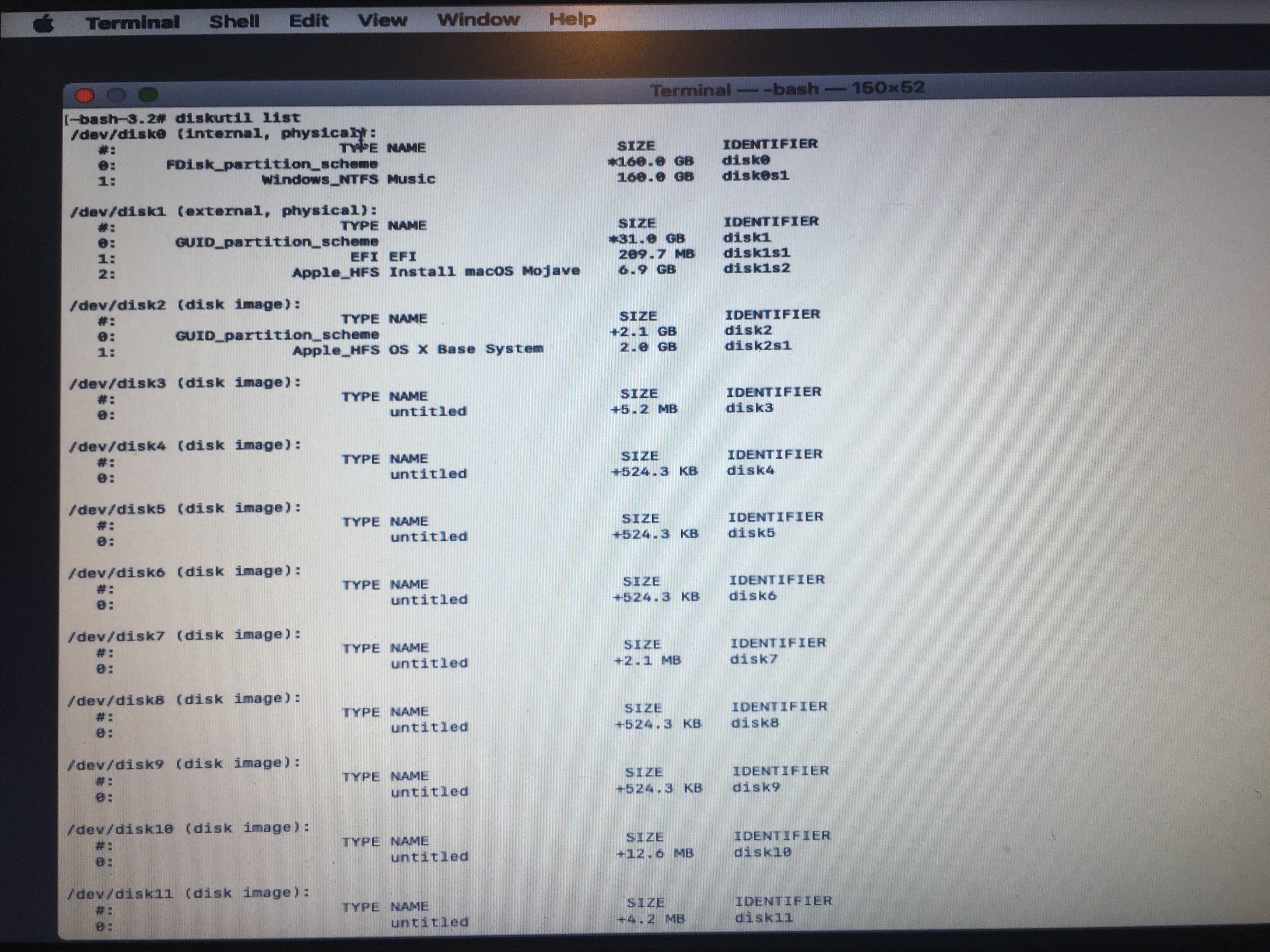

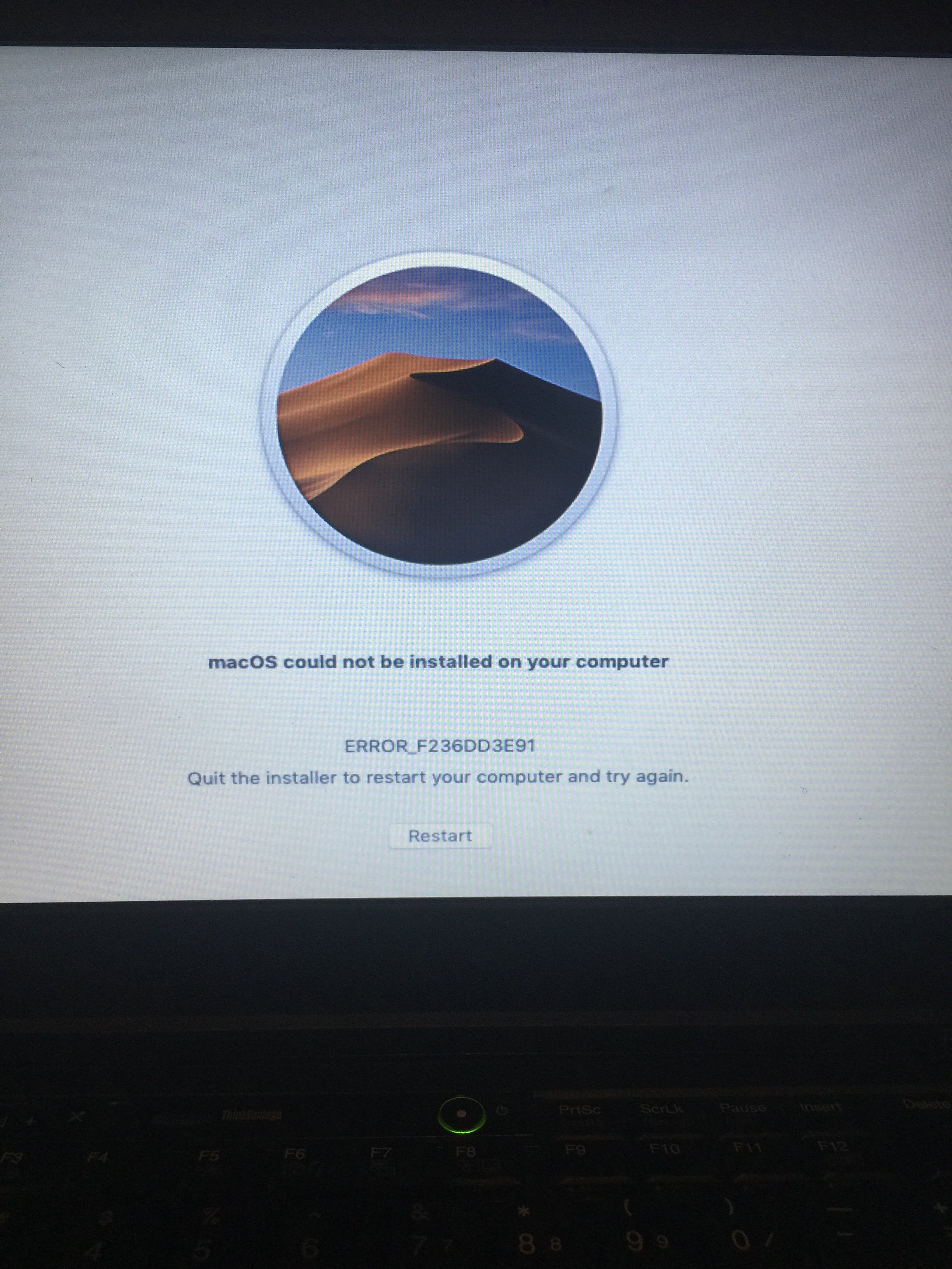

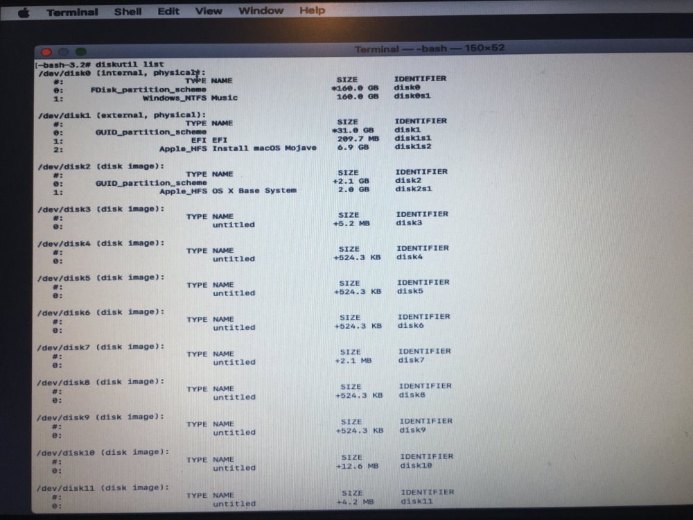

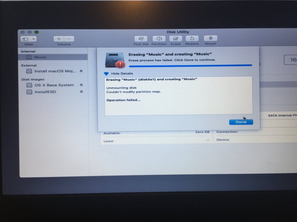

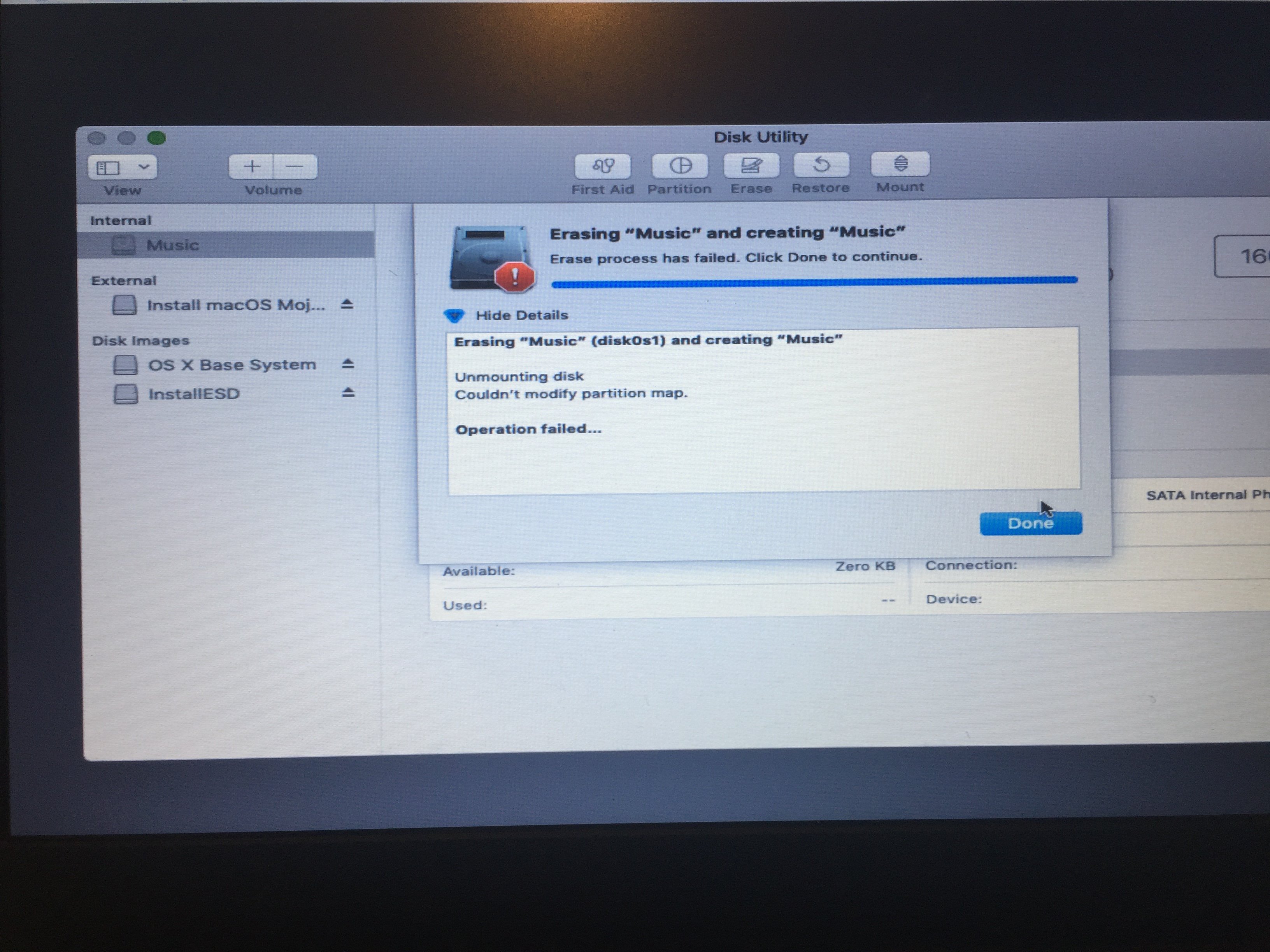

namisloc Posted December 27, 2018 Share Posted December 27, 2018 (edited) Hi T420 peeps! I'm a first time hackintosh builder and I could use some help getting my machine off the ground. I've researched for about a week and I've spent a couple days just trying to get a mountable USB to use (and I'm not even sure if I did that correctly). To some extent I followed TLuck's guide, but I had to create some workarounds for limitations - I'm not sure if maybe I skipped something vital that is creating my current road block. Pertinent information 83ET79WW BIOS 1.49 41786vu intel i5-2520 2.5ghz Intel HD 3000 x Nvidia NVS 4200m 1600x900 BIOS settings Album Creating the USB... After many attempts to create a working USB install directly from my windows desktop using things like R-drive, rufus, win32diskimager, etc., I ended up creating a Mojave environment in VM Workstation. However, I cannot download a copy of Mac OS from the app store, for some reason it keeps returning with an 'incomplete' error even though it's up-to-date. At any rate, I downloaded a .raw file from olarila and used etcher to flash it to my USB. I then ran Clover r4726 pkg from the 10-31-2018 utilities and plugged it into the T420. USB finally working... I boot to clover and the initialization scripts run - I finally see the "Install Mac OS" and disk utility. Which brings me to my current road block: I cannot write to my internal disk. I have unplugged it and swapped it into my desktop to reformat to no avail. I also swapped in a spare clean drive with no luck. My gut feeling is that something in the BIOS is stopping the USB installer from speaking to the hard disk. Any ideas? EDIT: I'm so dumb. "diskutil eraseDisk JHFS+ disknamehere disk0" formatted it with no issues. However now it says that I can't install 10.14 on this computer... ERROR_F236DD3E91 --------------------------------------------------------------------------------------------------------------------------------------------------------------------------- When I run "diskutil list", I'm met with about 30 "drives" including my 160gb install drive and the USB, but also ~28 weird drives of varying sizes. Attempted First aid: Running First Aid on "" (disk0s1) Repairing file system. volume is already unmounted. performing fsck_exfat -y -x /dev/rdisk0s1 checking volume. checking main boot region. main boot region is invalid. trying alternate boot region. checking alternate boot region. alternate boot region is invalid. the volume could not be verified completely. file system check exit code is 1. restoring the orignal state found as unmounted file system verify or repair failed Operation failed... Attempting to format/erase: Edited December 27, 2018 by namisloc Link to comment https://www.insanelymac.com/forum/topic/285678-lenovo-thinkpad-t420-with-uefi-only/page/180/#findComment-2656009 Share on other sites More sharing options...
goodguess Posted December 28, 2018 Share Posted December 28, 2018 Hi namisloc. I would assume that you did hit several obstacles at one time. My thoughts: - A macOS Hackintosh can not boot with two active GPU. Did you disable the NV graphics in BIOS? - HD 3000 IvyBridge laptops are incompatible with 10.14 Mojave. - Your boot volume should be empty and clean for installation. Best use a Gparted Live CD to swipe clean your HDD/SSD. If I was in your place, I would step back to a Snow Leopard machine and prepare a bootable USB device for 10.11/10.12/10.13 from there. Snow Leo still runs fine on Core2Duo rigs. You may install with Nawcoms Mod CD and a SL retail DVD from the Internet Archive. A virtual machine running 10.6 Server is another option of course. As you got macOS on your boot USB device with tlucks EFI package, you may install on your T420. Of course tluck´s EFI package has to be copied to your HDD/SSD to boot from it. Remember that the Clover package must be installed onto the hidden EFI partition EFI/EFI/Clover. The EFI partition is automatically created by macOS DiskUtility when initialising your HDD/SSD as HFS drive. (Use a GPT partition table at this step.) As you got e.g 10.12 on your T420 and booting with tlucks EFI package, you may DL 10.14 from the app store, as the T420 pretends to be a MBP late 2013 which is supported for Mojave upgrades. Mojave will only work with the new APFS file system. You can only format your HDD as APFS as you already got Mojave. When upgrading to Mojave from an earlier macOS, your HDD/SSD will be converted to APFS by force. The procedure may fail for several reasons: Too little room on the given device, Mojave dislikes the drive, its a Monday, etc. Either way, be aware that the upgrade will take a really long time and may fail several times. It may be recommendable to start a new thread for your work. Most of us here already had several macOS versions on their T420 and do read here only for fine tuning. Link to comment https://www.insanelymac.com/forum/topic/285678-lenovo-thinkpad-t420-with-uefi-only/page/180/#findComment-2656105 Share on other sites More sharing options...
bxe Posted December 29, 2018 Share Posted December 29, 2018 (edited) Hi, first of all thanks to everyone keeping this alive. I recently upgraded to Mojave after having El Capitan installed for more than 2 years without any serious problems, but it was time to upgrade... Install went smooth but I'm having same issues with black screen as @tasteTheBacon . His solution to remove all configs and use default config.plist worked and now I can boot fine, but there are some problems: brightness adjustment doesn't work - I guess it will work with the 1600x900 mojave config.plist if the booting problem is fixed. I've also noticed that I'm sometimes getting system freezes for few seconds if I click on some items in the menu bar (Apple logo for example) or when I use Preview app or similar image viewers (Xee^3), it is very random and difficult to reproduce as it didn't happen during writing of this post when I tried to randomly click on items in the menu bar. Is anyone else having same problems? I might try to downgrade to High Sierra, but dark mode feature is great. Also my T420 configuration is: i5 2520M CPU, 1600x900 resolution, 16GB RAM if that helps. Edit: Now it froze completely and had to reboot when I tried to open video with Quicktime, also now I've noticed that I can move cursor around while it is frozen. Edited December 29, 2018 by bxe Link to comment https://www.insanelymac.com/forum/topic/285678-lenovo-thinkpad-t420-with-uefi-only/page/180/#findComment-2656271 Share on other sites More sharing options...
goodguess Posted December 29, 2018 Share Posted December 29, 2018 Hi bxe! Got exactly the same T420 config as the one you posted. Did you install Mojave over your existing El Cap? I recall some black screens and freezes during the Mojave upgrade, but things are working fine since (booting with -v). I´m using tluck´s 1600x900config.plist renamed to config.plist. The only issue I found so far is Preview not opening jpg files. I did assign jpg files to "XnView MP MacOSX" but Finder displays the ever spinning cartwheel when clicking a jpg just the same. I had a system freeze yesterday after inserting a SD card from a camera - tons of JPEG on it of course. My guess is that Finder/Preview tries to access the metal API, which is unsupported by our SandyBridge iGPU. Other apps may call for metal too, thus freezing the hack, could you share the QT file in question eventually? Link to comment https://www.insanelymac.com/forum/topic/285678-lenovo-thinkpad-t420-with-uefi-only/page/180/#findComment-2656317 Share on other sites More sharing options...
