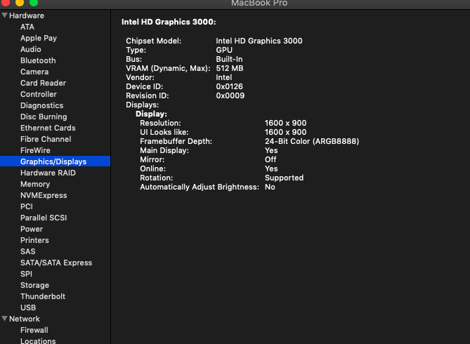

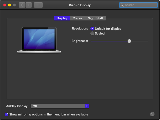

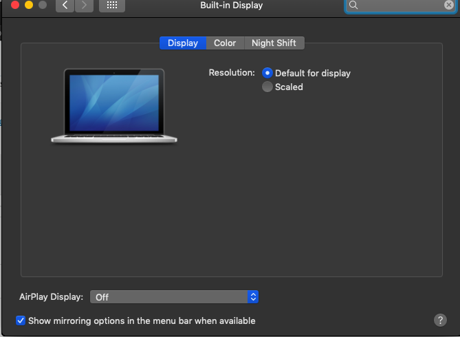

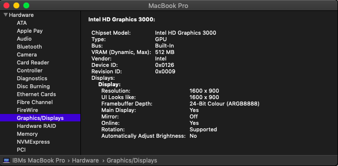

snike Posted November 12, 2018 Share Posted November 12, 2018 Hi, Finally got Mojave working on the T420 (HD300 1600X900). Noticed that the Brightness keys were not working. But then I see that the brightness slider is missing from the System Pref --> Display option. I thought we did have a brightness slider there. Not sure where to look, is it a problem with the keyboard mapping or is some kext not working as it should. I have done the Mojave Hack and also updated to the 10-31 zip. Link to comment https://www.insanelymac.com/forum/topic/285678-lenovo-thinkpad-t420-with-uefi-only/page/178/#findComment-2647132 Share on other sites More sharing options...

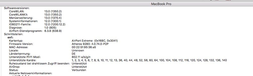

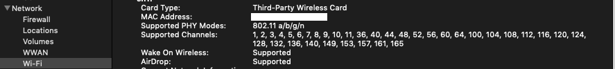

pcace Posted November 12, 2018 Share Posted November 12, 2018 Hey, i have a question again... i am running 10.13.6 and just bought a new wifi card: AR9280 AR5BHB92. it should be able to do 5GHZ, but i cannot see any network! The only think wich looks strange to me is, that the profiler just sais it can do up to channel 140 - and shuldnt be there 160 channels for 5GHZ? So if anyone knows how to fix that it would be just awesome!!!! So my goal is to have it running in 300mbit 5hgz. Any chance to do that? Cheers, Pcace B Link to comment https://www.insanelymac.com/forum/topic/285678-lenovo-thinkpad-t420-with-uefi-only/page/178/#findComment-2647267 Share on other sites More sharing options...

goodguess Posted November 15, 2018 Share Posted November 15, 2018 @ snike: Not sure what you did, actually. The Mojave Hack is for Macs afaik. Are you using the pre-build EFI folder, tluck posted at GitHub? I have the slider and the brightness keys with my T420. @ pcace: Thats really weird. You will hardly need channels above 140 though. Ch 100 to 140 may run with 1000 mW, Ch 149 to 165 may only output 25 mW ! As a lazy guy, I´m using a DELL 1510 WiFi card, as I wanted a Broadcom chip. @Arttu: Did you select the correct config.plist in EFI/EFI/Clover from the package tluck offers? A small screen lets me assume that your HD3000 kexts did not load correctly and/or that your T420 is running without GPU hardware acceleration. Does Alt-Shift-3 work for taking a screenshot on your side? Does your Graphics/Display section look like this? Link to comment https://www.insanelymac.com/forum/topic/285678-lenovo-thinkpad-t420-with-uefi-only/page/178/#findComment-2647798 Share on other sites More sharing options...
snike Posted November 18, 2018 Share Posted November 18, 2018 On 11/15/2018 at 12:20 PM, goodguess said: @ snike: Not sure what you did, actually. The Mojave Hack is for Macs afaik. Are you using the pre-build EFI folder, tluck posted at GitHub? I have the slider and the brightness keys with my T420. @ pcace: Thats really weird. You will hardly need channels above 140 though. Ch 100 to 140 may run with 1000 mW, Ch 149 to 165 may only output 25 mW ! As a lazy guy, I´m using a DELL 1510 WiFi card, as I wanted a Broadcom chip. @Arttu: Did you select the correct config.plist in EFI/EFI/Clover from the package tluck offers? A small screen lets me assume that your HD3000 kexts did not load correctly and/or that your T420 is running without GPU hardware acceleration. Does Alt-Shift-3 work for taking a screenshot on your side? Does your Graphics/Display section look like this? I mean the hack for getting the HD3000 kexts. I am using the Pre built folder from Tluck's Github. This is how it looks for me Link to comment https://www.insanelymac.com/forum/topic/285678-lenovo-thinkpad-t420-with-uefi-only/page/178/#findComment-2648275 Share on other sites More sharing options...

tluck Posted November 19, 2018 Share Posted November 19, 2018 @SuperReaper - hard to know what is going on in your situation. i was able to install Sierra, HighSierra and Mojave with the same configuration i posted... @snike - where did you install the GFX kext in /L/E or /S/L/E? - i cant figure out how to not get the slider!? run these commands to see what you get: $ ioreg -l|grep -v Diag |grep IODisplayPar | | | | | "IODisplayParameters" = "IOFramebufferParameterHandler is not serializable" | | | | | "IOMatchCategory" = "IODisplayParameters" | | | | | "IODisplayParameters" = {"commit"={"reg"=0},"fade-time2"={"min"=0,"max"=10000,"value"=4000},"linear-brightness-probe"={"min"=0,"max"=4866,"value"=4866},"ggsc"={"min"=0,"max"=65536,"value"=65536},"vblm"={"min"=0,"max"=196608,"value"=65536},"dsyp"={"min"=0,"max"=2,"value"=2},"rgsc"={"min"=0,"max"=65536,"value"=65536},"fade-style"={"min"=0,"max"=10,"value"=0},"fade-time1"={"min"=0,"max"=10000,"value"=500},"bgsc"={"min"=0,"max"=65536,"value"=65536},"brightness-probe"={"min"=0,"max"=1024,"value"=1024},"fade-time3"={"min"=0,"max"=10000,"value"=500},"bklt"={"min"=0,"max"=4882,"value"=4866},"linear-brightness"={"min"=0,"max"=4866,"value"=4866},"brightness"={"max"=1024,"min"=0,"value"=1024},"brightness-fade"={"min"=0,"max"=1023,"value"=0},"usable-linear-brightness"={"min"=1220,"max"=4866,"value"=4866}} | | | | | "IODisplayParameters" = "IOFramebufferParameterHandler is not serializable" | | | | | "IOMatchCategory" = "IODisplayParameters" | | | | | "IODisplayParameters" = "IOFramebufferParameterHandler is not serializable" | | | | | "IOMatchCategory" = "IODisplayParameters" | | | | | "IODisplayParameters" = "IOFramebufferParameterHandler is not serializable" | | | | | "IOMatchCategory" = "IODisplayParameters" | | "IOMatchCategory" = "IODisplayParameters" | | "IODisplayParameters" = {"brightness"={"max"=255,"min"=40},"commit"={"reg"=0}} $ ioreg -l|grep -v Diag |grep ApplePanel | | | "ApplePanelRawBrightness" = 4882 | | "ApplePanel" = {"F10T02e3"=<00110000008c00d80136018f01fe02a3034503e704c70535075a091c0b130d9b10591312>} Link to comment https://www.insanelymac.com/forum/topic/285678-lenovo-thinkpad-t420-with-uefi-only/page/178/#findComment-2648509 Share on other sites More sharing options...
tluck Posted November 19, 2018 Share Posted November 19, 2018 @pcace on your wifi -- i have the same card. but i wonder if the range of values has to do with the locale set? mine is set to FCC... a long time ago i remember re-flashing the chip. i connect at 300 at 5 Ghz on channel 48 Quote Software Versions: CoreWLAN: 13.0 (1370.8) CoreWLANKit: 13.0 (1370.8) Menu Extra: 13.0 (1376.2) System Information: 12.0 (1300.2) IO80211 Family: 12.0 (1200.12.2) Diagnostics: 1.0 (805) AirPort Utility: 6.3.9 (639.7) Interfaces: en1: Card Type: AirPort Extreme (0x168C, 0x1081) Firmware Version: Atheros 9280: 4.0.74.0-P2P MAC Address: xxxxxxxxxxxx Locale: FCC Country Code: US Supported PHY Modes: 802.11 a/b/g/n Supported Channels: 1, 2, 3, 4, 5, 6, 7, 8, 9, 10, 11, 36, 40, 44, 48, 52, 56, 60, 64, 100, 104, 108, 112, 116, 120, 124, 128, 132, 136, 140, 149, 153, 157, 161, 165 Wake On Wireless: Supported AirDrop: Supported Status: Connected Current Network Information: LuckyDog: PHY Mode: 802.11n Current Network Information: LuckyDog: PHY Mode: 802.11n BSSID: xxxxxxxxxxxx Channel: 48,-1 Country Code: US Network Type: Infrastructure Security: WPA2 Personal Signal / Noise: -45 dBm / -96 dBm Transmit Rate: 300 MCS Index: 15 1 Link to comment https://www.insanelymac.com/forum/topic/285678-lenovo-thinkpad-t420-with-uefi-only/page/178/#findComment-2648565 Share on other sites More sharing options...

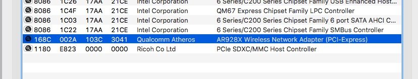

pcace Posted November 19, 2018 Share Posted November 19, 2018 (edited) On 11/15/2018 at 6:20 PM, goodguess said: @tluck Hey, Thank you for your quick response! I originally looked for the channels, because i cannot see my 5Ghz network, (which runs at channel 140 ?!) - but with my proper MacPro i can see it. The second strange thing is, that it only uses a single channel, even if it is dualchannel - wich should allow connections up to 300mbit even in 2,4ghz. That was the reason why i imagined that there might be a problem related to the channels the card can see? But probably i am wrong. What exact chipset are you using? Or can you suggest one wich fits in the T420 and maybe also does triplechannel wifi on 5GHZ + runs out of the box? ? If you have any idea... ....that would be just awesome! Oh, there is no way to tell you how much i appreciate your work, support and help here! Just amazing!!! Thanks! Quote @ pcace: Thats really weird. You will hardly need channels above 140 though. Ch 100 to 140 may run with 1000 mW, Ch 149 to 165 may only output 25 mW ! As a lazy guy, I´m using a DELL 1510 WiFi card, as I wanted a Broadcom chip. EDIT: @tluck i just saw your second post! Thats what i was reading around but i never really found a definite answer, nor a definite way to reflash it. I Guess i would have to reflash Vendor, Device and subvendor ID, + Vendor name? Do you know of any working tutorial for this? I got the card working by just adding " <string>pci168c,2a</string> " to "/System/Library/Extensions/IO80211Family.kext/Contents/PlugIns/AirPortAtheros40.kext/Contents/Info.plist " Soooo if you know of any method... ...let me know!! Or maybe you could let me know what exact values your card runs on... ...ill figure out a way to flash it EDIT2: i guess i found a method. At least i dumped the Firmware as hex from the Atheros... did this with a tool i found here: https://github.com/andyvand/AtherosROMKit But i just cannot find the appropiate hex to change.. is anyone clever enough to find it? It is attached... Thanks!! hex_dump2 Edited November 19, 2018 by pcace Link to comment https://www.insanelymac.com/forum/topic/285678-lenovo-thinkpad-t420-with-uefi-only/page/178/#findComment-2648594 Share on other sites More sharing options...
tluck Posted November 20, 2018 Share Posted November 20, 2018 (edited) @pcace do you have windows to test this card? the macOS atheros driver does not seem to be as "good" as the atheros windows drivers. meaning i recall connecting at like 450 on windows, but just 300 for macOS? Note: i didnt have to edit/modify any atheros kexts drivers (other than adding in Mojave), it just works out of the box for that same card. Edited November 20, 2018 by tluck Link to comment https://www.insanelymac.com/forum/topic/285678-lenovo-thinkpad-t420-with-uefi-only/page/178/#findComment-2648768 Share on other sites More sharing options...
goodguess Posted November 20, 2018 Share Posted November 20, 2018 Hi pcace! Here is the type of card I bought years ago, the chipset specs can be seen on the pictures. https://www.amazon.com/Brand-PW934-Half-Size-Wireless-802-11AGN/dp/B00B5A0NGU/ref=sr_1_fkmr0_1?ie=UTF8&qid=1542746683&sr=8-1-fkmr0&keywords=dell+1510+m+pci-e 1 Link to comment https://www.insanelymac.com/forum/topic/285678-lenovo-thinkpad-t420-with-uefi-only/page/178/#findComment-2648789 Share on other sites More sharing options...

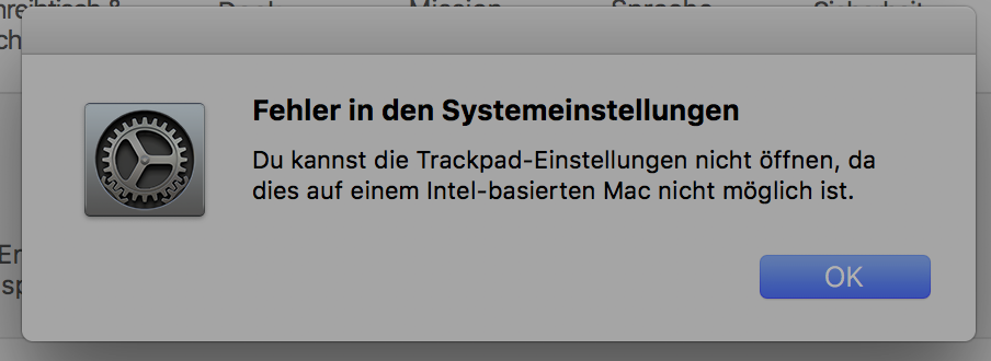

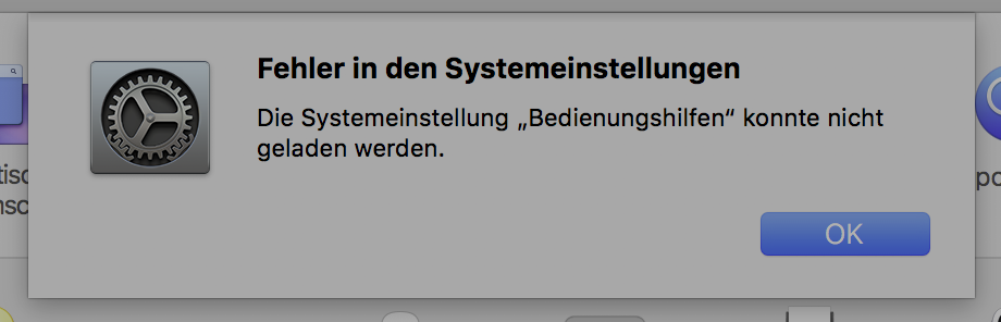

solodohm42 Posted November 22, 2018 Share Posted November 22, 2018 Hi, running 10.13.6 on my Lenovo W520 i7, 32 GB RAM, IntelHD3000 since 2 months or so. Everything fine so far ... till last system update, maybe two weeks ago. Probably minor security update or so. Since then I am not able to open some preference panes any more (keyboard, mouse, trackpad, accessibility) Regarding the first three i get a message that it's not possible to open the panel because I am on an intel machine, with accessibility its's just a 'could not be loaded' message. ...added screenshots Anybody having the same problem ? Clue of a solution ? Link to comment https://www.insanelymac.com/forum/topic/285678-lenovo-thinkpad-t420-with-uefi-only/page/178/#findComment-2649157 Share on other sites More sharing options...
Tetonne Posted November 25, 2018 Share Posted November 25, 2018 On 11/20/2018 at 10:56 PM, goodguess said: Hi pcace! Here is the type of card I bought years ago, the chipset specs can be seen on the pictures. https://www.amazon.com/Brand-PW934-Half-Size-Wireless-802-11AGN/dp/B00B5A0NGU/ref=sr_1_fkmr0_1?ie=UTF8&qid=1542746683&sr=8-1-fkmr0&keywords=dell+1510+m+pci-e i bought this cos the one i had wasn't compatible Link to comment https://www.insanelymac.com/forum/topic/285678-lenovo-thinkpad-t420-with-uefi-only/page/178/#findComment-2649821 Share on other sites More sharing options...
