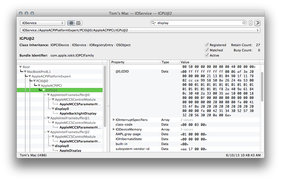

tluck Posted June 10, 2013 Share Posted June 10, 2013 @honeywell - interesting!!! so i tried your EDID from the dsdt you posted (which i presume you just replace the EDID block with your EDID.) well that seems to remove glitches/hangs too. so perhaps its about having a EDID defined at this level (IGPU vs Display ) and not so much a particular EDID that works. your model is a bit different than mine. Vendor 6af Product 203e (vs mine is 213e) - so it would be looking for a display settings in /System/Library/Displays/Overrides/DisplayVendorID-6af/DisplayProductID-203e i attached zip with your dsdt (source and compiled) and your display stuff this is iasl compiler that i used to compile the dsdt.dsl the Display Override file for your product id (203e - is decimal 8254) honeywell.zip Link to comment https://www.insanelymac.com/forum/topic/285678-lenovo-thinkpad-t420-with-uefi-only/page/10/#findComment-1921203 Share on other sites More sharing options...
honeywell Posted June 10, 2013 Share Posted June 10, 2013 I compiled it with DSDT Editor and then followed the instructions here http://www.insanelymac.com/forum/topic/208410-fixing-scrambledstretched-or-wrong-resolution-laptop-display-problems/ to create a DisplayOverride. Still getting graphics lag though... Using Chimera btw. Link to comment https://www.insanelymac.com/forum/topic/285678-lenovo-thinkpad-t420-with-uefi-only/page/10/#findComment-1921205 Share on other sites More sharing options...

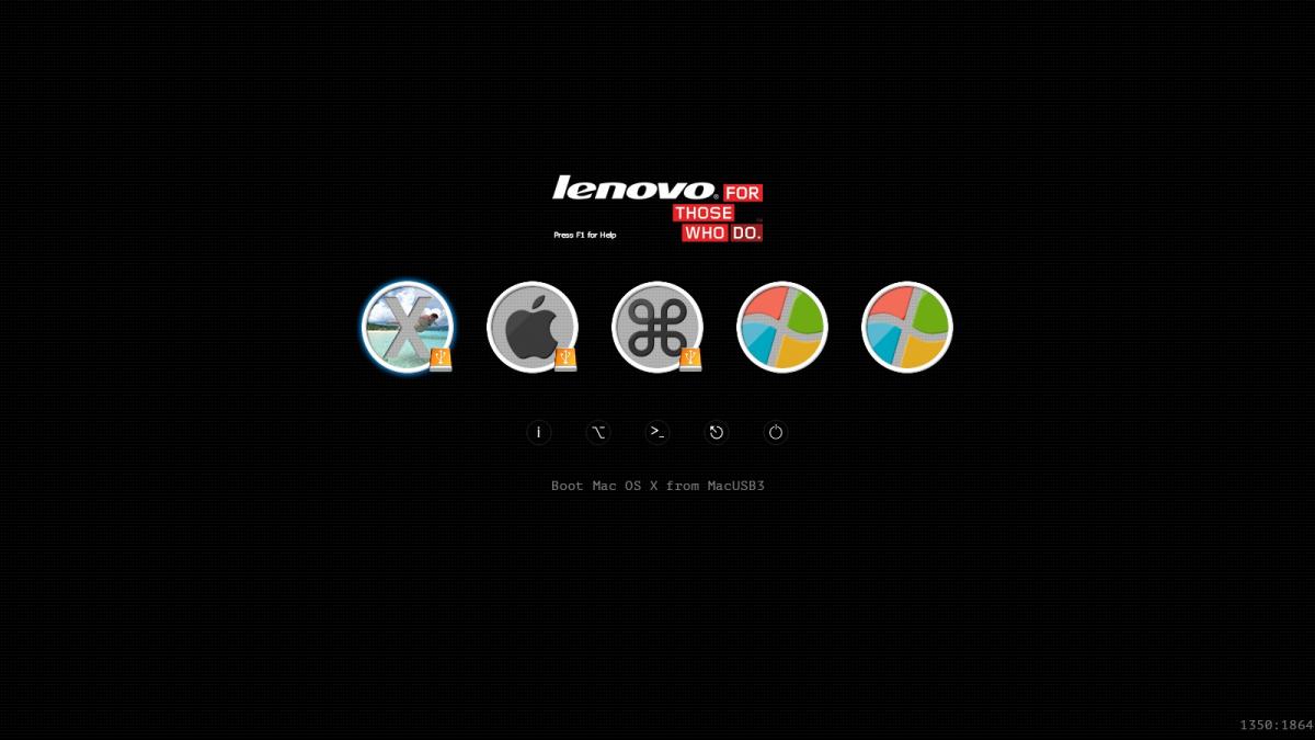

K0gen Posted June 22, 2013 Author Share Posted June 22, 2013 Today we had some fun with @k3nny about the OSX Mavericks icon in ThinkPad theme and we came up with this. (just in case you were wondering who is making the Mavericks) I think this Mavericks icon will be the official 10.9 Developer Preview icon in ThinkPad theme Here is the file: os_mav.icons.zip 2 Link to comment https://www.insanelymac.com/forum/topic/285678-lenovo-thinkpad-t420-with-uefi-only/page/10/#findComment-1926912 Share on other sites More sharing options...

tluck Posted June 24, 2013 Share Posted June 24, 2013 @dnr - where does it get stuck? using that OEM folder presumes you moved all the kexts from /EFI/CLOVER/kexts to your system in /S/L/E. just checking. @honeywell when I Kogen's EDID - i get rid 99.99% glitches and hangs. but besides EDID, i did upgrade to BIOS 1.44 and i shut off VT-d virtualization. even when using my old dsdt .... tried to recreat the problem but now i barely get glitches or hangs, compared to what i used to get (had to use quartz debug to turn off 2d acell it was so painful). Link to comment https://www.insanelymac.com/forum/topic/285678-lenovo-thinkpad-t420-with-uefi-only/page/10/#findComment-1927230 Share on other sites More sharing options...
