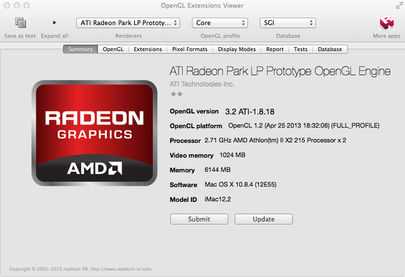

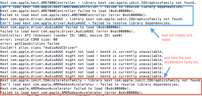

marl Posted June 26, 2013 Share Posted June 26, 2013 Hi Devs! I got this windows installed box.And this is my graphics card.I tried and edit many kext on 10.8.4 but still no works.can anyone tell me what should I read about how kext works, why kext not load and so so, please? and based on this image below, I thought my card is 5570 right? Link to comment https://www.insanelymac.com/forum/topic/285551-ati-graphic-issues-on-amd-ml-hackintosh-systems/page/7/#findComment-1927984 Share on other sites More sharing options...
theconnactic Posted June 26, 2013 Share Posted June 26, 2013 Man, I just noticed you didn't post details about your computer. The most important question, that amazingly nobody asked: is it an APU laptop? Because if it is, you're wasting your time: it won't have qe/ci no matter how and what kexts you edit, the ROMs you add etc. The only hope would be to disable the integrated graphics in the BIOS, and I said would, because every single APU laptop in the market comes with the despicable InsydeH2O BIOS, absolutely locked and unmodifiable. Therefore, repeat, if it's an APU laptop, don't waste your time - and ours - trying to fix graphics, but focus on what can be fixed. Of course, if it's not an APU laptop, disregard my post. All the best! Ps: if it's a desktop, but the card is onboard, the same advice stands: don't waste your time. This case, though, you can indeed solve the issue by buying a cheap ATI 5450 silent model (dev I'd 0x68f91002) Link to comment https://www.insanelymac.com/forum/topic/285551-ati-graphic-issues-on-amd-ml-hackintosh-systems/page/7/#findComment-1928016 Share on other sites More sharing options...
marl Posted June 26, 2013 Share Posted June 26, 2013 @theconnacticI dunno who you are reply for but if it's me I will gladly describe my detail:Board: M68M-S2PCPU: Athlon II X2 240OS: 10.8.4 (Updated from iAtkos ML2)Graphics Card: (Addons) Radeon HD 5570First boot after installed I can't reach login screen, it stuck and I got solutin from this forum.I deleted All /S/L/E/ATI* /S/L/E/GeFo* /S/L/E/AppleIntel*I tried and edit(add 0xblablabla in Info.plist) many kext.I tried many boot flags, UseAtiROM=(Yes/No) AtiConfig=(Eulemur/Hoolock/Shrike) with GE=Yes but won't boot but with GE=NoSo, I there something I missed about this kext?I noticed theres .bundle and .plugin for each ATI/NVDA kext.I copied those file to /S/L/E and chown and chmod too.and I rebuild the kext cache too. And of course I've tried -f boot flags.I see some thread get 5570 works but only for SL.I just curious, my fellow hackint0sh user.Is there any way to get this works?I don't mind to do RTFM. Just give me a bunch of writings and I will sincerely read that Forgive my noobness.Marl. Link to comment https://www.insanelymac.com/forum/topic/285551-ati-graphic-issues-on-amd-ml-hackintosh-systems/page/7/#findComment-1928048 Share on other sites More sharing options...
theconnactic Posted June 26, 2013 Share Posted June 26, 2013 If it's the 5570, it definitely works with Mountain Lion. Read this: http://www.insanelymac.com/forum/topic/285569-ati-radeon-hd5570-mountain-lion/ What's the ID of your card? The 0x68d91002 is more troublesome to get working than the 0x68be1002 and the 0x68d81002 (these two work with Mountain Lion out of the box). All the best! Link to comment https://www.insanelymac.com/forum/topic/285551-ati-graphic-issues-on-amd-ml-hackintosh-systems/page/7/#findComment-1928086 Share on other sites More sharing options...
marl Posted June 26, 2013 Share Posted June 26, 2013 I read that. I just Copied /S/L/E/{AMD*,ATI*} from my working updated mac (laptop). Changed SMBIOS to iMac12,2 Added 0x657f1002 to ATI5000Controller.kext/Content/Info.plist boot with 'GraphicsEnabler=Yes AtiConfig=Eulemur npci=0x{2000/3000} -v -f' and..... My LCD (VGA cable) can't display it. I call this progress! Fortunately I turn screen sharing on I knew my LCD can display properly in 1280x960 at 75Hz. I set screen resolution to as I mentioned before, and it simply can't displaying my desktop. My LCD says "Cannot Display This Video Mode" just like another LCD while can't reach bigger screen resolution / refresh rate. In screen sharing client side, I barely see "About This Mac" because the screen is almost full of flicker. But I'm pretty sure it displaying Graphics (My card was detected!) Any suggestion what should I do next? thanks for your help so far PS: I don't have any LCD working. Link to comment https://www.insanelymac.com/forum/topic/285551-ati-graphic-issues-on-amd-ml-hackintosh-systems/page/7/#findComment-1928160 Share on other sites More sharing options...
theconnactic Posted June 27, 2013 Share Posted June 27, 2013 Boot with -x! Link to comment https://www.insanelymac.com/forum/topic/285551-ati-graphic-issues-on-amd-ml-hackintosh-systems/page/7/#findComment-1928308 Share on other sites More sharing options...
marl Posted June 27, 2013 Share Posted June 27, 2013 Boot with -x! Tried before. nothing changes. and now my screen sharing won't work xD is it kext problem or just plain unsupported resolution/refresh rate? Link to comment https://www.insanelymac.com/forum/topic/285551-ati-graphic-issues-on-amd-ml-hackintosh-systems/page/7/#findComment-1928337 Share on other sites More sharing options...

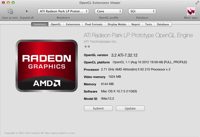

Shaneee Posted July 5, 2013 Share Posted July 5, 2013 Could the difference between OpenCL and OpenGL be the problem? A rollback would do the trick but unfortunately doesn't work. Difference from 10.7.5 to 10.8.4 Link to comment https://www.insanelymac.com/forum/topic/285551-ati-graphic-issues-on-amd-ml-hackintosh-systems/page/7/#findComment-1930356 Share on other sites More sharing options...
