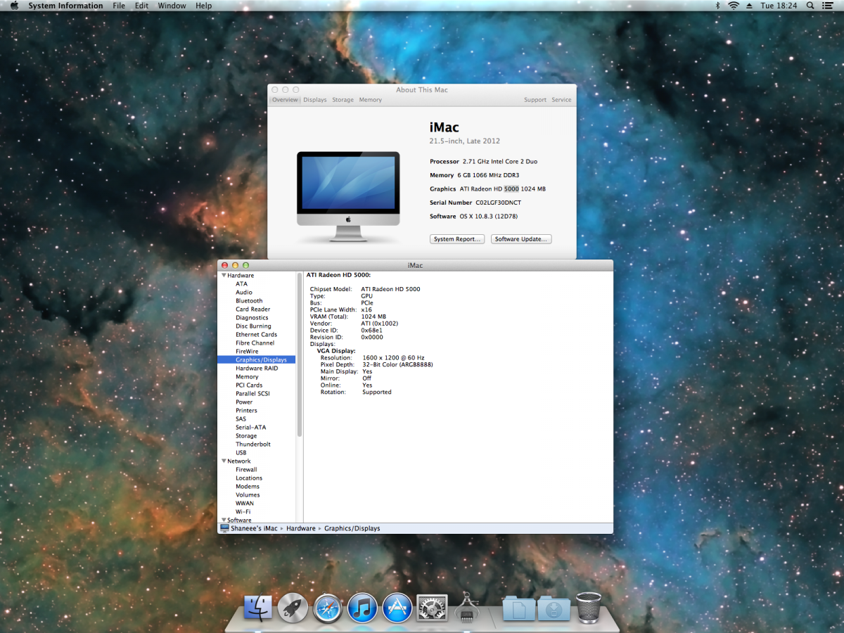

Hello :) Just bought a Sapphire HD 5450 1GB. I will still use the nvidia card for testing. I installed 10.8.2. Added the device and vendor ID's to AmdRadeonAccelerator and Ati5000Controller and it booted with full QE/CI with some corruption here and there. I then updated to 10.8.3 and corrected the two files, rebooted and no QE/CI. Added ATY_Init and reboot, QE/CI again :) Problem is I have alot or graphic corruption and my card is only detected as a HD 5000. Would a DSDT help?

Shane, it's the Sapphire 5450 silent, device ID 68F91002, as in the topic Working ATI cards? http://www.insanelym...ionlion-64-bit/ if it's not, try to convince the retailer, since you just bought it, to accept you returning it and taking the other :)
It seems quite unlikely our results being that different. Remove ATI init! Just correct again the two kexts, rebuild caches before restart, repair permissions etc and reboot with GE=No and PCIRootUID=0. It will indeed be reported as HD5000, but no glitches should appear in Chrome - Safari is the only one app affected by them in my machine - or Firefox (in Firefox you must disable HW acceleration in Preferences) or any other application. If you can, use the HDMI port, since it's the one i use for my excellent results and, as said in the linked topic, it's the only one i cared to test.

No its not the silent. 0x68E11002 Works great in Lion and Snow in both x86_64 and i386. Snow fully detects it correctly. According to the OSx86 Wiki it works in 10.8.2 which it did with minimal glitches but 10.8.3 is a whole other story. I am currently using the DVI port just now but will try VGA and the HDMI also. This card and the ASUS are the only 5450 cards they had lol I will get it to work 100% soon enough lol.

As expected. Well, it's a different hw altogether, but i'd say 1) remove ATY_init, 2) add the device ID to the ATI5000 and RadeonAccelerator kexts, 3) rebuild caches, 4) boot with GE=no and PCIRootUID=0. If 2) fails, try using 10.8.2 files, rebuild caches and reboot.

P.S.: obviously, the steps 1-4 above involve no DSDT: remove it.
I found DSDT edits for my card and have applied them and edited the two kexts. Booting with no GE and the original files from 10.8.3. I now have minimal glitches. It is useable now. As you said though safari is a no go. Going to have a bash at HDMI sound now :)
