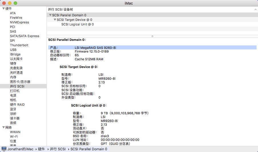

vjwz Posted April 27, 2017 Share Posted April 27, 2017 It works on my OSX Sierra. It's awsome. Thanks a lot! CPU: Xeon E3-1245v2 Main Board: Gigabyte Z77X-UP5-TH Graphic Card: GTX970 RAID: LSI 9260-8i( 4*3T, RAID 5) Link to comment https://www.insanelymac.com/forum/topic/285197-driver-for-lsi-megaraid-sas-family/page/15/#findComment-2413199 Share on other sites More sharing options...

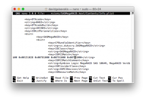

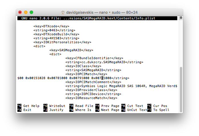

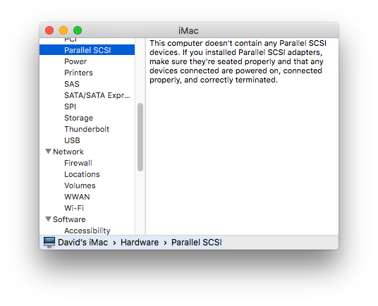

kurbads Posted October 7, 2017 Share Posted October 7, 2017 (edited) Hi, I have both LSI 9211-8i and PERC H310 cards. None of them show up in El Capitan. Do I need to upgrade to Sierra? If read somewhere High Sierra has it's own driver for LSI / Poweredge. Regardless of if I put the kext in SLE or Clover EFI or both. The kext shows as not loaded in System Report. The card shows in during boot and shows number of attached disks. Do I have to create array of disks even for card to show up? I only have one 8TB SAS drive to attach. That's what the second card was bought for. I use the first one to test SSDs before sale on eBay, 8 at a time. Both cards seem to be pretty well supported by your driver. Is it OS version independent? David Edit: I run the sudo kextutil -v /System/Library/Extensions/SASMegaRAID.kext with fellowing results Defaulting to kernel file '/System/Library/Kernels/kernel'Diagnostics for /System/Library/Extensions/SASMegaRAID.kext:Code Signing Failure: not code signed/System/Library/Extensions/SASMegaRAID.kext appears to be loadable (not including linkage for on-disk libraries).kext-dev-mode allowing invalid signature -67062 0xFFFFFFFFFFFEFA0A for kext "/System/Library/Extensions/SASMegaRAID.kext"kext signature failure override allowing invalid signature -67062 0xFFFFFFFFFFFEFA0A for kext "/System/Library/Extensions/SASMegaRAID.kext"Loading /System/Library/Extensions/SASMegaRAID.kext./System/Library/Extensions/SASMegaRAID.kext successfully loaded (or already loaded). After this kext shows as loaded in Profiler extensions but no cards show up anywhere and it shows up as not loaded after restart. Edited October 7, 2017 by kurbads Link to comment https://www.insanelymac.com/forum/topic/285197-driver-for-lsi-megaraid-sas-family/page/15/#findComment-2510644 Share on other sites More sharing options...

kurbads Posted November 13, 2017 Share Posted November 13, 2017 Bought this LSI 9211-8i on eBay. Loaded it with the latest firmware and bios. Created a RAID array on Windows on the same machine. Boot into Mac - nothing, as if there was no sign of it. Edited dukzcry kext 0x73001000 to 0x72001000 no luck. The prefer MSI is already set to 'false'. Is this my destiny? Link to comment https://www.insanelymac.com/forum/topic/285197-driver-for-lsi-megaraid-sas-family/page/15/#findComment-2534221 Share on other sites More sharing options...
