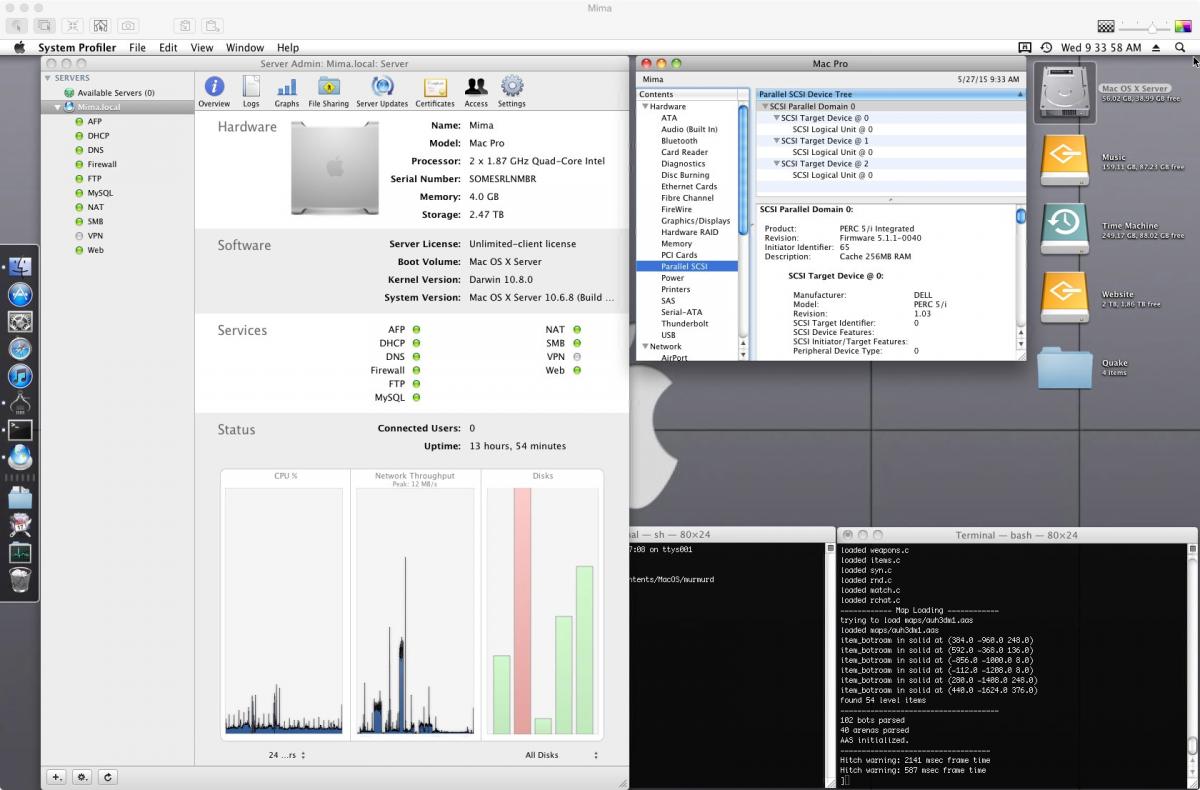

noradninj Posted May 27, 2015 Share Posted May 27, 2015 Attached is a version compiled for Mac OS X 10.6.8 running a 64 bit kernel. Tested on Mac OS X 10.6.8 Server running on a Dell PowerEdge 2900 with a PERC 5/i card. You will need to run sudo defaults write /Library/Preferences/SystemConfiguration/com.apple.Boot ‘Kernel Flags’ ‘arch=x86_64’ in Terminal to force 64-bit kernel loading. Forked Git repository is here https://github.com/noradninja/osx-goodies/tree/Mac-OS-X-10.6.8-x64bitKernel SASMegaRAID.kext.zip 1 Link to comment https://www.insanelymac.com/forum/topic/285197-driver-for-lsi-megaraid-sas-family/page/12/#findComment-2139098 Share on other sites More sharing options...

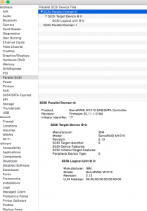

vindu Posted June 24, 2015 Share Posted June 24, 2015 i've got an ibm m1115 which i had crossflashed to a lsi 9211-8i IR previously which i've re-flashed with the m1015 bootrom and the newest firmware from ibm which appears to be 20.11.1-0184currently running 10.10.3installed the release sasmegaraid.kext and have it showing up in the system information which is greatproblem is it doesn't seem to be recognising any disks connected to it though, i know the driver will only present logical disks so the os so i've tried creating single disk raid0 arrays as well as creating a 2 disk raid0 array but they don't seem to show up in the os at all?mfiutil is able to identify the individual disks as well as the volumes but nothing shows up in disk utilityhave tried flipping the prefermsi key as well as the uncontiguous enumeration kext too without any change here's the output from mfiutil sh-3.2# mfiutil show adapter mfi0 Adapter: Product Name: ServeRAID M1015 SAS/SATA Controller Serial Number: SP30205654 Firmware: 20.11.1-0184 RAID Levels: JBOD, RAID0, RAID1, RAID10 Battery Backup: not present NVRAM: 32K Onboard Memory: 0M Minimum Stripe: 8K Maximum Stripe: 64K sh-3.2# mfiutil show drives mfi0 Physical Drives: 1 ( 238G) ONLINE <SanDisk SD7SB3Q2 0000 serial=150603400379> SATA E1:S4 2 ( 238G) ONLINE <SanDisk SD7SB3Q2 0000 serial=143799401997> SATA E1:S7 3 ( 238G) ONLINE <SanDisk SD7SB3Q2 0000 serial=145218403311> SATA E1:S0 4 ( 238G) ONLINE <SanDisk SD7SB3Q2 0000 serial=150284400376> SATA E1:S3 sh-3.2# mfiutil show config mfi0 Configuration: 1 arrays, 1 volumes, 0 spares array 0 of 4 drives: drive 3 ( 238G) ONLINE <SanDisk SD7SB3Q2 0000 serial=145218403311> SATA drive 4 ( 238G) ONLINE <SanDisk SD7SB3Q2 0000 serial=150284400376> SATA drive 1 ( 238G) ONLINE <SanDisk SD7SB3Q2 0000 serial=150603400379> SATA drive 2 ( 238G) ONLINE <SanDisk SD7SB3Q2 0000 serial=143799401997> SATA volume mfid0 (950G) RAID-0 64K OPTIMAL <ssdraid0> spans: array 0 sh-3.2# mfiutil show volumes mfi0 Volumes: Id Size Level Stripe State Cache Name mfid0 ( 950G) RAID-0 64K OPTIMAL Disabled <ssdraid0> any idea guys? update: managed to flash the m1115 with the lsi megaraid 9240-8i firmware which made it pickup as an actual m1115, still no difference in osx sasmegaraid picks it up, shows the disks but just won't passthrough the virtualdisks here's the new output: sh-3.2# mfiutil show adapter mfi0 Adapter: Product Name: ServeRAID M1115 SAS/SATA Controller Serial Number: SP30205654 Firmware: 20.13.1-0208 RAID Levels: JBOD, RAID0, RAID1, RAID10 Battery Backup: not present NVRAM: 32K Onboard Memory: 0M Minimum Stripe: 8K Maximum Stripe: 64K sh-3.2# mfiutil show drives mfi0 Physical Drives: 0 ( 238G) ONLINE <SanDisk SD7SB3Q2 0000 serial=143799401997> SATA E1:S7 1 ( 238G) ONLINE <SanDisk SD7SB3Q2 0000 serial=145218403311> SATA E1:S0 2 ( 238G) ONLINE <SanDisk SD7SB3Q2 0000 serial=150603400379> SATA E1:S4 3 ( 238G) ONLINE <SanDisk SD7SB3Q2 0000 serial=150284400376> SATA E1:S3 sh-3.2# mfiutil show config mfi0 Configuration: 1 arrays, 1 volumes, 0 spares array 0 of 4 drives: drive 1 ( 238G) ONLINE <SanDisk SD7SB3Q2 0000 serial=145218403311> SATA drive 3 ( 238G) ONLINE <SanDisk SD7SB3Q2 0000 serial=150284400376> SATA drive 2 ( 238G) ONLINE <SanDisk SD7SB3Q2 0000 serial=150603400379> SATA drive 0 ( 238G) ONLINE <SanDisk SD7SB3Q2 0000 serial=143799401997> SATA volume mfid0 (950G) RAID-0 64K OPTIMAL <sandisk_4xr0> spans: array 0 sh-3.2# mfiutil show volumes mfi0 Volumes: Id Size Level Stripe State Cache Name mfid0 ( 950G) RAID-0 64K OPTIMAL Disabled <sandisk_4xr0> update2: turns out it's been working all along, just didn't show up in disk utility gui or in terminal. read through the entire thread again and had found a post mentioning needing to format the drive in windows first before showing up in osx so i booted a windows installation, formatted in ntfs then formatted it in hfs+ in osx and all is well Link to comment https://www.insanelymac.com/forum/topic/285197-driver-for-lsi-megaraid-sas-family/page/12/#findComment-2147722 Share on other sites More sharing options...

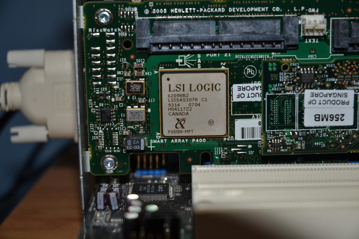

inorfolk Posted January 11, 2016 Share Posted January 11, 2016 Guy's, Im looking for a pointer here. I have been looking to see if there is any way to run a HP P400 Storage Controller (LSI1078) on a Hackentosh, I think the answer is know, but just wanted confirmation. Thanks, ian. Link to comment https://www.insanelymac.com/forum/topic/285197-driver-for-lsi-megaraid-sas-family/page/12/#findComment-2205540 Share on other sites More sharing options...
jfive Posted January 12, 2016 Share Posted January 12, 2016 Guy's, Im looking for a pointer here. I have been looking to see if there is any way to run a HP P400 Storage Controller (LSI1078) on a Hackentosh, I think the answer is know, but just wanted confirmation. Thanks, ian. A google search led me to this site: https://forums.servethehome.com/index.php?threads/lsi-raid-controller-and-hba-complete-listing-plus-oem-models.599/ The "HP" section makes no mention. However, according to the "LSI MegaRAID" section in the first post: SAS1078 LSI Logic MegaRAID SAS 8888ELP RAID Controller LSI Logic MegaRAID SAS 8708ELP RAID Controller LSI Logic MegaRAID SAS 8884E RAID Controller LSI Logic MegaRAID SAS 8708E RAID Controller LSI Logic MegaRAID SATA 350-8ELP RAID Controller LSI Logic MegaRAID SATA 350-4ELP RAID Controller LSI Logic MegaRAID SAS 8704ELP RAID Controller LSI Logic MegaRAID SAS 8708EM2 RAID Controller LSI Logic MegaRAID SAS 8808EM2 RAID Controller LSI Logic MegaRAID SAS 8780EM2 RAID Controller LSI Logic MegaRAID SAS 8880EM2 RAID Controller LSI Logic MegaRAID SAS 8744EM2 RAID Controller LSI Logic MegaRAID SAS 8844EM2 RAID Controller LSI Logic MegaRAID SAS 8744ELP RAID Controller LSI Logic MegaRAID SAS 8844ELP RAID Controller LSI Logic MegaRAID SAS 8008EM2 RAID Controller LSI MegaRAID SAS 8704EM2 RAID Controller Another google search led me here to an archived PDF of the September 2007, MegaRAID 1078-based SAS RAID Controllers User's Guide: http://techpubs.sgi.com/library/manuals/0000/860-0489-001/pdf/860-0489-001.pdf I uploaded and attached the above PDF to this message. I hope you can download it. Page three of the Preface states the following: The MegaRAID 1078-based Serial Attached SCSI (SAS) RAID controller family consists of the following controllers: - MegaRAID SAS 8704ELP PCI Expres Low-Profile Serial-Attached SCSI/SATA II Disk Array Controller with Internal Connectors - MegaRAID SAS 8708ELP PCI Expres Low-Profile Serial-Attached SCSI/SATA II Disk Array Controller with Internal Connectors - MegaRAID SAS 8708EM2 PCI Expre Serial-Attached SCSI/SATA II Disk Array Controller with Internal Connectors - MegaRAID SAS 8880EM2 PCI Expre Serial-Attached SCSI/SATA II Disk Array Controller with External Connectors - MegaRAID SAS 8888ELP PCI Expres Low-Profile Serial-Attached SCSI/SATA II Disk Array Controller with External Connectors and Internal Connectors In Dukzcry's kext README, he lists the following chips to be compatible: LSI MegaRAID SAS 8xxx, 92xx Since the HP P400 and P400i is only about $5 USD on eBay, it won't be much of a loss if it doesn't work. Either way, try it out and take one for the team. Please let us know your results. Plenty of others would love to be able to only pay $5 and have a hardware RAID controller in their Hackintosh system. Lastly, be sure you get an SFF-8484 to SATA breakout cable if you don't already own one. Personally, I didn't have any luck when using a Dell backplane with my PERC H700. Link to comment https://www.insanelymac.com/forum/topic/285197-driver-for-lsi-megaraid-sas-family/page/12/#findComment-2205718 Share on other sites More sharing options...
slipalong Posted January 12, 2016 Share Posted January 12, 2016 Jfive, this is a dump of the lspci from Linux 02:00.0 RAID bus controller: Hewlett-Packard Company Smart Array Controller (rev 03) Subsystem: Hewlett-Packard Company P400 SAS Controller Control: I/O+ Mem+ BusMaster+ SpecCycle- MemWINV- VGASnoop- ParErr- Stepping- SERR- FastB2B- DisINTx+ Status: Cap+ 66MHz- UDF- FastB2B- ParErr- DEVSEL=fast >TAbort- <TAbort- <MAbort- >SERR- <PERR- INTx- Latency: 0, Cache Line Size: 64 bytes Interrupt: pin A routed to IRQ 16 Region 0: Memory at e3100000 (64-bit, non-prefetchable) Region 2: I/O ports at d000 Region 3: Memory at e3240000 (64-bit, non-prefetchable) Expansion ROM at e3200000 [disabled] Capabilities: <access denied> Kernel modules: cciss, hpsa And atached is a pic of the card. I cant seem to see any reference numbers which tie in with your info above. You will notice that the chip has Fusion MPT so you would think there was a way to get the AppleFusionMPT.kext tweeked, but I cant see any way unser iokitpersonality to add this PCI vendor and device. Cheers, Ian. Link to comment https://www.insanelymac.com/forum/topic/285197-driver-for-lsi-megaraid-sas-family/page/12/#findComment-2205757 Share on other sites More sharing options...
jfive Posted January 12, 2016 Share Posted January 12, 2016 You will notice that the chip has Fusion MPT so you would think there was a way to get the AppleFusionMPT.kext tweeked, but I cant see any way unser iokitpersonality to add this PCI vendor and device. Cheers, Ian. Sorry man, you mentioned an LSI SAS1078. Had no idea it is a Fusion MPT chip. Hopefully in the future that controller will get some love. As far as I know, the Fusion MPT is not nor will it be supported by this kext. I'm not a programmer so I can give no guidance to regarding the how, when or why. There are plenty of PERC 5i cards on eBay for $10 USD. Link to comment https://www.insanelymac.com/forum/topic/285197-driver-for-lsi-megaraid-sas-family/page/12/#findComment-2205964 Share on other sites More sharing options...
inorfolk Posted January 14, 2016 Share Posted January 14, 2016 Five, yes the whole Fusion MPT is supposed to make the driver very simple as most of the work is done by the ARM processor on the card, But I just can't get it working with AppleLSIFusionMPT or SASMegaRAID. I do have some Dell card, but the machine wouldn't boot when I plugged it in :-( Do I need LSI firmware flashing? Thanks, ian. Link to comment https://www.insanelymac.com/forum/topic/285197-driver-for-lsi-megaraid-sas-family/page/12/#findComment-2206604 Share on other sites More sharing options...
