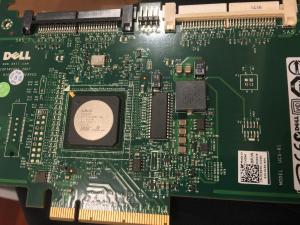

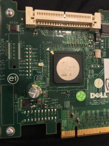

jfive Posted January 19, 2016 Share Posted January 19, 2016 Just looked at a PERC 5i and 6i that are in my drawer. They BOTH have LSI SAS1068 ARM and FUSION-MPT etched/stamped on the controller chip. And we all know that these are compatible thanks to Dukzcry's kext. Did you black out the SMBus pins on the Dell PERC card as recommend by the Overclocker's forum? Have you attempted flashing to LSI firmware or by using LSI's MegaCLI utility? Link to comment https://www.insanelymac.com/forum/topic/285197-driver-for-lsi-megaraid-sas-family/page/13/#findComment-2208246 Share on other sites More sharing options...
