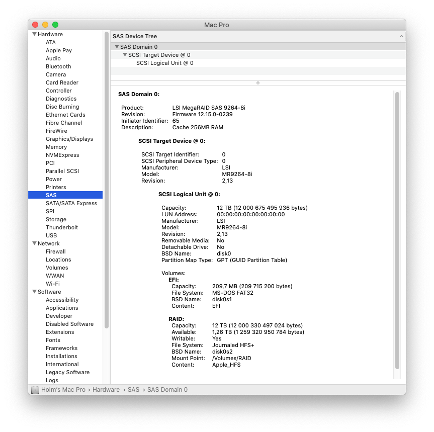

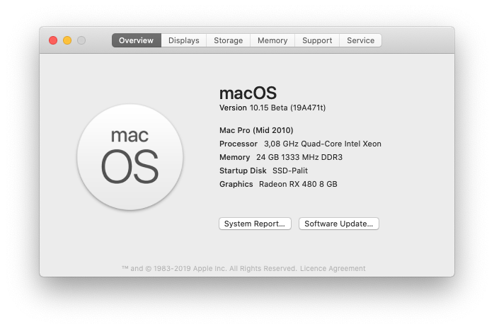

Ur-Quan Posted March 21, 2019 Share Posted March 21, 2019 (edited) On 3/4/2019 at 1:17 AM, Rikoshet said: Privet! Are you using OP driver? I'm using driver from this topic. https://github.com/dukzcry/osx-goodies/releases On 3/4/2019 at 1:17 AM, Rikoshet said: Also, I see all those cards are quite expensive, is there something under $200? Thanks! My LSI MegaRAID 9264-8i (with two SFF 8087 —> 4×SAS cables) costs about $70 Edited March 21, 2019 by Ur-Quan 1 Link to comment https://www.insanelymac.com/forum/topic/285197-driver-for-lsi-megaraid-sas-family/page/16/#findComment-2667592 Share on other sites More sharing options...

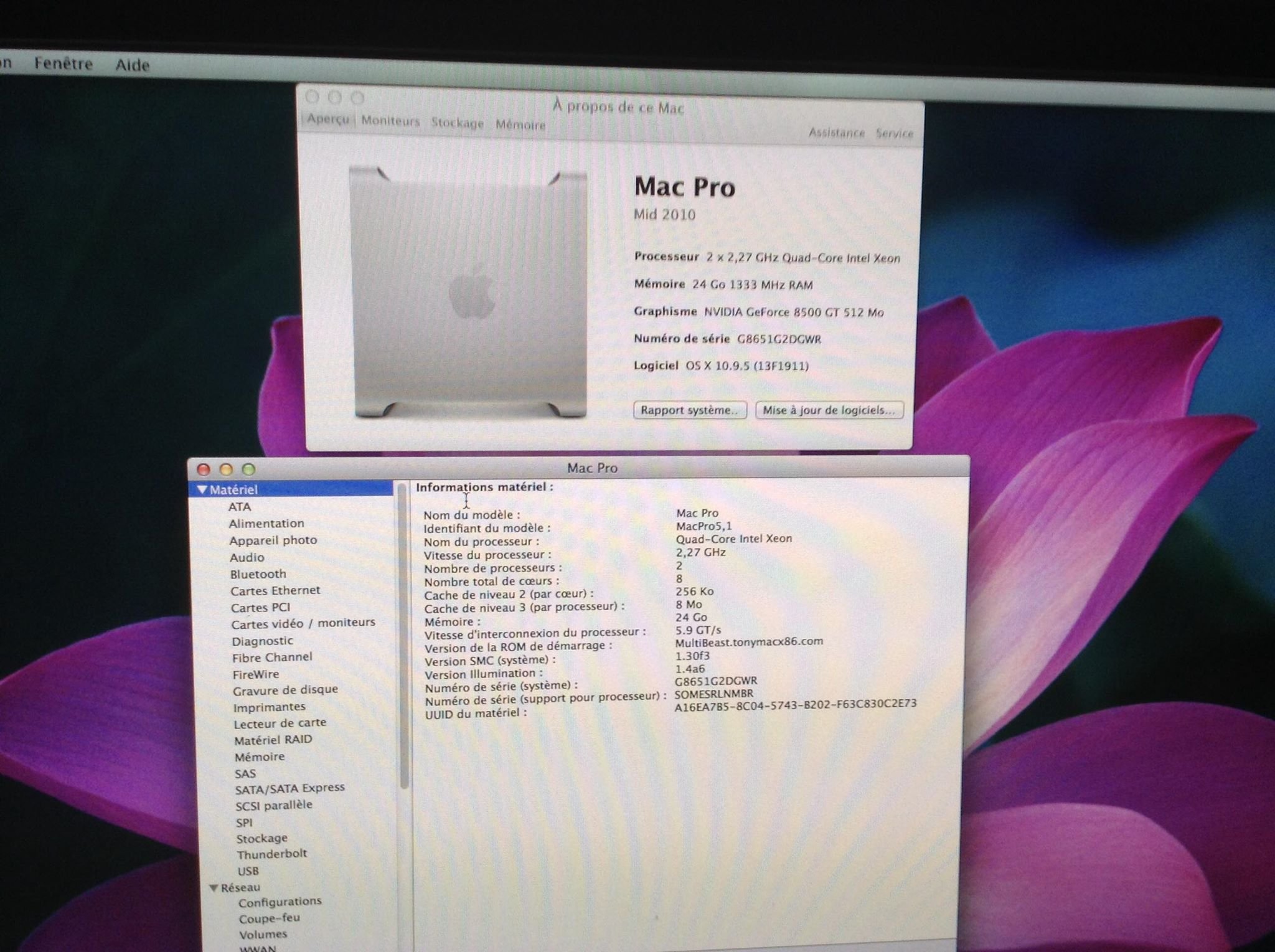

jfdemiddeleer Posted April 5, 2019 Share Posted April 5, 2019 Hello, Sorry for my bad English I have a Dell PERC S300 RAID adapter, who not work with SSD drives as Dell descrived in her infos (2x 240Gb drives see as 127Gb ). It was equipped with a LSI SAS1068E Rev. B3 chip. I want to use it with my Hackintosh (Asus P7P55D LE and Core i5-750 with OS-X Sierra 10.12.6) in RAID mode (RAID 0) for A/V editing with DaVinci Resolve (in a first time with 2x2Tb WD Black RE10, later with 4 SSD drive) I think I should flash the BIOS and Firmware for that (I try all drivers I have found without result). The S300 seems close to LSI SAS3081E-R adapter (1068E, 2x4 internal ports SAS/SATA, PCI-Ex8...) but I don't know if 3081E-R is compatible with the Mac's driver. If not, I can also use Linux (Ubuntu?) instead OS-X 10.12.6 Sierra Can you help me? Soon, I will receive an Asus PIKE2008 adapter for an Z8NA-D6 motherboard (Dual Xeon LGA1366), with a SAS2008 chipset. I don't know if this adapter have a generic BIOS or a specific one, and if it work in Mac OS-X with the driver... https://www.asus.com/be-fr/Commercial-Servers-Workstations/Z8NAD6/overview/ https://www.asus.com/us/Commercial-Servers-Workstations/PIKE_2008/ This computer run also OS-X 10.12.6 Sierra (or 10.9.5 Mavericks) as a MacPro 5,1 definition (it will receive a pair of 3,06GHz 6 Core Xeon soon, and I will change the graphic card for a GTX 760/2Gb) Thanks for any help you can provide Link to comment https://www.insanelymac.com/forum/topic/285197-driver-for-lsi-megaraid-sas-family/page/16/#findComment-2669159 Share on other sites More sharing options...

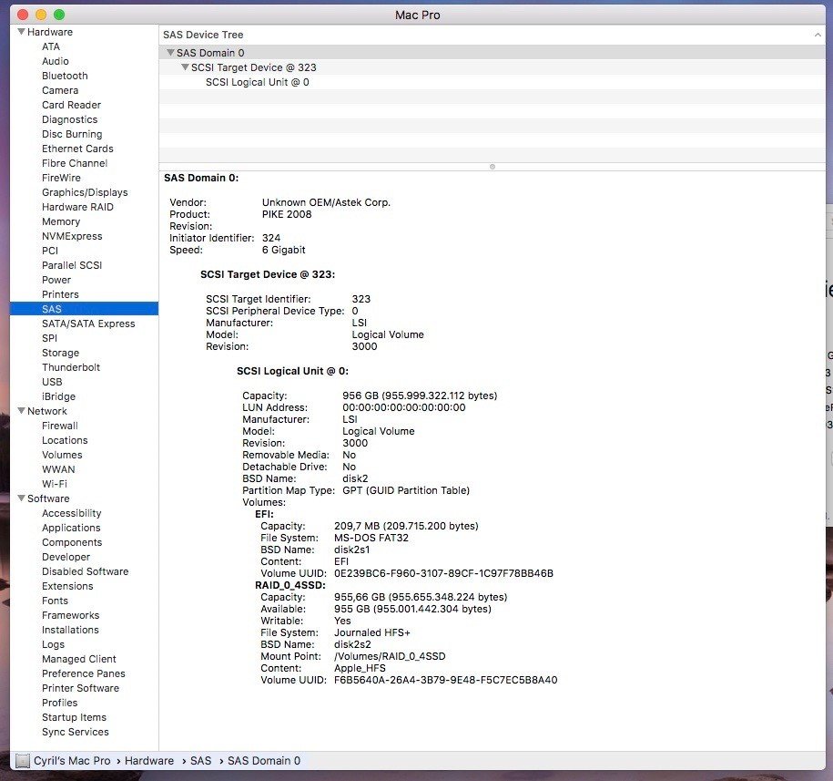

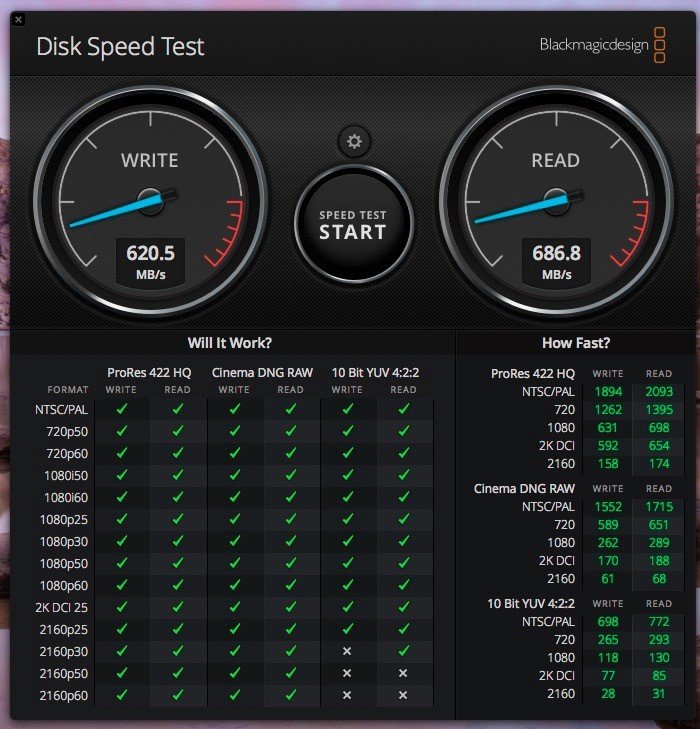

jfdemiddeleer Posted April 5, 2019 Share Posted April 5, 2019 I have received the PIKE SAS 2008 card this afternoon. With the despeinao's driver, it work! Many thanks to him! I am a bit disapointed about the performances of a 4x SSD RAID 0, just a bit more fast than a 2x SSD RAID 0 (about 650Mb/s instead of 500Mb/s) Interface limitation? Link to comment https://www.insanelymac.com/forum/topic/285197-driver-for-lsi-megaraid-sas-family/page/16/#findComment-2669224 Share on other sites More sharing options...
Ur-Quan Posted May 16, 2019 Share Posted May 16, 2019 (edited) On 4/5/2019 at 9:19 PM, jfdemiddeleer said: I have received the PIKE SAS 2008 card this afternoon AFAIK, PIKE SAS 2008 is NOT real RAID-controller, so 6 Gigabits is the verdict Edited May 16, 2019 by Ur-Quan Link to comment https://www.insanelymac.com/forum/topic/285197-driver-for-lsi-megaraid-sas-family/page/16/#findComment-2673933 Share on other sites More sharing options...

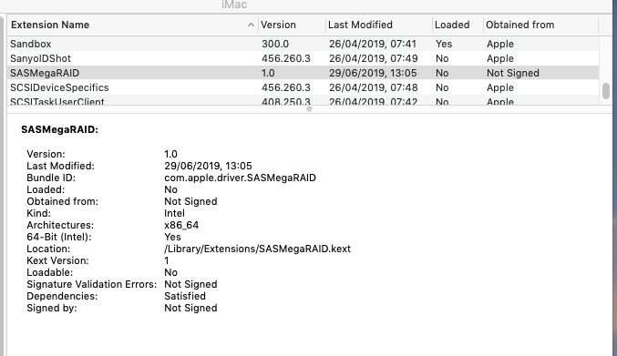

ToxicQuill Posted June 29, 2019 Share Posted June 29, 2019 Hey, I'm trying to install this kext but it is not loading on MacOS Mojave, any ideas? (Attached is system information info) Link to comment https://www.insanelymac.com/forum/topic/285197-driver-for-lsi-megaraid-sas-family/page/16/#findComment-2679621 Share on other sites More sharing options...
Ur-Quan Posted July 13, 2019 Share Posted July 13, 2019 (edited) On 6/29/2019 at 3:35 PM, ToxicQuill said: Hey, I'm trying to install this kext but it is not loading on MacOS Mojave, any ideas? You can: sudo spctl --master-disable delete CsrActiveConfig key from RtVariables section of Clover config move sasmegaraid.kext to /EFI/CLOVER/kexts/Other Edited July 13, 2019 by Ur-Quan Link to comment https://www.insanelymac.com/forum/topic/285197-driver-for-lsi-megaraid-sas-family/page/16/#findComment-2681325 Share on other sites More sharing options...

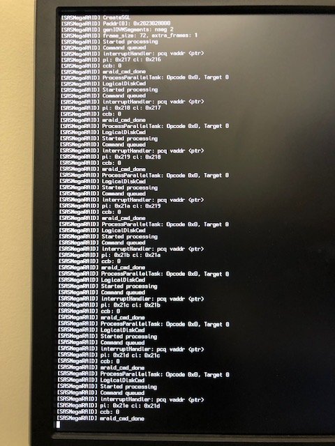

kizune Posted July 29, 2019 Share Posted July 29, 2019 (edited) Trying this drivers with my LSI 9261-8i, booted from the Mojave installation USB with Clover, system saw the RAID volume so i installed Mojave to it, now i'm trying to boot from it (first with the Clover USB) and system is full of scrolling text that says something like this: [SASMegaRaid] ProcessParallelTask: Opcode 0x28, Target 0 [SASMegaRaid] IOCmd: trlen: 8192, lba: 637240, blkcnt: 16 [SASMegaRaid] CreateSGL [SASMegaRaid] Paddr[0]: 0x197578000 [SASMegaRaid] genIOVMSegments: nseg 2 [SASMegaRaid] frame_size: 72, extra_frames: 1 [SASMegaRaid] Started Processing [SASMegaRaid] Command queued [SASMegaRaid] interruptHandler: pcq vaddr <ptr> [SASMegaRaid] pi: 0x1c7 ci: 0x1c6 [SASMegaRaid] ccb: 1 [SASMegaRaid] mraid_cmd_done As long as i can tell this block got repeats indefinitely (at least i waited for 30 minutes there were no stop of it). System does not boot beyond this point. Any idea of what is happening? Update: Tried to boot from the installation USB again. Same behavior - looks like if file system is present on this drive and system tries to mount it it just goes into indefinite loop of the operations and it never stops. Edited July 29, 2019 by kizune Link to comment https://www.insanelymac.com/forum/topic/285197-driver-for-lsi-megaraid-sas-family/page/16/#findComment-2683242 Share on other sites More sharing options...
