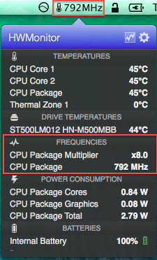

Allan Posted January 1, 2014 Share Posted January 1, 2014 i try with and without GenericUSBXHCI, and i have the same problem about speed step and turbo, look: very very sloooowww!! Link to comment https://www.insanelymac.com/forum/topic/285157-patched-appleusbxhci-from-os-1082/page/5/#findComment-1980663 Share on other sites More sharing options...
maleorderbride Posted January 1, 2014 Share Posted January 1, 2014 i try with and without GenericUSBXHCI, and i have the same problem about speed step and turbo, look: Screen Shot 2013-12-31 at 22.49.36.png very very sloooowww!! Are you injecting CPU plugin-type 1 in an SSDT or your DSDT? That can cause a stuck multiplier of x8.0. 1 Link to comment https://www.insanelymac.com/forum/topic/285157-patched-appleusbxhci-from-os-1082/page/5/#findComment-1980812 Share on other sites More sharing options...

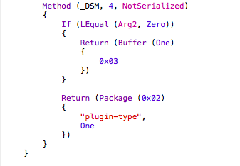

Allan Posted January 2, 2014 Share Posted January 2, 2014 Are you injecting CPU plugin-type 1 in an SSDT or your DSDT? That can cause a stuck multiplier of x8.0. I have CPU-plugin type 1 in SSDT. but do not know if I have the DSDT. please see my DSDT DSDT.aml.zip so I have to delete plugin type 1? Link to comment https://www.insanelymac.com/forum/topic/285157-patched-appleusbxhci-from-os-1082/page/5/#findComment-1981113 Share on other sites More sharing options...
Allan Posted January 2, 2014 Share Posted January 2, 2014 don't work man!! i try without "plugin-type" but my clock still hangs at 700 MHz. Link to comment https://www.insanelymac.com/forum/topic/285157-patched-appleusbxhci-from-os-1082/page/5/#findComment-1981172 Share on other sites More sharing options...
Allan Posted January 9, 2014 Share Posted January 9, 2014 finally managed to make it work states and turbo, and USB 3. what I did: deleted "plugin-type 1" in an SSDT. and put DropOem> False in config.plist I will create a tutorial of my fight! thanks @maleorderbride Link to comment https://www.insanelymac.com/forum/topic/285157-patched-appleusbxhci-from-os-1082/page/5/#findComment-1983583 Share on other sites More sharing options...
