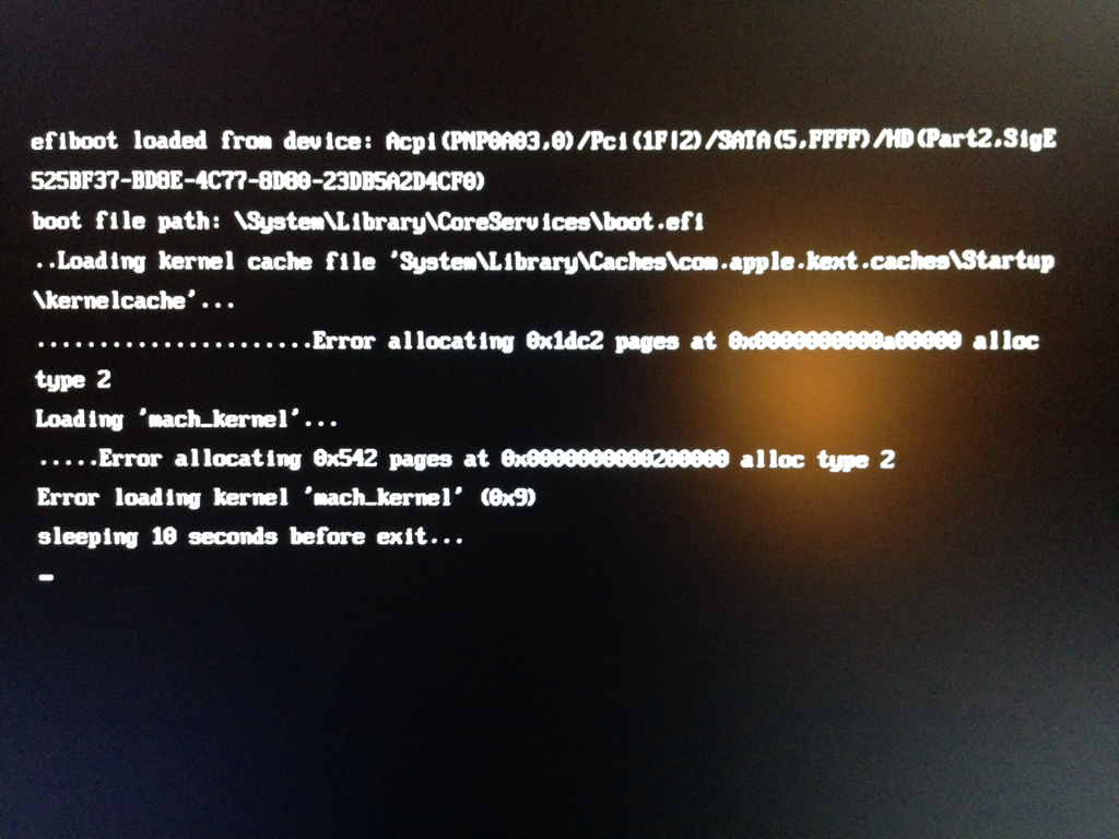

alfa147x Posted October 1, 2013 Share Posted October 1, 2013 I keep getting this error. Any ideas? Build: GIGABYTE GA-Z77X-UP5 TH LGA 1155 Intel Z77 Thunderbolt Motherboard Intel Core i7-3770K Ivy Bridge 3.5GHz (3.9GHz Turbo) HD 4000 Graphics Asus GTX670 Top (GTX670-DC2T-2GD5) CORSAIR Vengeance LP 16GB (2 x 8GB) DDR3-1600 120 GB OWC Mercury Electra 3G SSD MacSales Link to comment https://www.insanelymac.com/forum/topic/284656-clover-general-discussion/page/98/#findComment-1949884 Share on other sites More sharing options...
Slice Posted October 1, 2013 Share Posted October 1, 2013 I keep getting this error. Any ideas? Build: GIGABYTE GA-Z77X-UP5 TH LGA 1155 Intel Z77 Thunderbolt Motherboard Intel Core i7-3770K Ivy Bridge 3.5GHz (3.9GHz Turbo) HD 4000 Graphics Asus GTX670 Top (GTX670-DC2T-2GD5) CORSAIR Vengeance LP 16GB (2 x 8GB) DDR3-1600 120 GB OWC Mercury Electra 3G SSD MacSales You have to use OsxAptioFixDrv.efi and not OsxLowMemFix.efi 1 Link to comment https://www.insanelymac.com/forum/topic/284656-clover-general-discussion/page/98/#findComment-1949892 Share on other sites More sharing options...

alfa147x Posted October 1, 2013 Share Posted October 1, 2013 You have to use OsxAptioFixDrv.efi and not OsxLowMemFix.efi Ah thanks. I'll give that a shot. I was using a guide and it said just to use the defaults in the installer. With Chameleon I've always run a DSDT free installation. From my little research I should be fine doing that here as well... Right? Link to comment https://www.insanelymac.com/forum/topic/284656-clover-general-discussion/page/98/#findComment-1949976 Share on other sites More sharing options...
Slice Posted October 1, 2013 Share Posted October 1, 2013 Ah thanks. I'll give that a shot. I was using a guide and it said just to use the defaults in the installer. With Chameleon I've always run a DSDT free installation. From my little research I should be fine doing that here as well... Right? It seems the defaults in the installer is not good. I didn't use Chameleon since end of 2011 so I don't know what is mean "run a DSDT free installation". Link to comment https://www.insanelymac.com/forum/topic/284656-clover-general-discussion/page/98/#findComment-1949983 Share on other sites More sharing options...

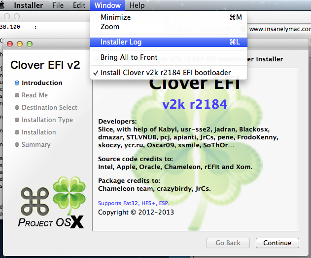

shpokas Posted October 4, 2013 Share Posted October 4, 2013 I am trying to install Clover as UEFI and it always fails. Don't bother about Volume name, it fails elsewhere, on USB stick or SATA drive, too. I have this line in install log: Oct 4 19:33:34 mackrap.local Installer[1770]: install:didFailWithError:Error Domain=PKInstallErrorDomain Code=112 "An error occurred while running scripts from the package “Clover_v2k_r2184.pkg”." UserInfo=0x7f83a11873a0 {NSFilePath=./preinstall, NSURL=file://localhost/Volumes/DATA/Downloads/Clover_v2k_r2184/Clover_v2k_r2184.pkg#EFIFolder.pkg, PKInstallPackageIdentifier=org.clover.efifolder, NSLocalizedDescription=An error occurred while running scripts from the package “Clover_v2k_r2184.pkg”.} How can I trace down this? Could not find the ./preinstall script, tried with Pacifist.app Link to comment https://www.insanelymac.com/forum/topic/284656-clover-general-discussion/page/98/#findComment-1950745 Share on other sites More sharing options...

Slice Posted October 4, 2013 Share Posted October 4, 2013 I am trying to install Clover as UEFI and it always fails. Don't bother about Volume name, it fails elsewhere, on USB stick or SATA drive, too. I have this line in install log: Oct 4 19:33:34 mackrap.local Installer[1770]: install:didFailWithError:Error Domain=PKInstallErrorDomain Code=112 "An error occurred while running scripts from the package “Clover_v2k_r2184.pkg”." UserInfo=0x7f83a11873a0 {NSFilePath=./preinstall, NSURL=file://localhost/Volumes/DATA/Downloads/Clover_v2k_r2184/Clover_v2k_r2184.pkg#EFIFolder.pkg, PKInstallPackageIdentifier=org.clover.efifolder, NSLocalizedDescription=An error occurred while running scripts from the package “Clover_v2k_r2184.pkg”.} How can I trace down this? Could not find the ./preinstall script, tried with Pacifist.app DId you use this log? And check what is the format of your /Volume/EFI, and how many space on it. I can't get HDMI audio on GTX660. In rev 1995 it was simple. Now I can't do this. I set: ACPI DropTables Signature DMAR Signature SSDT TableId CpuPm Signature SSDT TableId Cpu0Ist PatchAPIC SSDT DoubleFirstState DropOem Generate CStates PStates MinMultiplier 7 PluginType 1 Boot Arguments -gux_defer_usb2 -gux_no_idle Fast Log Timeout 2 CPU QPI 5000 Devices Audio Inject 12 NoDefaultProperties AddProperties Device NVidia Key hda-gfx Value onboard-2 Device HDMI Key hda-gfx Value onboard-2 Device NVidia Key @0,connector-type Value AAgAAA== Device NVidia Key @1,connector-type Value AAgAAA== Device NVidia Key @2,connector-type Value AAgAAA== Device NVidia Key @3,connector-type Value AAgAAA== DisableDrivers Firewire PartitionDxe OsxLowMemFixDrv CsmVideoDxe DataHubDxe GUI Theme bootcamp TextOnly CustomIcons Language pl:30788 Mouse Enabled Scan Entries Legacy Tool Custom Entries Path \EFI\BOOT\BOOTX64.efi VolumeType External Internal Hidden Disabled Type OSXInstaller Hidden Disabled Path \EFI\BOOT\BOOTX64.efi Title CD/DVD FullTitle CD/DVD VolumeType Optical Hidden Disabled Path \EFI\Microsoft\Boot\bootmgfw.efi Title Windows FullTitle Windows Hidden Disabled Graphics Inject ATI Intel NVidia PatchVBios KernelAndKextPatches AppleRTC AsusAICPUPM Debug KernelCpu KernelLapic KextsToPatch Name IOAHCIBlockStorage Find QVBQTEUgU1NEAA== Replace AAAAAAAAAAAAAA== SMBIOS ProductName iMac13,2 SystemParameters InjectKexts But still no HDMI audio. I checked SSDT but doesn't work - no HDMI audio. Did you see the post and prehistory? #2471 Link to comment https://www.insanelymac.com/forum/topic/284656-clover-general-discussion/page/98/#findComment-1950752 Share on other sites More sharing options...
