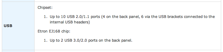

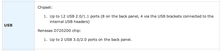

My mb has the same hardware component to P67A-UD3-B3's. According to Gigabyte's website, the only difference is on USB2.0 and "Dolby Home Theater".
The differences between P67A-D3-B3 and P67A-UD3-B3 is only the USB3.0 chip...
D3-B3..
UD3-B3...
By the way, does the USB 3.0 work now with Clover?
PS. I notice that your mb has different USB3.0 controller with the P67A-UD3-B3 one.

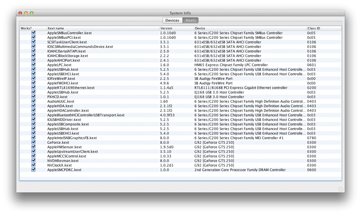

I can't tell you if is really working because I don't have any USB3.0 device to test...
But theoretically yes... The kext is being loaded and the device recognised...

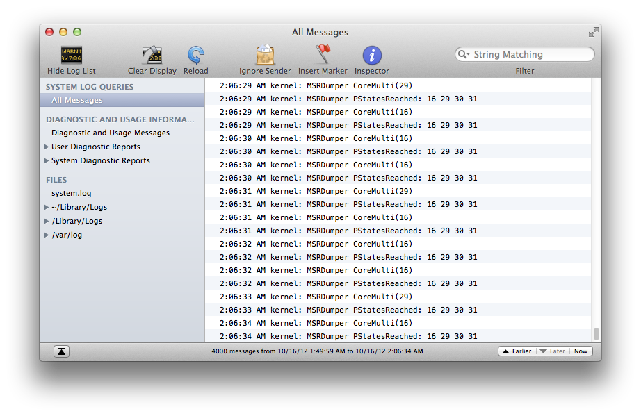

I'm almost finishing some tests with my new tables extracted from Linux...
Until now, i got 4 states (16 - 28 - 29 - 31), but still not good, I need more C-States...
I'm at the job now, but when I came back home I'll try with your SMBIOS and SSDT...
@shiecldk
This is the best result that I've got...
Doesn't matter if with your or mine SSDT and MacPro/iMac SMBIOS...
Always Minimum (1600), Regular (2800) and Turbo (3000/3100)...
If a disable turbo or remove SSDT and enable Generate C/P-States only 1600 and 2800...
Nothing different than this...
:wallbash:
If I overclock to 2900mhz for example, I got 1600, 2900, 3000 and 3100... (as you can see at the picture)
If I set max turbo to 3300 (with different SSDT), 1600, 2800, 2900, 3000, 3100, 3200 and 3300...

Also did a msr dump. This is normal for my i7-3930K @ 4.2ghz right?
16-10-12 10:43:25,000 kernel[0]: CoreCount: 6
16-10-12 10:43:25,000 kernel[0]: ThreadCount: 12
16-10-12 10:43:25,000 kernel[0]: 0xE2: 0x1e008400
16-10-12 10:43:29,870 com.apple.SecurityServer[19]: Session 100002 created
16-10-12 10:43:30,000 kernel[0]: MSRDumper CoreMulti(42)
16-10-12 10:43:30,000 kernel[0]: MSRDumper PStatesReached: 42
16-10-12 10:43:30,000 kernel[0]: MSRDumper CoreMulti(12)
16-10-12 10:43:30,000 kernel[0]: MSRDumper PStatesReached: 12 42
16-10-12 10:43:31,000 kernel[0]: MSRDumper CoreMulti(42)
16-10-12 10:43:31,000 kernel[0]: MSRDumper PStatesReached: 12 42
16-10-12 10:43:32,000 kernel[0]: MSRDumper CoreMulti(12)
16-10-12 10:43:32,000 kernel[0]: MSRDumper PStatesReached: 12 42
16-10-12 10:43:33,000 kernel[0]: MSRDumper CoreMulti(12)
16-10-12 10:43:33,000 kernel[0]: MSRDumper PStatesReached: 12 42
:wallbash:
Resuming, my speedstep is based on turbo???
How are your states??? you can get better results than this???
:help:
This is my SSDT...
http://pastebin.com/EiXSKnVF
