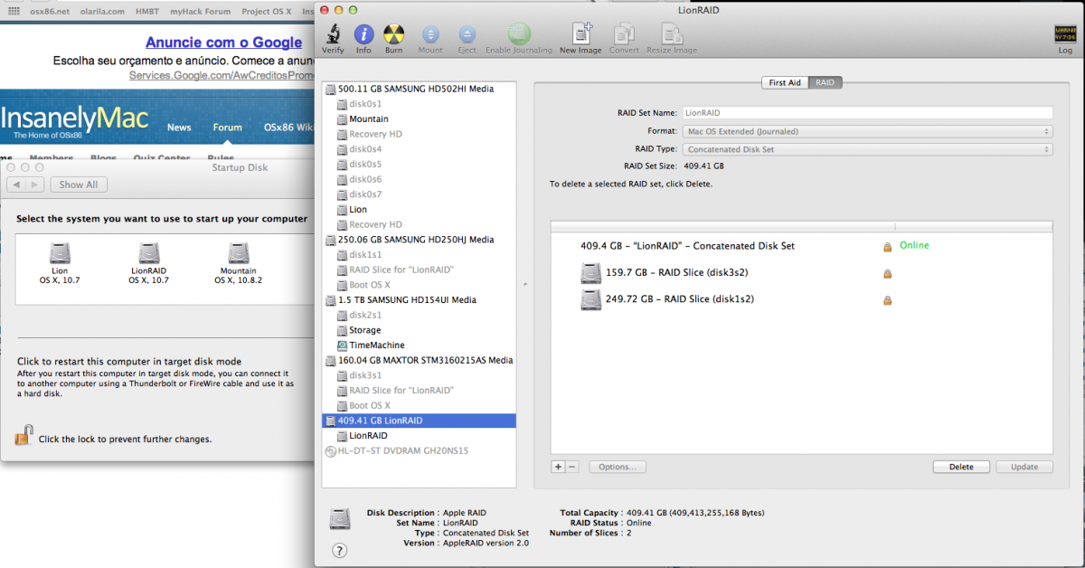

Taruga Posted November 4, 2012 Share Posted November 4, 2012 For those interested, here is a video of the boot process with debug enabled to see what´s going on during this 3 minutes delay http://www.youtube.com/watch?v=lXHMvxmH-XM I think I have too many hard disks Link to comment https://www.insanelymac.com/forum/topic/284656-clover-general-discussion/page/12/#findComment-1865083 Share on other sites More sharing options...

Taruga Posted November 4, 2012 Share Posted November 4, 2012 Hi magnifico, dmazar is helping me, seems that the delay is because of hard discs and the way they are recognized, maybe I have too much of them. I will try to boot with only one of them to check if the 3 minute delay remains or not. Link to comment https://www.insanelymac.com/forum/topic/284656-clover-general-discussion/page/12/#findComment-1865089 Share on other sites More sharing options...
kyndder Posted November 4, 2012 Share Posted November 4, 2012 For those interested, here is a video of the boot process with debug enabled to see what´s going on during this 3 minutes delay I think I have too many hard disks Yes... This may be a good explanation... I believe that you already make a test by leaving only one disk and confirm this theory right??? @shiecldk How are the things with your MOBO??? Yesterday I had to re-flash the UEFI BIOS because my MOBO became to life and restored the old BIOS by itself... Beside this weird thing, everything is fine... Link to comment https://www.insanelymac.com/forum/topic/284656-clover-general-discussion/page/12/#findComment-1865090 Share on other sites More sharing options...
magnifico Posted November 4, 2012 Share Posted November 4, 2012 Hi magnifico, dmazar is helping me, seems that the delay is because of hard discs and the way they are recognized, maybe I have too much of them. I will try to boot with only one of them to check if the 3 minute delay remains or not. Ok...dmazar is my teacher ...but I have written to you before removing all the hd from your mainboard Link to comment https://www.insanelymac.com/forum/topic/284656-clover-general-discussion/page/12/#findComment-1865091 Share on other sites More sharing options...
Taruga Posted November 4, 2012 Share Posted November 4, 2012 yeah, thanks. But I have to do that other day. If it works, fine... I will know the reason of the delay. But it will be no solution for me to disconnect HDD's just to boot from clover Link to comment https://www.insanelymac.com/forum/topic/284656-clover-general-discussion/page/12/#findComment-1865097 Share on other sites More sharing options...

dmazar Posted November 5, 2012 Share Posted November 5, 2012 yeah, thanks. But I have to do that other day. If it works, fine... I will know the reason of the delay. But it will be no solution for me to disconnect HDD's just to boot from clover It seems to me that delay is caused with very slow access to certain disks which your UEFI see as ATA disks and not SATA. Maybe disks that are connected to non-intell controller (marvell?). Anyway, unless you find a way how to resolve this, UEFI Clover will not be a solution for you. What I would try: - boot with those disks disconnected just to see if this is really the show stopper - try to find some option in BIOS to make them visible as SATA drives in UEFI - or to try with some TianoCore drivers to see if they will replace bad ones from your UEFI (@Slice: SataController, AtaAtapiPassthrough, AtaBus?) Link to comment https://www.insanelymac.com/forum/topic/284656-clover-general-discussion/page/12/#findComment-1865150 Share on other sites More sharing options...
Slice Posted November 5, 2012 Share Posted November 5, 2012 It seems to me that delay is caused with very slow access to certain disks which your UEFI see as ATA disks and not SATA. Maybe disks that are connected to non-intell controller (marvell?). Anyway, unless you find a way how to resolve this, UEFI Clover will not be a solution for you. What I would try: - boot with those disks disconnected just to see if this is really the show stopper - try to find some option in BIOS to make them visible as SATA drives in UEFI - or to try with some TianoCore drivers to see if they will replace bad ones from your UEFI (@Slice: SataController, AtaAtapiPassthrough, AtaBus?) Yes, but I don't know if the replacement will occur. UEFI has a driver like AHCI.efi. How to switch it off? Link to comment https://www.insanelymac.com/forum/topic/284656-clover-general-discussion/page/12/#findComment-1865151 Share on other sites More sharing options...
