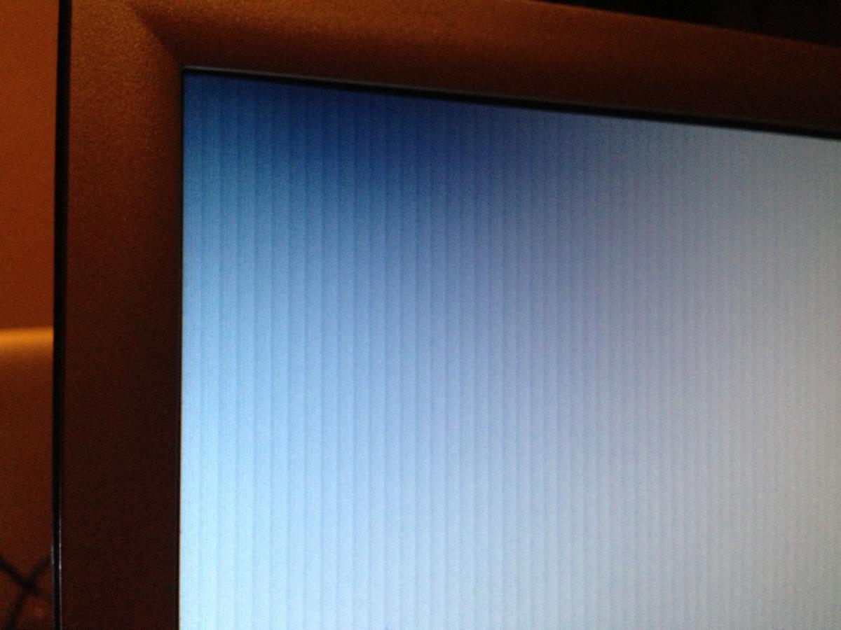

Fab1Man Posted May 19, 2013 Share Posted May 19, 2013 I'm trying to get my config working. I have a 7970, the framebuffer is perfect, so no actual need for the ATIConnectorsPatch (I only have to switch two connections because HDMI comes first in the bios list, I also did this, same result). Every time I log in, the screen is just gone and it turns into grey vertical stripes. It's driving mad, whenever I delete the GI, I only use the sleep trick and it works fine, but I want it fixed. Is anyone familiar with these stripes? EDIT: Now with a photo. Link to comment https://www.insanelymac.com/forum/topic/284656-clover-general-discussion/page/64/#findComment-1916335 Share on other sites More sharing options...

Fab1Man Posted May 20, 2013 Share Posted May 20, 2013 I'm trying to get my config working. I have a 7970, the framebuffer is perfect, so no actual need for the ATIConnectorsPatch (I only have to switch two connections because HDMI comes first in the bios list, I also did this, same result). Every time I log in, the screen is just gone and it turns into grey vertical stripes. It's driving mad, whenever I delete the GI, I only use the sleep trick and it works fine, but I want it fixed. Is anyone familiar with these stripes? EDIT: Now with a photo. I reflashed my 7970 GPU with the AMD 7970 GHz edition, which has been edited through HexEdit to include a hybrid EFI, which was taken from a MSI reference hybrid EFI. This way my 7970 is compatible with UEFI. I finally got the system working because of FakeSMC.kext. This comes in a couple of variations, including the GPUSensor.kext. This doesn't work with the 7970, so it KP's the system. I got a clean version, so system works. The gray stripes remained, but only with GI in combination with Aji as framebuffer. Without GI, no correct injection. The trick for my board is to turn ON CSM... It works, it doesn't buffer the card so it "overflows". I don't know why it works, but if anyone can tell me "okay, if that works for you that's even better or good" I'd be happy. Every guide tells me to turn it OFF, so it feels wrong. And yes, it boots in UEFI mode, because the GPU doesn't need the sleep/wake trick. I installed OS X through Clover in UEFI mode: it created a recovery HD. The Install.ESD was fully UNTOUCHED. So I have a very vanilla installation . Link to comment https://www.insanelymac.com/forum/topic/284656-clover-general-discussion/page/64/#findComment-1916612 Share on other sites More sharing options...
