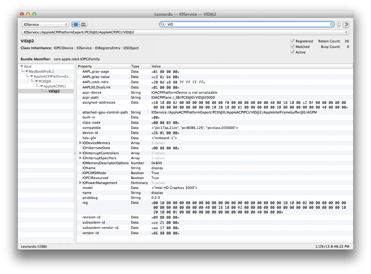

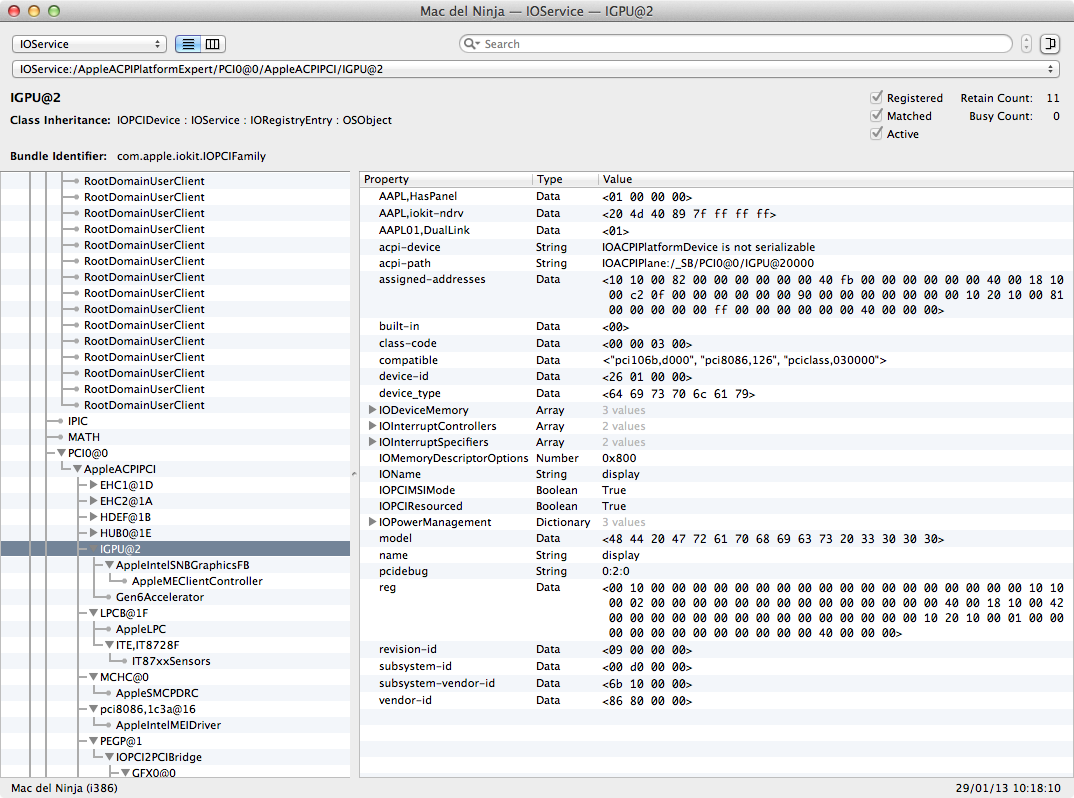

You may check with IORegistryExplorer:
EDIT: By the way, I don't inject the key so yours may differ from mine.
Thank You DamnedCat ... forgot about the obvious way :)
And now I see the problem:
Clover should inject <01 00 00 00> (the whole value of DualLink) not just <01>

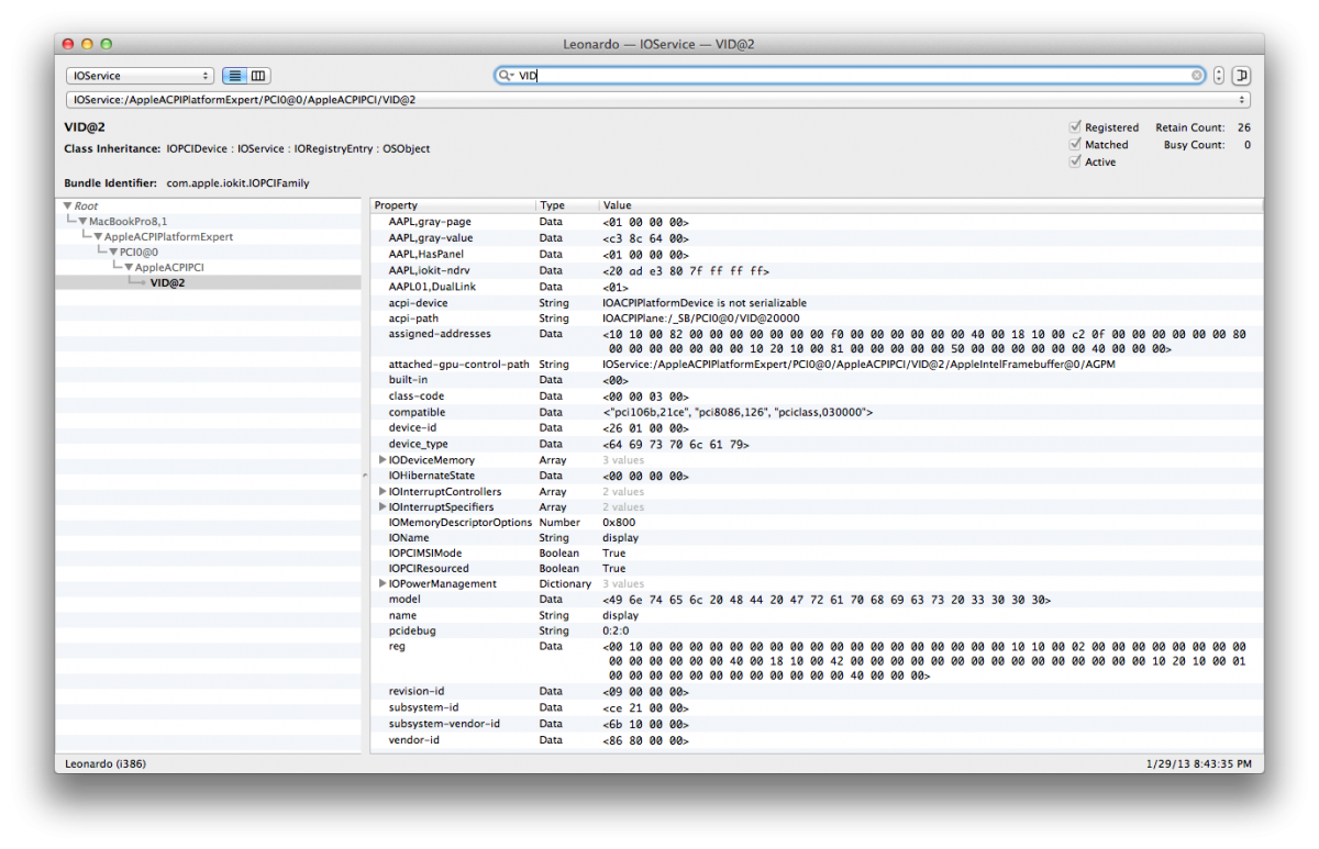

I don't believe that makes a difference but it could be. What I did noticed is that the properties are different:
Clover: AAPL01,DualLink
DSDT: AAPL00,DualLink
Perhaps DualLink = 0 may give you the result you're looking for. (don't really know if it's a yes/no variable or the string you want to inject)
EDIT: nope, that simply injects the string you give it.
Edited by DamnedCat
DamnedCat You are right. The problem is not the <01 00 00 00> vs <01> it is the AAPL01,DualLink.
I have checked it by editing my DSDT to try different scenarios and both <01 00 00 00> and <01> work in AAPL00,DualLink. It is the AAPL01,DualLink that renders the black screen.
Slice: Is there a way to choose "AAPL00,DualLink" in Clover?

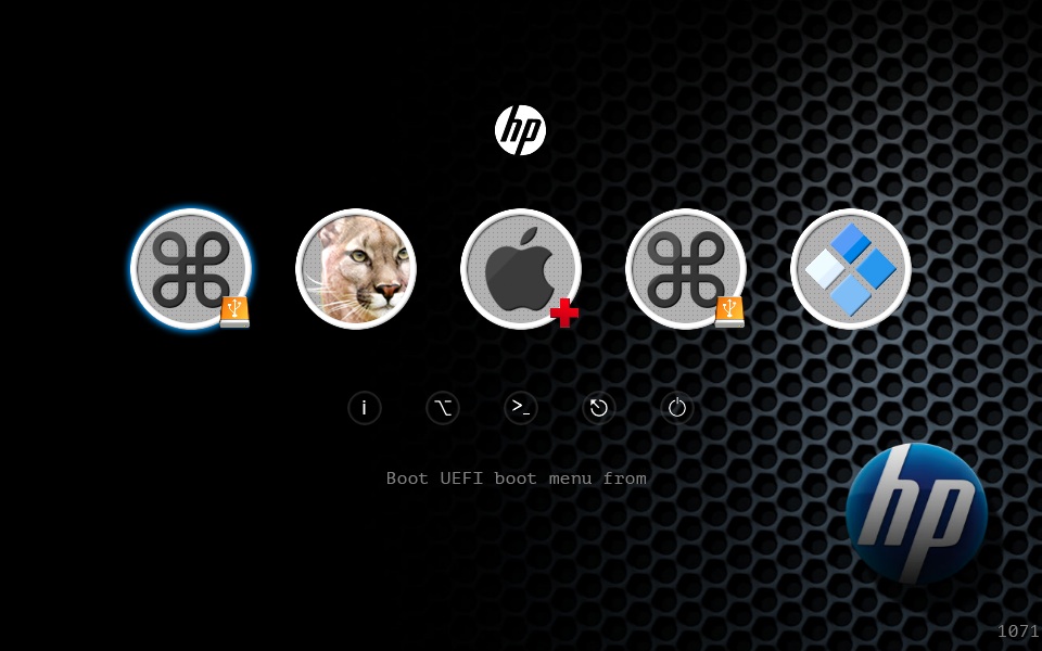

I have interesting log in HP EliteBook 8540p with Clover.
I'd like to know how could I fix LegacyRegion as followings.
4:442 0:000 VideoBiosPatchInit(LegacyRegion = Not Found, LegacyRegion2 = Success) = Success

Followings is whole log.
http://pastebin.com/6uYh7VyJ
Slice already fixed that in rev 1069, just use DualLink=1 in config.plist and it should work now.
Great ! I have just tested it on rev 1071 and I can confirm that it's working now.
Thank you Slice and DamnedCat
