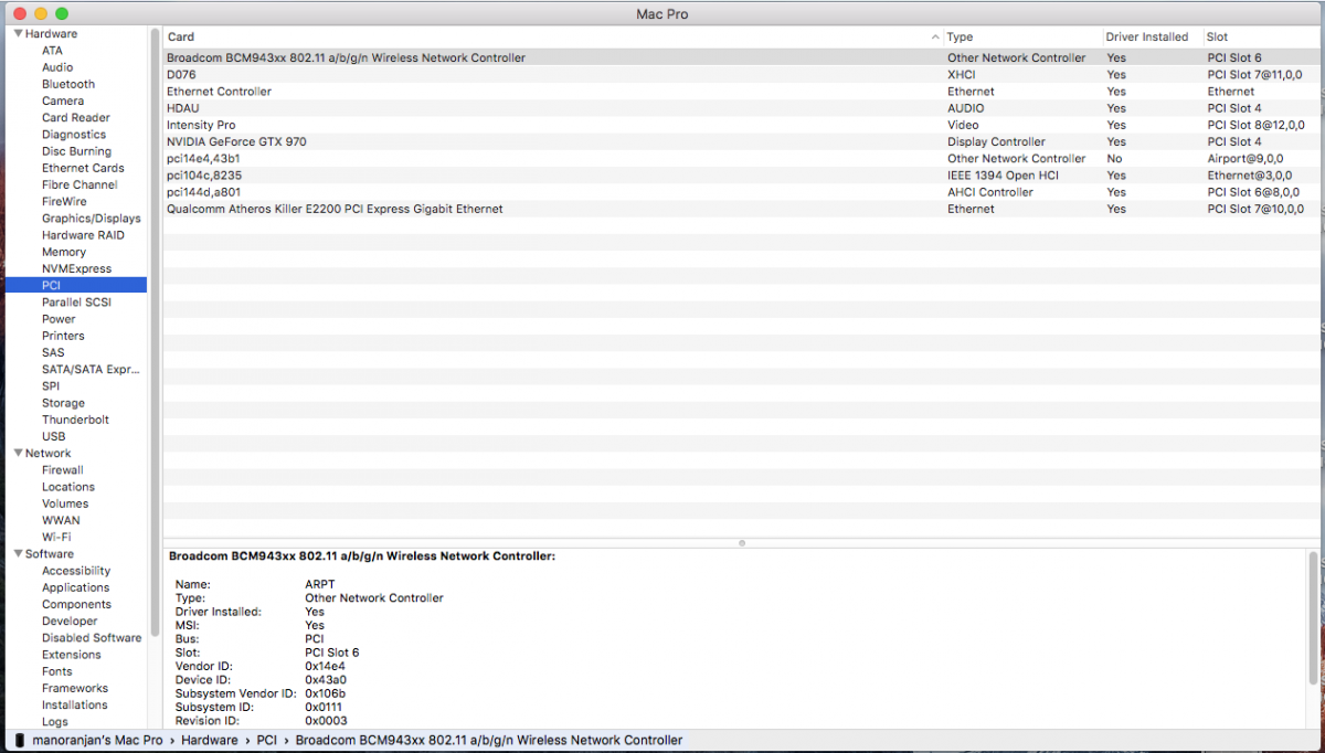

nmano Posted May 18, 2016 Share Posted May 18, 2016 Red color is allowed only for moderators. I didn't understand your post about UUID, DTGP and _DSM. If it is some other manual then read it and follow it. Ask the author why you have a problem. I give you a link on my instructions and I see you don't follow them. When done upload DarwinDumper report with your results to discuss what is working and what no. Hi I don't know about colour code so sorry. I upload my files DarwinDumper report http://www.mediafire.com/download/4hd7fbj391tphof/005_2016-05-17_22-21-52_MacPro6%2C1.zip Link to comment https://www.insanelymac.com/forum/topic/284656-clover-general-discussion/page/397/#findComment-2238821 Share on other sites More sharing options...
Slice Posted May 18, 2016 Share Posted May 18, 2016 Sorry for my ignorance but what is "RefCLK" under Graphics? It was attempt to boost graphics. Seems not affects. Hi I don't know about colour code so sorry. I upload my files DarwinDumper report http://www.mediafire.com/download/4hd7fbj391tphof/005_2016-05-17_22-21-52_MacPro6%2C1.zip The report excluding BIOS and compressed as LZMA occupy 100kb and can be attached to post. OK, I took it and look now. 1 Link to comment https://www.insanelymac.com/forum/topic/284656-clover-general-discussion/page/397/#findComment-2238841 Share on other sites More sharing options...
Slice Posted May 18, 2016 Share Posted May 18, 2016 Hi I don't know about colour code so sorry. I upload my files DarwinDumper report http://www.mediafire.com/download/4hd7fbj391tphof/005_2016-05-17_22-21-52_MacPro6%2C1.zip Test with this DSDT DSDT.aml.zip Link to comment https://www.insanelymac.com/forum/topic/284656-clover-general-discussion/page/397/#findComment-2238844 Share on other sites More sharing options...
nmano Posted May 18, 2016 Share Posted May 18, 2016 Test with this DSDT DSDT.aml.zip Yes I test your DSDT its work this. pci104c,8235: Type: IEEE 1394 Open HCI Driver Installed: Yes MSI: No Bus: PCI Slot: Ethernet@3,0,0 Vendor ID: 0x104c Device ID: 0x8235 Subsystem Vendor ID: 0x14db Subsystem ID: 0x0000 Revision ID: 0x0001 DarwinDumper_2.9.9.1_AMI_X64_3438_Cap_manoranjan.zip Link to comment https://www.insanelymac.com/forum/topic/284656-clover-general-discussion/page/397/#findComment-2238868 Share on other sites More sharing options...
Slice Posted May 18, 2016 Share Posted May 18, 2016 Yes I test your DSDT its work this. pci104c,8235: Type: IEEE 1394 Open HCI Driver Installed: Yes MSI: No Bus: PCI Slot: Ethernet@3,0,0 Vendor ID: 0x104c Device ID: 0x8235 Subsystem Vendor ID: 0x14db Subsystem ID: 0x0000 Revision ID: 0x0001 To make more devices you have to add Name (_SUN, 0x6) then 7,8,9, 0xA, 0xB... for each interesting Device() and then add Slot information into you config.plist Smbios section where you already have device=Nvidia ID=0 not corresponding _SUN property of the device. Read instructions again. Link to comment https://www.insanelymac.com/forum/topic/284656-clover-general-discussion/page/397/#findComment-2238881 Share on other sites More sharing options...
nmano Posted May 18, 2016 Share Posted May 18, 2016 To make more devices you have to add Name (_SUN, 0x6) then 7,8,9, 0xA, 0xB... for each interesting Device() and then add Slot information into you config.plist Smbios section where you already have device=Nvidia ID=0 not corresponding _SUN property of the device. Read instructions again. what about Built IN Device HDEF ID? Name (_SUN, 0x6) Link to comment https://www.insanelymac.com/forum/topic/284656-clover-general-discussion/page/397/#findComment-2238893 Share on other sites More sharing options...

nmano Posted May 18, 2016 Share Posted May 18, 2016 what about Built IN Device HDEF ID? Name (_SUN, 0x6) thanks Slice Its worked now. Thank you for your hard work. Its worked auto with sun ID. I update my DSDT all slot worked but HDEF Slot not show. DSDT.aml.zip Link to comment https://www.insanelymac.com/forum/topic/284656-clover-general-discussion/page/397/#findComment-2238903 Share on other sites More sharing options...

Slice Posted May 18, 2016 Share Posted May 18, 2016 thanks Slice Its worked now. Thank you for your hard work. Its worked auto with sun ID. I update my DSDT all slot worked but HDEF Slot not show. Looks like HDEF and HDMI have another rules to shown or not here. Link to comment https://www.insanelymac.com/forum/topic/284656-clover-general-discussion/page/397/#findComment-2238953 Share on other sites More sharing options...

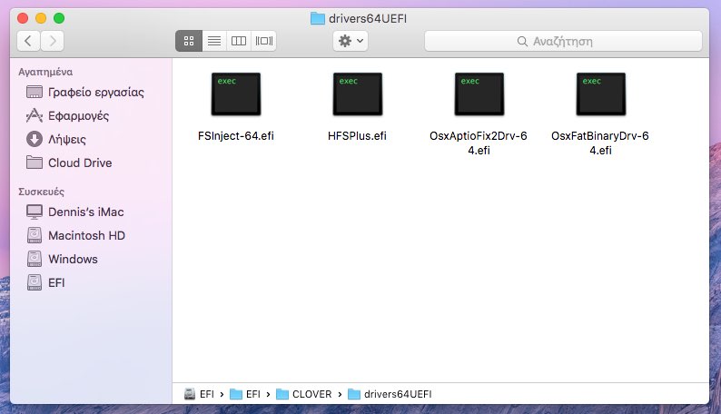

Denicio Posted May 18, 2016 Share Posted May 18, 2016 HFSPlus.efi is now included in the default Clover installation. How come, isn't it proprietary? Link to comment https://www.insanelymac.com/forum/topic/284656-clover-general-discussion/page/397/#findComment-2239005 Share on other sites More sharing options...
Micky1979 Posted May 18, 2016 Share Posted May 18, 2016 Because Is not . (virtual box && grub only) Link to comment https://www.insanelymac.com/forum/topic/284656-clover-general-discussion/page/397/#findComment-2239006 Share on other sites More sharing options...
Denicio Posted May 18, 2016 Share Posted May 18, 2016 Because Is not . (virtual box && grub only) Just did a clean install on the EFI partition with Clover r3526. Look at the default "drivers64UEFI" folder after the installation. Link to comment https://www.insanelymac.com/forum/topic/284656-clover-general-discussion/page/397/#findComment-2239015 Share on other sites More sharing options...
Micky1979 Posted May 18, 2016 Share Posted May 18, 2016 you are right! <choice id="HFSPlus.UEFI" title="HFSPlus.UEFI_title" description="HFSPlus.UEFI_description" start_visible="false" start_selected="true"> <pkg-ref id="org.clover.drivers64uefi.mandatory.hfsplus.uefi"/> </choice> invisible and selected. , I think is unwanted Link to comment https://www.insanelymac.com/forum/topic/284656-clover-general-discussion/page/397/#findComment-2239022 Share on other sites More sharing options...
