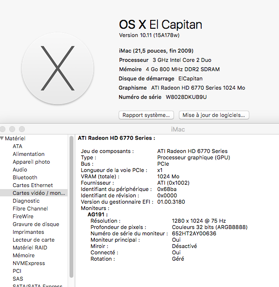

hi all   ^_^
@Slice
sorry if I'm still bothering you with my problem with the new "patch on the fly" method but I did some tests with previous Clover versions and as I expected... the old method still works fine in ElCapitan DB1.   :)
fantomas1s-iMac:~ fantomas1$ kextstat | grep AMD
   54    2 0xffffff7f81f26000 0x125000   0x125000   com.apple.kext.AMDSupport (1.3.6) C96B4426-D45A-3988-8F77-D0599ABD7351
   55    0 0xffffff7f8208e000 0x5f0000   0x5f0000   com.apple.kext.AMD5000Controller (1.3.6) 243E5473-2D4E-364F-9039-1A31DF22125E
   94    0 0xffffff7f8288b000 0x45c000   0x45c000   com.apple.AMDRadeonX3000 (1.3.6) DBC4A87F-55D9-30A0-929F-A3F2D86DC6AD
   97    0 0xffffff7f82059000 0x22000    0x22000    com.apple.kext.AMDFramebuffer (1.3.6) 460D6D27-72F8-3EFE-8879-23EF4CAE4F55
fantomas1s-iMac:~ fantomas1$ ioreg | grep ATY
    | |   |   | +-o ATY,Hoolock@0
    | |   |   | | +-o ATY_Hoolock
    | |   |   | +-o ATY,Hoolock@1
    | |   |   | +-o ATY,Hoolock@2

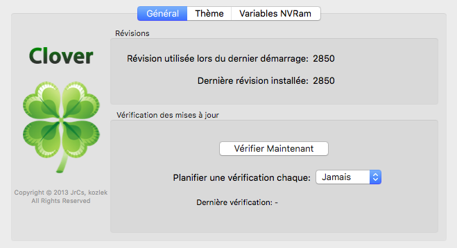

I even was able to install ElCapitan DB1 with Clover r2850 and boot well on it.   :)
 boot.log.zip config.plist.zip

hi all   ^_^
@Slice
   54    2 0xffffff7f81f26000 0x125000   0x125000   com.apple.kext.AMDSupport (1.3.6) C96B4426-D45A-3988-8F77-D0599ABD7351 <53 52 12 11 7 5 4 3 1>
   55    0 0xffffff7f8208e000 0x5f0000   0x5f0000   com.apple.kext.AMD5000Controller (1.3.6) 243E5473-2D4E-364F-9039-1A31DF22125E <54 52 12 11 5 4 3 1>
   94    0 0xffffff7f8288b000 0x45c000   0x45c000   com.apple.AMDRadeonX3000 (1.3.6) DBC4A87F-55D9-30A0-929F-A3F2D86DC6AD <93 52 12 7 5 4 3 1>
   97    0 0xffffff7f82059000 0x22000    0x22000    com.apple.kext.AMDFramebuffer (1.3.6) 460D6D27-72F8-3EFE-8879-23EF4CAE4F55 <54 52 12 11 7 5 4 3 1>
    | |   |   | +-o ATY,Hoolock@0  <class AtiFbStub, id 0x10000028b, registered, matched, active, busy 0 (6 ms), retain 8>
    | |   |   | | +-o ATY_Hoolock  <class AMDFramebuffer, id 0x10000028e, registered, matched, active, busy 0 (5 ms), retain 19>
    | |   |   | +-o ATY,Hoolock@1  <class AtiFbStub, id 0x10000028c, registered, matched, active, busy 0 (0 ms), retain 8>
    | |   |   | | +-o ATY_Hoolock  <class AMDFramebuffer, id 0x100000296, registered, matched, active, busy 0 (0 ms), retain 15>
    | |   |   | +-o ATY,Hoolock@2  <class AtiFbStub, id 0x10000028d, registered, matched, active, busy 0 (0 ms), retain 8>
    | |   |   | | +-o ATY_Hoolock  <class AMDFramebuffer, id 0x10000029c, registered, matched, active, busy 0 (0 ms), retain 15>
 attachicon.gifboot.log.zip attachicon.gifconfig.plist.zip
but to have success with it, the most effective trick for now is to inject the details of my kexts (AMD5000Controller.kext and AMDRadeonX3000.kext) inside the FakeSMC Info.plist as additional IOKitPersonalities. With this trick, my kexts are always loaded.

The same here, with clover 3113 no issues, with 3259 no plist patching.
But something happens there, it works by replacing the 3113 file and do a restart, no cache rebuilding is needed.
Kext injecting with 3259 is working now, on DP6  :thumbsup_anim:
I'm glad to hear that
please, can yo tell what file you replaced? I didn't have success with r3259 and info.plist patching  :(
I don't know why you say that older Clover can patch info.plist and recent no.
Rev 3127 - skip invisible symbols because we can't write in search pattern , and .
Rev 3141 - prevent search out of bounds.
Rev 3254, 3256 - corrections by solstice who tested and made it fully working for him.
Be sure that Find and Replace must be in ...
@ Slice
I don't know if you're talking to me but yes, with clover r2850 I had success with DP1... with r3259 didn't' have
with r2850 Find et Replace has been in ... and with r3259 I changed it in ... but it didn't work
my kexts are never patched from com.apple... but only from org.netkas... when I use FakeSMC trick even if I boot twice (the first time with  NoCaches and the second with Caches).
@ Slice
What was replaced?

with r3259
KextsToPatch
Find
MHg2OEI4MTAwMg==
InfoPlistPatch
Name
AMD5000Controller
Replace
MHg2OEJBMTAwMg==
Find
MHg2OEI4MTAwMg==
InfoPlistPatch
Name
AMDRadeonX3000
Replace
MHg2OEJBMTAwMg==
with r2850
KextsToPatch
Find
0x68B81002
InfoPlistPatch
Name
AMD5000Controller
Replace
0x68BA1002
Find
0x68B81002
InfoPlistPatch
Name
AMDRadeonX3000
Replace
0x68BA1002
