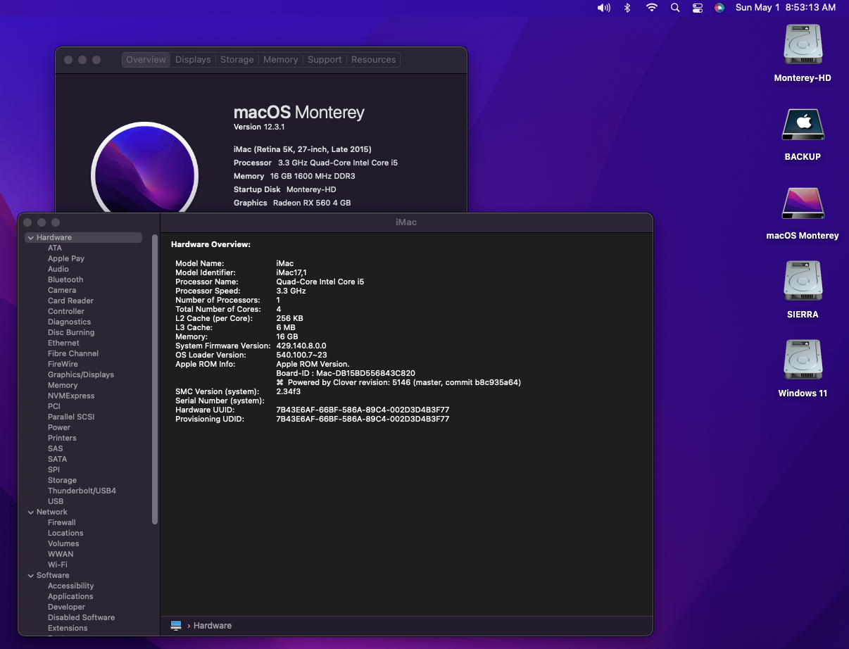

Hi,
r5146 (master, commit b8c935a64) Xcode8 build OK on Asus IvyBridge Big Sur 11.6.5 (20G527) and Xcode Version 13.2.1 (13C100).
Hackintool log

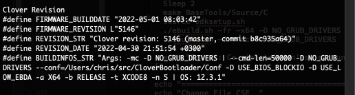

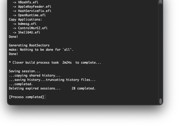

@Slice  I am in Monterey 12.3.1  with Xcode 13.2.1 and OpenCore is embed
its  fletching from the command
it work but I need to modified the file OcAcpiLib.c like your commits because some how Github not fletching your last commit ??

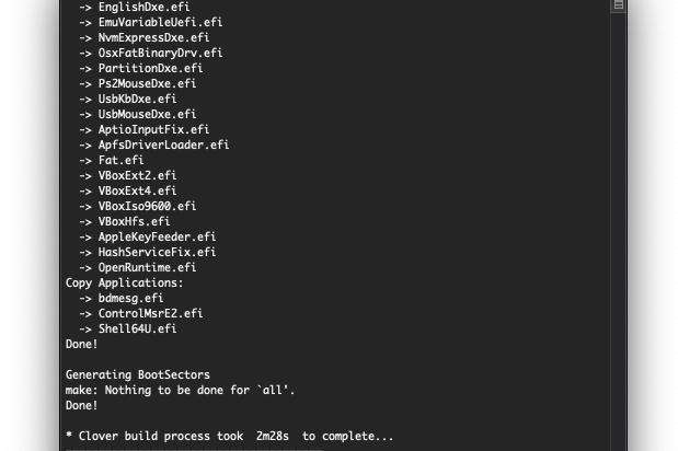

45 minutes ago, Slice said:
Check
git branch
It should reply "master"
I will test other thing later but now
I find the good solution for always have your commit at  https://github.com/CloverHackyColor/OpenCorePkg
Before build
rm -rf ~/src/CloverBootloader/OpenCorePkg
cd ~/src/CloverBootloader
git clone https://github.com/CloverHackyColor/OpenCorePkg.git
and now I build with Xcode 👍 😄 This is a complete build form scratch
Edited by chris1111

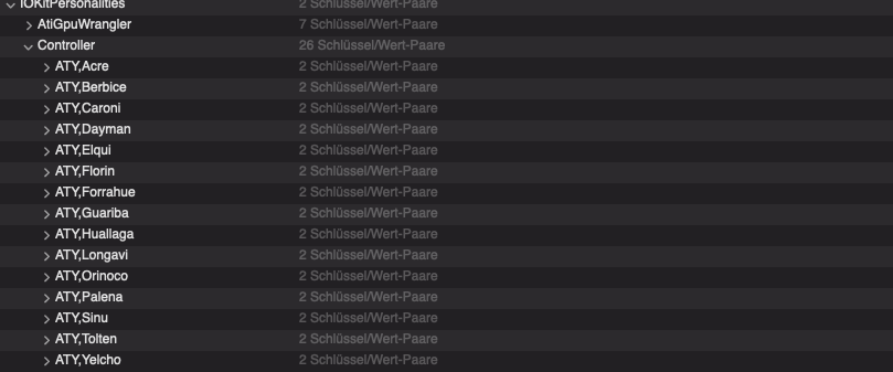

Guest 5T33Z0
32 minutes ago, Hervé said:
Same way it's always been: you check the card's PCI id and then you look in the AMD frambuffer's Info.plist to collect the FB's personalities name it defines.
Okay, thanks. I clicked on the magnifying glass in Hackintool for the GPU which took me to AMD9500Controller.kext.
The info.plist contains more than a dozen Framebuffers:
645065304_Bildschirmfoto2022-05-01um14_35_08.png.21a798b8ebed9ead0cce995de46a51b3.png
How do I find out which is the right one?

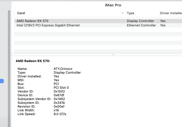

Once in the past we had an utility to dump all connectors in all framebuffer to see if chosen framebuffer has connectors like your card.
But now I have no such dumps.
For my RX570 with DVI, HDMI, DP,DP I chosen Orinoco and it is fine for me: DVI monitor+HDMI TV.

** BUILD FAILED **
The following build commands failed:
	CompileC /Users/mathieu/src/Cloverbootloader/Xcode/CloverConfigPlistValidator/build/CloverConfigPlistValidator.build/Release/CloverConfigPlistValidator.build/Objects-normal/x86_64/Config_GUI.o /Users/mathieu/src/Cloverbootloader/rEFIt_UEFI/Settings/ConfigPlist/Config_GUI.cpp normal x86_64 c++ com.apple.compilers.llvm.clang.1_0.compiler
(1 failure)
I mistaken somewhere ? Before all work fine.
EDIT
Same issue with Buildme script: can't build CloverConfigPlistValidator.
CCPV OutPut
Edited by Matgen84
