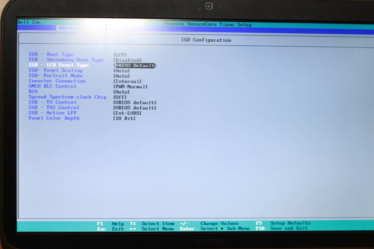

ThibaultAnd Posted May 6, 2013 Share Posted May 6, 2013 Here are the pics of the interesting part in the unlocked/modded bios. 1 Link to comment https://www.insanelymac.com/forum/topic/281476-dell-inspiron-17r-notebook-inspiron-7720-can-run-mac-os-x/page/7/#findComment-1913256 Share on other sites More sharing options...

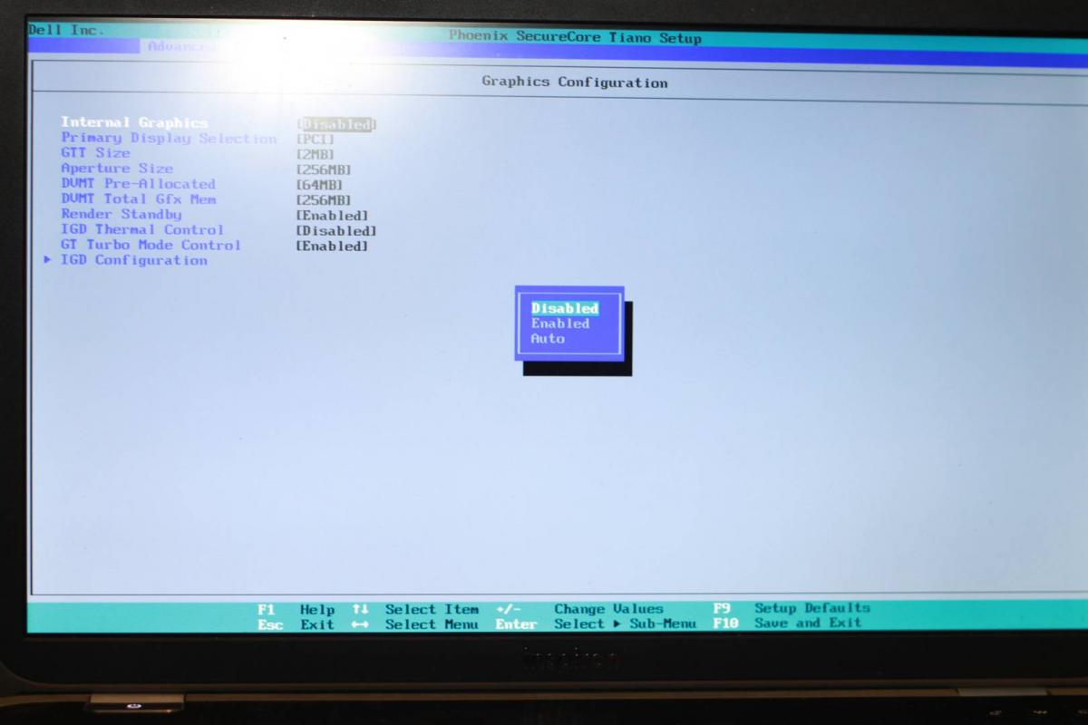

WaldMeister Posted May 13, 2013 Share Posted May 13, 2013 .... Hi kvonline, The problem is not enabling the Nvidia card. It is not possible for us to disable the integrated Intel graphics, which makes the 2 cards conflict if both are loaded, since OS X does not support this (correct me if i'm wrong). If we could somehow disable the Intel graphics, in theory it should be possible to use the Nvidia card. Disabling the Intel graphics by DSDT is not possible for as far as i know, and the option is not provided in the 7720 bios, so a bios modification like above could do the trick. Until now, i have tried different settings, but the Intel is still enabled when i boot either OS X or Windows, and the Nvidia stays secondary (or disabled by DSDT, depends on which OS i boot) Link to comment https://www.insanelymac.com/forum/topic/281476-dell-inspiron-17r-notebook-inspiron-7720-can-run-mac-os-x/page/7/#findComment-1914882 Share on other sites More sharing options...

idpsystem2 Posted May 16, 2013 Share Posted May 16, 2013 Congratulations! So happy to see that so much tasks has been accomplished. Lejenk, I've followed your guide but still has problem disabling the 650m. I think my 3D-variant of 7720 work differently when handling graphics. I've noted they are always active in my previous trials few month ago. Can you disable the 650m with Clover tricks? Or should I seek for a mod-BIOS? Could you share your experience when disabling 650m in DSDT so that I can edit my own one too? Thank you very much! Link to comment https://www.insanelymac.com/forum/topic/281476-dell-inspiron-17r-notebook-inspiron-7720-can-run-mac-os-x/page/7/#findComment-1915442 Share on other sites More sharing options...
WaldMeister Posted May 16, 2013 Share Posted May 16, 2013 Hi idpsystem2, It is possible to disable the card by DSDT edits, have not found a way to do this by Clover config, and as i posted above, the modded bios did not resolve any issue for as far as i have noticed. You could extract your own DSDT from Windows or Linux, and also the extra SSDT's, some of them contain the graphic card information. All you have to to is find the right information, add it to the DSDT, and add a new method called PINI. This method will be called when loading the DSDT, and disable the nVidia card, if all goes well. It's just my theory, i do not know if the 3D models work the same, but i think so. Here is a topic i created when i could not figure it out: http://www.insanelymac.com/forum/topic/286354-disable-nvidia-gpu-dell-7720/ First post refers to the research topic at projectosx: http://www.projectosx.com/forum/index.php?showtopic=2315 And here the problem is solved: http://www.insanelymac.com/forum/topic/286196-asus-a56cm-k56cm-tutorial-ml-1082/page__st__180#entry1890485 If you need help with this, you can always send me the files, or leave them attached here. 1 Link to comment https://www.insanelymac.com/forum/topic/281476-dell-inspiron-17r-notebook-inspiron-7720-can-run-mac-os-x/page/7/#findComment-1915509 Share on other sites More sharing options...
WaldMeister Posted May 20, 2013 Share Posted May 20, 2013 So i read that the waking up from sleep issue, the black screen, might be a Clover issue. Can anyone still running Chameleon confirm this? Edit: Had the technician who came by today to replace my case, have a look at the bios. As he stated, the internal graphics, does not always refer to the Intel HD4000 device. He went through it, and did not manage to disable the device. Link to comment https://www.insanelymac.com/forum/topic/281476-dell-inspiron-17r-notebook-inspiron-7720-can-run-mac-os-x/page/7/#findComment-1916604 Share on other sites More sharing options...

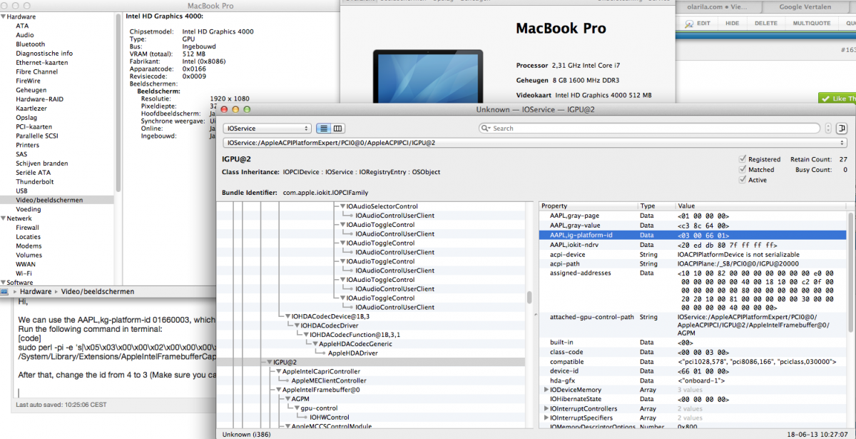

WaldMeister Posted June 18, 2013 Share Posted June 18, 2013 Hi, We can use the AAPL,kg-platform-id 01660003, which will make our Intel HD 4000 show up as 512mb cards again, without the need to use the rollback kexts. Run the following command in terminal: sudo perl -pi -e 's|\x05\x03\x00\x00\x02\x00\x00\x00\x30\x00\x00\x00|\x05\x03\x00\x00\x02\x00\x00\x00\x30\x02\x00\x00|' /System/Library/Extensions/AppleIntelFramebufferCapri.kext/Contents/MacOS/AppleIntelFramebufferCapri After that, change the id from 4 to 3 (Make sure you can revert if needed, so keep a backup dsdt which you can load, if anything goes wrong.) Let me know if it works out for you. Also rebuild the DSDT again, will update the guide somewhere this week. The DTGP method is excluded now, so the system will boot faster. Also made changes to the AppleGraphicsPowerManagement, which has increased the benchmark score by over 3000, since the AGPM and the PlatformPlugin are now loaded. http://browser.primatelabs.com/geekbench2/2061379 patch.txt 1 Link to comment https://www.insanelymac.com/forum/topic/281476-dell-inspiron-17r-notebook-inspiron-7720-can-run-mac-os-x/page/7/#findComment-1925340 Share on other sites More sharing options...

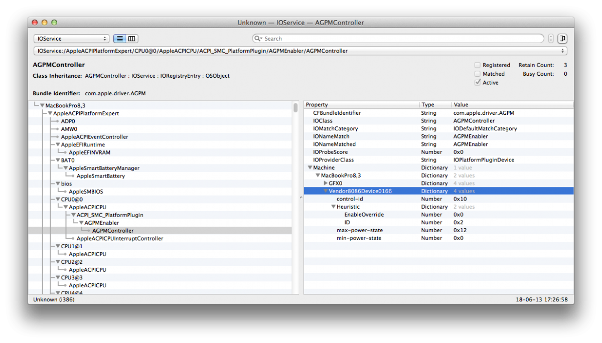

WaldMeister Posted June 18, 2013 Share Posted June 18, 2013 Attached you will find the files that are responsible for my speed increase, i will go over them 1 by one. I have an unlocked bios, and i use Clover as a boot loader, if this can be tested on Chameleon with an unmodified bios, and confirmed on Clover with an unmodified bios, that would be great. 1) As i had mentioned before, the DSDT has been rebuild. somehow i was not satisfied with the results the old 1 provided. During the process i found a new way of patching (Toleda HDMI patches taken as an example), as an example, the DTGP method has been left out, which increases boot time. Some extra PCI information from the SSDT files has been added, HPET patch has been left out, seems useless for our system. In the DSDT, the AAPL,kg-platform-id has been set to id 3: "AAPL,ig-platform-id", Buffer (0x04) { 0x03, 0x00, 0x66, 0x01 }, If you only install the DSDT, you will end up having a black screen. So either change the 3 to a 4 in the DSDT, or continue to the next step. 2) In the zip, you will find a file called AppleIntelFramebufferCapri.kext. This kext is responsible for allocating the memory to the Intel HD graphics. The easiest way is to install the kext, using an utility like Kext Drop. On a side note, the kext is from 10.8.4, if you have not updated the system yet, you can patch the kext from terminal. Open up terminal, and enter the following command (can also be seen in the above post): sudo perl -pi -e 's|\x05\x03\x00\x00\x02\x00\x00\x00\x30\x00\x00\x00|\x05\x03\x00\x00\x02\x00\x00\x00\x30\x02\x00\x00|' /System/Library/Extensions/AppleIntelFramebufferCapri.kext/Contents/MacOS/AppleIntelFramebufferCapri What the patch does, is re-assing the LVDS device, from ID 01660004 to ID 01660003, and therefore increase the amount of VRAM allocated to the Intel HD 4000. Also attached as shell script: #!/bin/bash #This script needs to run as root ROOT_UID=0 if [[ $UID -ne $ROOT_UID ]]; then echo "YOU MUST BE ROOT TO RUN THIS SCRIPT" exit 1 fi echo "Do you want to patch the AppleIntelFramebufferCapri to enable the AAPL,ig-platform-id 01660003? (y/n)?" read answer if [ "$answer" == "y" ]; then mkdir -p Backup cp -R "/System/Library/Extensions/AppleIntelFramebufferCapri.kext" "/Backup/AppleIntelFramebufferCapri.kext" sudo perl -pi -e 's|\x05\x03\x00\x00\x02\x00\x00\x00\x30\x00\x00\x00|\x05\x03\x00\x00\x02\x00\x00\x00\x30\x02\x00\x00|' "/System/Library/Extensions/AppleIntelFramebufferCapri.kext/Contents/MacOS/AppleIntelFramebufferCapri" echo "AppleIntelFramebufferCapri has been patched" fi echo "Remember to set your Mac Model to MacBookPro8,3 in the SMBios.plist or config.plist." exit 3) The AppleGraphicsPowerManagement has been modified also. This requires only an edit in the info.plist of the kext. I searched for MacBookPro with similar graphics to ours, the MacBookPro 9,1 was a match. Opened the plist, and searched for: Mac-4B7AC7E43945597E Copied the following part to paste it under a definition later: <key>IGPU</key> <dict> <key>Heuristic</key> <dict> <key>EnableOverride</key> <integer>0</integer> <key>ID</key> <integer>2</integer> </dict> <key>control-id</key> <integer>16</integer> <key>max-power-state</key> <integer>10</integer> <key>min-power-state</key> <integer>0</integer> </dict> The GFX0 part is useless, since the 650GT M has been disabled. I searched for the MacBookPro9,1 in the plist, but it was not present, so under the MacBookPro8,1, i replaced the IGPU with the code i had copied before. Now the only thing that had to be done, was rename the <key>IGPU</key> to the following: <key>Vendor8086Device0166</key> (Which is our HD4000) I rebooted, but nothing had changed, this was because i had the wrong model set in the SMBIOS. You only need to adjust the model. Clover: Change <key>ProductName</key> <string>MacBookPro9,1</string> to: <key>ProductName</key> <string>MacBookPro8,3</string> With Chameleon edit the: SMProductName Now if all went well, the ACPI_SMC_PlatformPlugin is loaded, which will also load the AGPMController, thus increasing performance. When testing the new DSDT, before replacing the old 1, rename the new 1 to DSDT_new.aml. Copy it to the boot loaders ACPI folder, and on boot give in the following: Chameleon: dsdt=DSDT_new.aml Clover, got to options > fix dsdt mask, press enter, and rename DSDT.aml to DSDT_new.aml. Also boot with -v. If anything goes wrong, just reboot, and the old DSDT will load again, so the system should boot up normal. Any feedback is greatly appreciated. aifc.sh.zip testpack 2.zip 1 Link to comment https://www.insanelymac.com/forum/topic/281476-dell-inspiron-17r-notebook-inspiron-7720-can-run-mac-os-x/page/7/#findComment-1925447 Share on other sites More sharing options...
kstephens98 Posted June 18, 2013 Share Posted June 18, 2013 Thanks Lejenk. I am using chameleon and this worked, except that the HD4000 now only shows 384 MB of VRAM. I am hoping that is the error you found. Link to comment https://www.insanelymac.com/forum/topic/281476-dell-inspiron-17r-notebook-inspiron-7720-can-run-mac-os-x/page/7/#findComment-1925470 Share on other sites More sharing options...
WaldMeister Posted June 18, 2013 Share Posted June 18, 2013 Hmm, it should show up as 512MB after the patch. Did you install the files provided, run the patch, or both? And are you injecting the AAPL,kg-platform-id through org.chameleon.boot.plist? Thanks for testing the files. 1 Link to comment https://www.insanelymac.com/forum/topic/281476-dell-inspiron-17r-notebook-inspiron-7720-can-run-mac-os-x/page/7/#findComment-1925472 Share on other sites More sharing options...
kstephens98 Posted June 18, 2013 Share Posted June 18, 2013 Hmm, it should show up as 512MB after the patch. Did you install the files provided, run the patch, or both? And are you injecting the AAPL,kg-platform-id through org.chameleon.boot.plist? Thanks for testing the files. I installed the files provided. I did not run the patch. How do I inject AAPl,kg-platform-id through org.chameleon.boot.plist? I am definitely not doing that. Link to comment https://www.insanelymac.com/forum/topic/281476-dell-inspiron-17r-notebook-inspiron-7720-can-run-mac-os-x/page/7/#findComment-1925477 Share on other sites More sharing options...
WaldMeister Posted June 18, 2013 Share Posted June 18, 2013 Hehe, ok. I attached another kext to this post, think i might have dropped the wrong version in the package above, the attached file comes from my Extensions folder. Also boot with -f, perhaps it resolves the issue. AppleIntelFramebufferCapri.kext.zip 1 Link to comment https://www.insanelymac.com/forum/topic/281476-dell-inspiron-17r-notebook-inspiron-7720-can-run-mac-os-x/page/7/#findComment-1925478 Share on other sites More sharing options...
kstephens98 Posted June 18, 2013 Share Posted June 18, 2013 Hehe, ok. I attached another kext to this post, think i might have dropped the wrong version in the package above, the attached file comes from my Extensions folder. Also boot with -f, perhaps it resolves the issue. Hehe, ok. I attached another kext to this post, think i might have dropped the wrong version in the package above, the attached file comes from my Extensions folder. Also boot with -f, perhaps it resolves the issue. That did the trick!! Thank you!!!! :thumbsup_anim: 1 Link to comment https://www.insanelymac.com/forum/topic/281476-dell-inspiron-17r-notebook-inspiron-7720-can-run-mac-os-x/page/7/#findComment-1925487 Share on other sites More sharing options...
