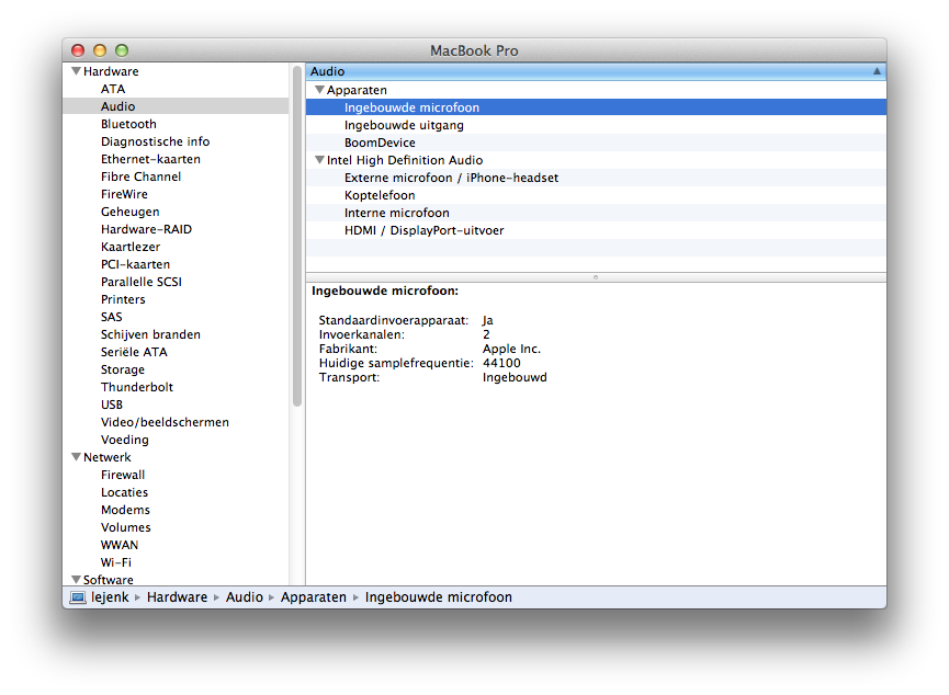

WaldMeister Posted February 10, 2013 Share Posted February 10, 2013 Hi ThibaultAnd, So it only shows the Intel High Definition Audio? Attached a screen of my profiler, the BoomDevice is an Audiobooster application called Boom. Did you remove the VoodooHDA when installing AppleHDA? And how did you install the AppleHDA? Attached also my latest DSDT. Extra included since the previous version: - Atheros 9285 - Intel HD4000 (No more need for efi string) Also cleaned up the last warning. Also, even if we have the same model, hardware can differ If the new files do not work, could you attach the codec.txt here? I have noticed a thing about my USB, i guess its working as USB 2.0! I have an external Toshiba 1TB HDD which has an LED indicator. This indicator is illuminated to White light when connected to USB 2.0 and Blue Light when connected to USB 3.0. On my Windows 8 installation, it shows Blue light when connected and on my Mac it shows white??? Did you install any usb kexts? USB 3.0 should work fine. DSDT.aml.zip AppleHDA.kext.zip Link to comment https://www.insanelymac.com/forum/topic/281476-dell-inspiron-17r-notebook-inspiron-7720-can-run-mac-os-x/page/5/#findComment-1887578 Share on other sites More sharing options...

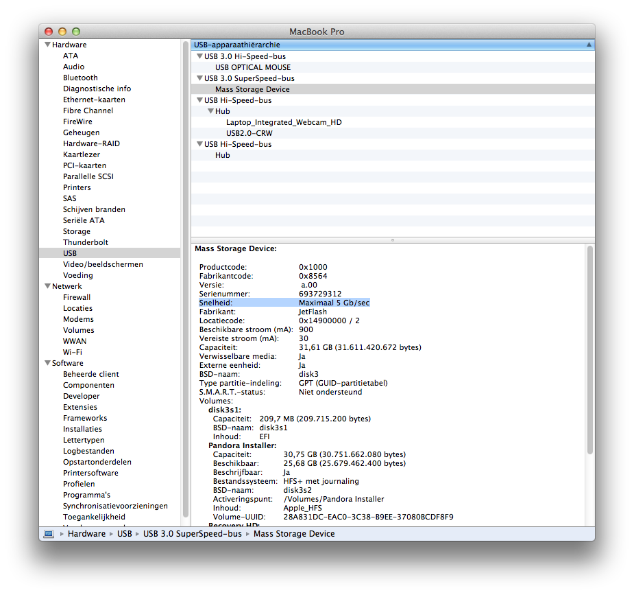

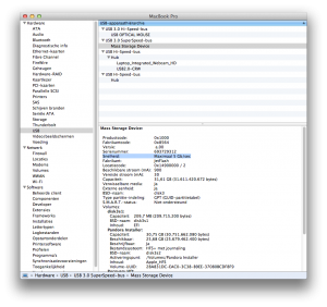

ACDindia Posted February 12, 2013 Share Posted February 12, 2013 I will give that a try n report here.. BTW, about the USB 3 problem.... I have attached a screenshot on my USB device list.. It shows two USB High-Speed Bus (USB 2.0) and one USB Super-Speed Bus (USB 3.0).. The problem is that there are no Hubs listed under USB Super-Speed Bus... everything I have attached is under the two USB High-Speed Bus.. The 1.0TB external HDD that I had attached with the system is shown as USB 3.0 external drive but works as USB 2.0 as indicated by the LED.... Dunno where I am goin wrong.... ! Thanks for your continued help!! Screenshot: USB.tiff USB.tiff Link to comment https://www.insanelymac.com/forum/topic/281476-dell-inspiron-17r-notebook-inspiron-7720-can-run-mac-os-x/page/5/#findComment-1888195 Share on other sites More sharing options...
WaldMeister Posted February 12, 2013 Share Posted February 12, 2013 I don't even have the USB Super-Speed Bus listed. Think it is because i replace the IOUSBFamily.kext. I've looked at the speeds between my USB 2.0 and USB 3.0 devices, they all work as USB 2.0, will have to look in to it when i have time. No solution at the moment, sorry Link to comment https://www.insanelymac.com/forum/topic/281476-dell-inspiron-17r-notebook-inspiron-7720-can-run-mac-os-x/page/5/#findComment-1888198 Share on other sites More sharing options...

WaldMeister Posted February 12, 2013 Share Posted February 12, 2013 Fix attached. I have set: USB Emulation > Disabled, in bios. (Don't know if this makes a difference) My USB 2.0 mass storage devices are not recognized, installed the vanilla iousbmasstorage.kext, will revert, hopefully USB 3.0 keeps working like this PXHCD.kext.zip Link to comment https://www.insanelymac.com/forum/topic/281476-dell-inspiron-17r-notebook-inspiron-7720-can-run-mac-os-x/page/5/#findComment-1888214 Share on other sites More sharing options...

WaldMeister Posted February 12, 2013 Share Posted February 12, 2013 Use the vanilla IOUSBFamily.kext, i'm using the one from 10.8.2 now, only problem is, it does not recognize the USB 2.0 storage devices. Attached the Vanilla kext. I also noticed, the USB device should not be connected when booting the system. It will either show as USB 2.0, or not show up at all. I'm trying to modify the kext now, to make both devices work. IOUSBFamily.kext.zip Link to comment https://www.insanelymac.com/forum/topic/281476-dell-inspiron-17r-notebook-inspiron-7720-can-run-mac-os-x/page/5/#findComment-1888237 Share on other sites More sharing options...
