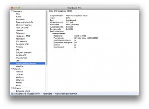

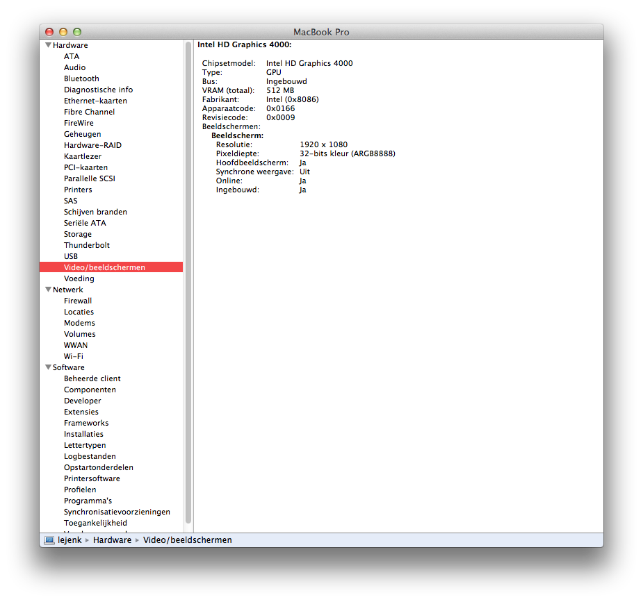

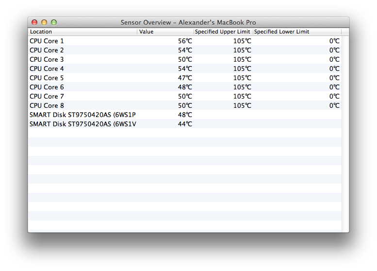

WaldMeister Posted February 13, 2013 Share Posted February 13, 2013 Benchmark results: http://browser.prima...kbench2/1643849 I put some effort in the DSDT last night. A quick summary of everything included up to now: - The SSDT tables have been merged in to the DSDT, so the SSDT is not needed anymore. - Fan control - Speedstep/Sleep/Wake - Audio (With patched AppleHDA) - Brightness control (Only in System Preferences) - HD4000 Graphics (No need for EFI string) - Nvdia GPU disabled (Saver power and keeps the system a lot cooler/Battery life has doubled) - FN keys for audio/sleep/wifi The changes since the last DSDT are marked in blue. The code is a mess at the moment, i still need organize is a bit more. This DSDT may, or may not work for you, use with caution, and always make a backup before replacing files. Ow, and it still has the code for the AR9285 included DSDT.aml.zip Link to comment https://www.insanelymac.com/forum/topic/281476-dell-inspiron-17r-notebook-inspiron-7720-can-run-mac-os-x/page/6/#findComment-1888425 Share on other sites More sharing options...

ACDindia Posted February 13, 2013 Share Posted February 13, 2013 - The SSDT tables have been merged in to the DSDT, so the SSDT is not needed anymore. - Fan control Dunno how to check.. - Speedstep/Sleep/Wake Already worked - Audio (With patched AppleHDA) Already worked - Brightness control (Only in System Preferences) Already worked - HD4000 Graphics (No need for EFI string) YES! No more Device ID! - Nvdia GPU disabled (Saver power and keeps the system a lot cooler/Battery life has doubled).. Can't say, will need some testing for that... though the GPU is listed in Sys info. - FN keys for audio/sleep/wifi Yes. About USB 3.0: I am on the same boat. If I use IOUSBFamily + PXHCD or only IOUSBFamily = USB 3.0 but no USB 2.0 :/ But my WEBCAM starts working with any IOUSBFamily (patched or Vanilla)...!!! I can't live without USB 2.0 cuz my WiFi dongle doesn't work that way...... Removed them and back to USB 2.0 and WEBCAM stopped working.... :\ Maybe there will be a fix soon...... Any way to enable HDMI yet?? Thanks for your efforts Lejenk!! Link to comment https://www.insanelymac.com/forum/topic/281476-dell-inspiron-17r-notebook-inspiron-7720-can-run-mac-os-x/page/6/#findComment-1888572 Share on other sites More sharing options...

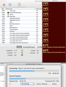

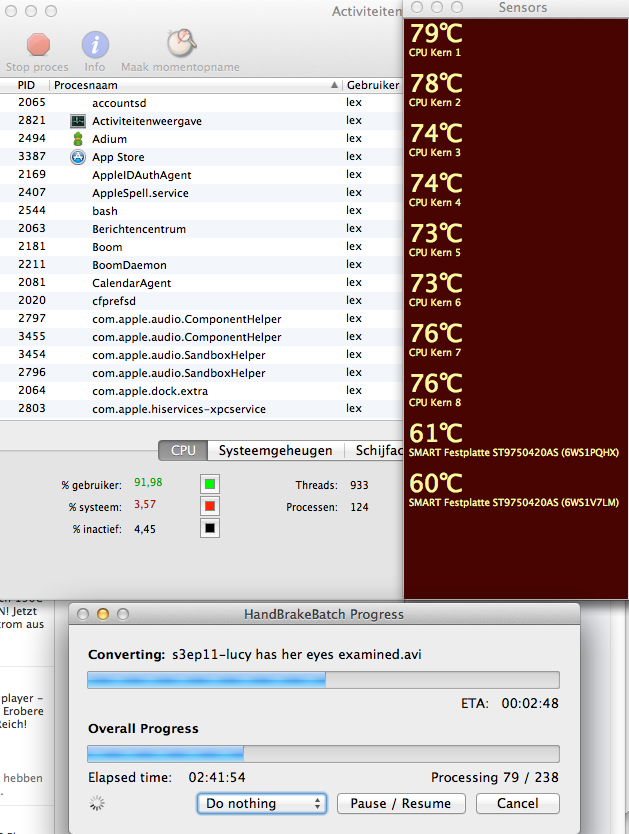

WaldMeister Posted February 13, 2013 Share Posted February 13, 2013 Yes, there is :/ Follow this guide, after that you should be able to boot from hdd: http://forum.voodoop...php?topic=649.0 @ACIndia The fan control, i noticed the fan throttles now, my cpu does not get above 80 degrees on 100% load, before it would reach 100 degrees. I noticed the GPU in system profiler now, will have to look in to it again Well, the code is in the DSDT, perhaps someone knows what is did wrong there. The USB is a serious issue, when you want to have both usb 2.0 and usb 3.0, they will only run on usb 2.0 speed. If you want usb 3.0 at full speed, no usb 2.0 (Although my webcam and mouse work) About the HDMI, i have no way to test this, there are some fixes for it, but i can not confirm if they will work :/ Also, anyone interested in writing a guide for this model? See attachment, been converting for 14 hours now at a 90% load, temps switch between 60-80 for cpu, hdd is stable at 60. (Btw, the show is called "I love Lucy" 50's show, so that you don't get the wrong ideas ) Link to comment https://www.insanelymac.com/forum/topic/281476-dell-inspiron-17r-notebook-inspiron-7720-can-run-mac-os-x/page/6/#findComment-1888629 Share on other sites More sharing options...

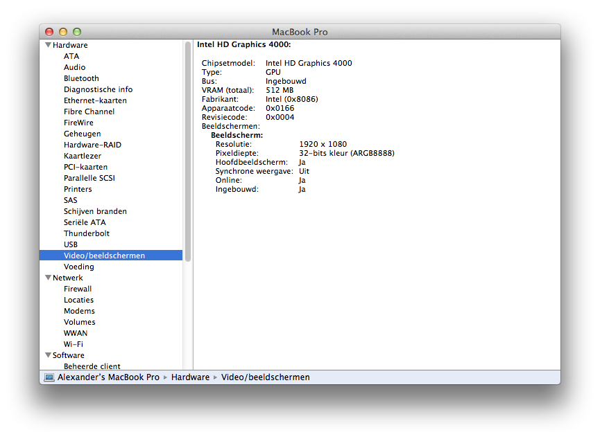

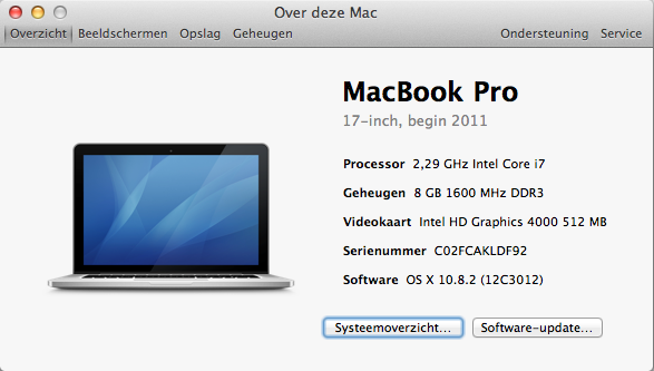

WaldMeister Posted February 14, 2013 Share Posted February 14, 2013 Btw, was looking for serials of macs, to get iMessages working, stil not working, but i just checked system profiler, my system is now reconized as a 17 inch macbook pro So attached the SMBios.plist. The serial had been posted by someone who macbook got stolen, he posted it on the apple support forum, never has been removed Edit: Also, i'm rebuilding the DSDT from scratch, not even an extraction, sure some of the content will be used, but it will be far more organized, and hopefully i find a way to disable that GPU. Hopefully i have it done by tonight. smbios.plist.zip Link to comment https://www.insanelymac.com/forum/topic/281476-dell-inspiron-17r-notebook-inspiron-7720-can-run-mac-os-x/page/6/#findComment-1888768 Share on other sites More sharing options...
