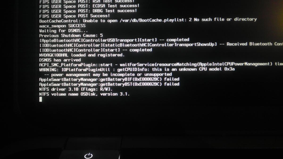

ACDindia Posted January 23, 2013 Share Posted January 23, 2013 Glad I could help a bit! So, What doesn't work: HDMI, Wifi (got Edimax nano USB wireless, works great), NVIDIA (Damn, Optimus), Mic line in, sub woofer. Also, while booting in verbose mode (my default), it says something about my CPU being unidentified and the power management may not be proper or completely unstable (sorry I do not remember exact lines).. On checking the forum, I found that the DSDT and settings are for " PROCESSOR 3rd Generation Intel® Core™ i7-3610QM processor (6M Cache, up to 3.3 GHz) Mine is 3rd Generation Intel® Core™ i7-3630QM processor (2.4Ghz with turbo boost upto 3.4Ghz)..... Maybe the CPU identifiers are different in the DSDT???? It may be having improper throttling i guess.....How can I fix it??? Thanks in advance!!! Link to comment https://www.insanelymac.com/forum/topic/281476-dell-inspiron-17r-notebook-inspiron-7720-can-run-mac-os-x/page/4/#findComment-1883161 Share on other sites More sharing options...
WaldMeister Posted January 23, 2013 Share Posted January 23, 2013 The patches i have applied, including the one to the intelcpupowermanagement, which enabled speedstep and sleep, should be sufficient. My CPU is being identified correctly, and yes, i also have this output in verbose mode. HDMI, WIFI(Will never work, as long as it is Intel), nVidia graphics (We can only hope for a solution). Battery management (Without Voodoo.) Can you link the dsdt for the cpu identifiers? Will look in to it tomorrow. Try my new DSDT By the way. Link to comment https://www.insanelymac.com/forum/topic/281476-dell-inspiron-17r-notebook-inspiron-7720-can-run-mac-os-x/page/4/#findComment-1883163 Share on other sites More sharing options...

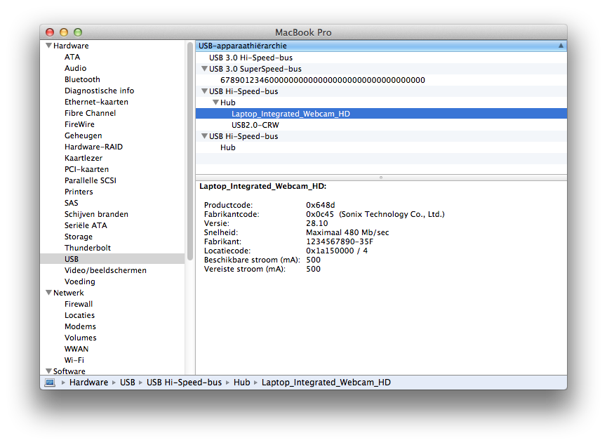

ACDindia Posted January 24, 2013 Share Posted January 24, 2013 I am uploading my unpatched DSDT (test.aml.zip), see if you can find the necessary info there.. Also, once weird problem, my webcam has stopped working after update!!! Although it is listed in the "System Information"...it is not detected in applications!!!! I tried replacing IOUSBFamily.kext and AppleACHIPort.kext, but no result! Also, fixed permissions with no result!! I have patched my own DSDT by extracting patches from your DSDT. I have also patched my SSDT using RevoGirl script. I am uploading them too... If anyone has the config like mine, Intel Core i7 3630QM, then they can try that..... SSDT has max turbo set to 3.4Ghz which is appropriate for i7 3630QM. Hoping for an HDMI fix soon....and NVIDIA optimus workaround.... Best of luck! Happy Hackintoshing! Just saw, Bluetooth is not working too! test.aml.zip WebCam.tiff DSDT_and_SSDT_3630QM.zip Link to comment https://www.insanelymac.com/forum/topic/281476-dell-inspiron-17r-notebook-inspiron-7720-can-run-mac-os-x/page/4/#findComment-1883430 Share on other sites More sharing options...

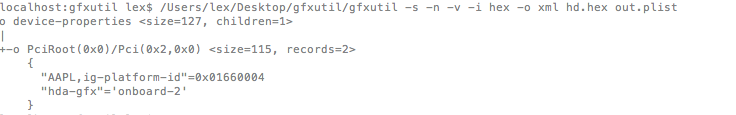

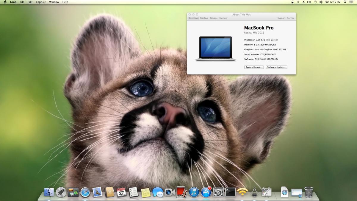

ACDindia Posted January 27, 2013 Share Posted January 27, 2013 I will try the DSDT fix for Ethernet and report here.. I have fixed the HD Graphics VRAM allocation back to 512MB.. :) Ok.... if anyone of you has noticed that your Intel HD Graphics 4000 has been turned down to 384MB from its original 512MB while updating from OS X 10.8.0 to 10.8.2... it happened with me and Lejenk at least.... Fix includes some Kexts from 10.8.0 which allocated 512MB VRAM to Intel HD 4000... Apple's 10.8.2 update stripped down allocated VRAM for HD 4000 to 384 MB in case of Macs with dedicated GPU.... as ours... Alright, Here is the fix: 1. Download the 512MB_Fix_ACDindia.zip 2. Unzip and install the kexts in S/L/E replacing the original kexts (Make sure to back up, just in case). 3. Repair permissions. 4. Restart. 5. It should be working by now. 6. Report if it worked Troubleshooting: If anything goes wrong.. 1. Boot with -x -v arguments. 2. Replace the installed Kexts with the backup you made. 3. Repair permissions. 4. Reboot. 5. Normal working conditions but back to 384MB VRAM. 6. Sorry. Enjoy!! Link to comment https://www.insanelymac.com/forum/topic/281476-dell-inspiron-17r-notebook-inspiron-7720-can-run-mac-os-x/page/4/#findComment-1884023 Share on other sites More sharing options...
WaldMeister Posted January 27, 2013 Share Posted January 27, 2013 Shows up correctly. Also, dsdt edit for the HD4000, the EFI string should not be needed anymore. The code goes under GFX0. Method (_DSM, 4, NotSerialized) { Store (Package (0x02) { "AAPL,ig-platform-id", Buffer (0x04) { 0x04, 0x00, 0x66, 0x01 } }, Local0) DTGP (Arg0, Arg1, Arg2, Arg3, RefOf (Local0)) Return (Local0) } After edit: Device (GFX0) { Name (_ADR, 0x00020000) Method (_DSM, 4, NotSerialized) { Store (Package (0x02) { "AAPL,ig-platform-id", Buffer (0x04) { 0x04, 0x00, 0x66, 0x01 } }, Local0) DTGP (Arg0, Arg1, Arg2, Arg3, RefOf (Local0)) Return (Local0) } Method (_STA, 0, NotSerialized) { Source: http://www.hackintos...-with-qeci.html Output from the EFI string attached in screenshot. Link to comment https://www.insanelymac.com/forum/topic/281476-dell-inspiron-17r-notebook-inspiron-7720-can-run-mac-os-x/page/4/#findComment-1884089 Share on other sites More sharing options...
