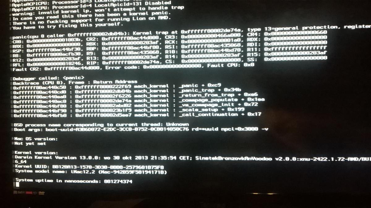

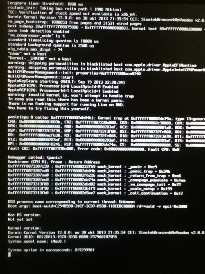

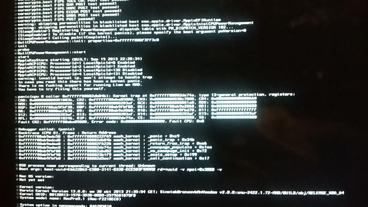

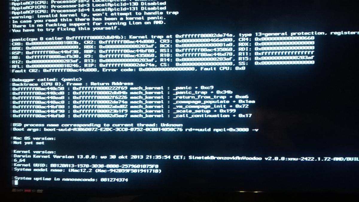

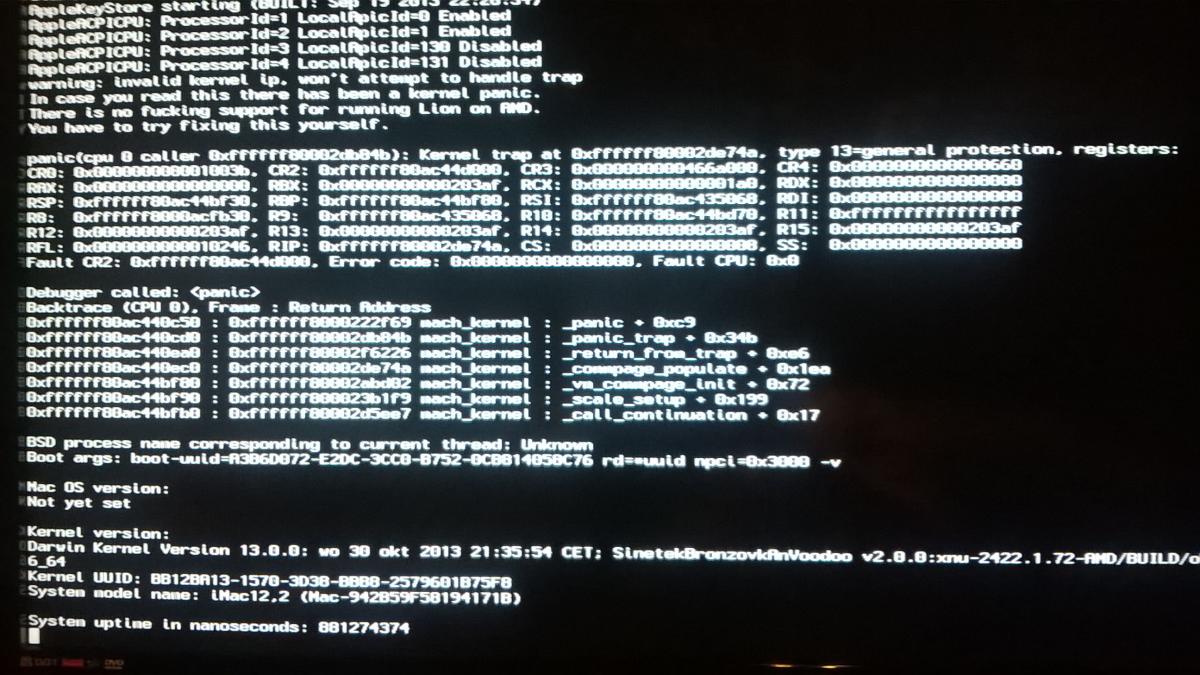

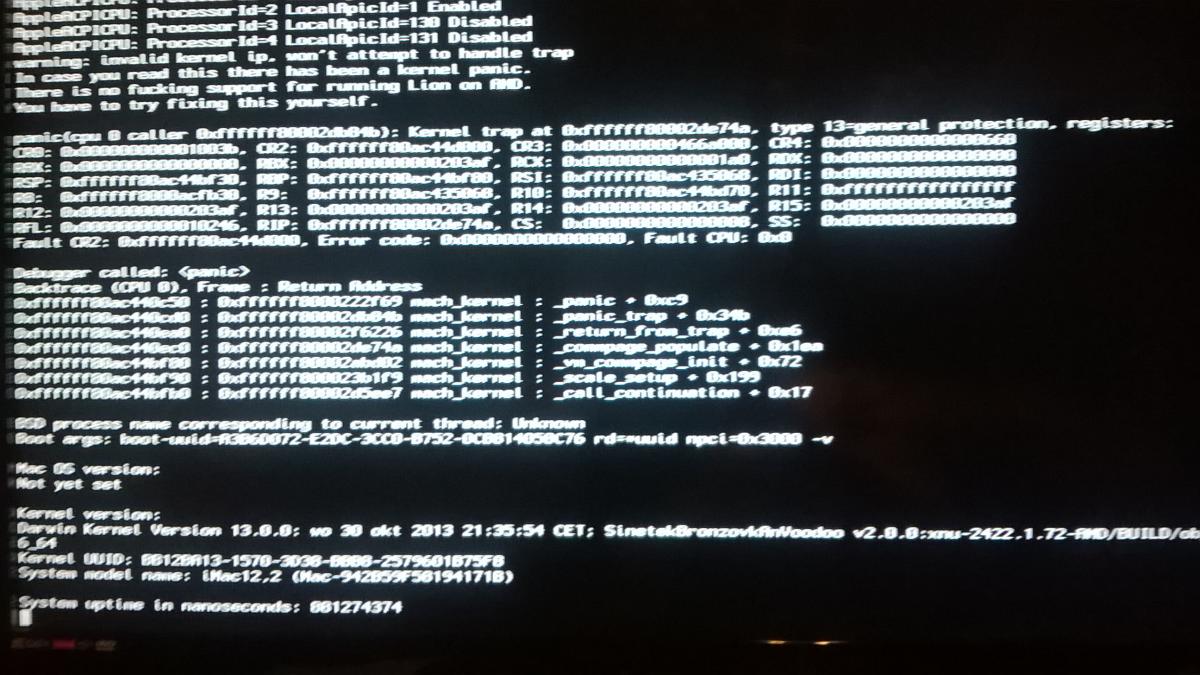

Damn... poor quality picture...
Can't make out the register values :(
Will try get a better one. Will reduce the resolution.
Edit: Here is a choice of pics. Sorry for the quality only camera I have is my phone.
WP_20131030_002.jpg WP_20131030_003.jpg WP_20131030_004.jpg WP_20131030_005.jpg
Disassembled the kernel and traced the issue...
It's a leaf7 issue...
Stand by, I can fix this... :D
EDIT: Seems to be a readmsr it panics on... gonna trace further...
This seems to be the issue:
uint64_t misc_enable = rdmsr64(MSR_IA32_MISC_ENABLE);
uint64_t misc_enable = 0;
if (IsIntelCPU())
Is the proper fix...
Post soon...

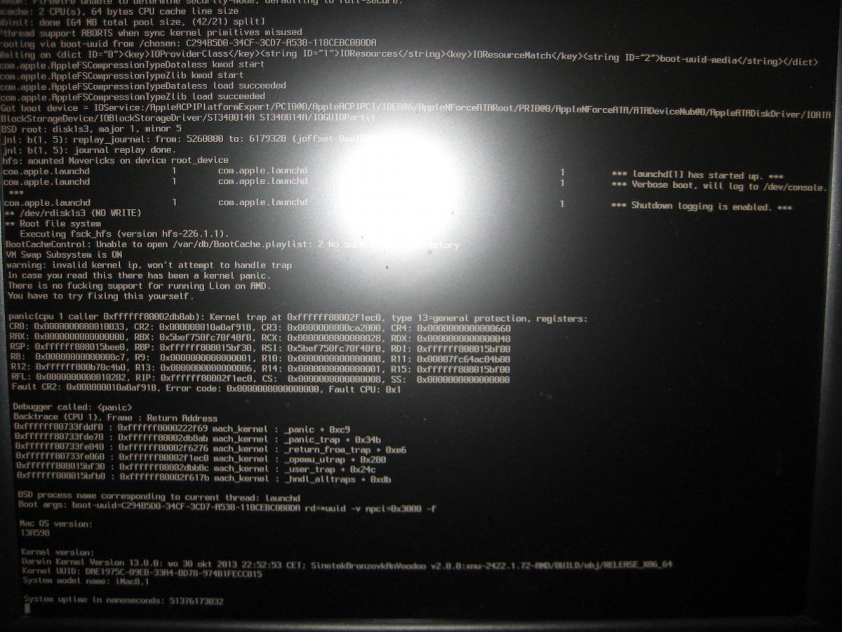

I've got "PCI PARITY ERROR" on my AMD Athlon X2 6000+ :( I tried with flags and without any flags, and PCI PARITY again :( This kernel is only for Athlon II X2? Not for older CPU's? And I used a DJ Wappy method for create USB Installer manually, so should I delete the kexts like - ApplePolicyControl.kext, AppleTyMCEDriver.kext, AppleUpstreamUserClient.kext?  This might be the cause of "PCI PARITY"?
Because if IiTz ShAnE has KP, than I am doing something wrong :( Any ideas?

identical kp as IiTz ShAnE
AMD Athlon 64X2 4400+ Toledo

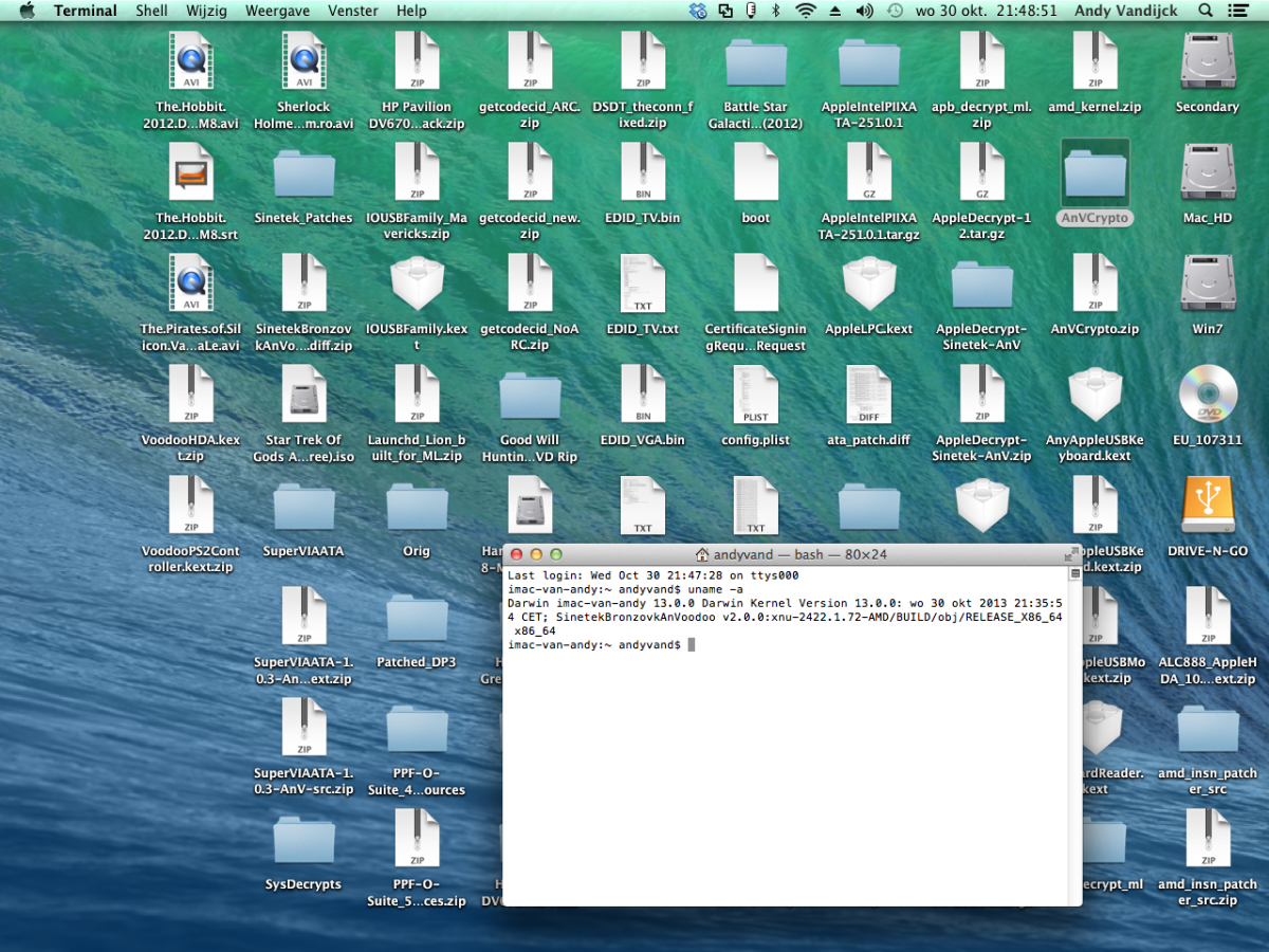

Booted to desktop :D Slow boot but its working :D
Shortly after desktop loading KP linked to soagent.

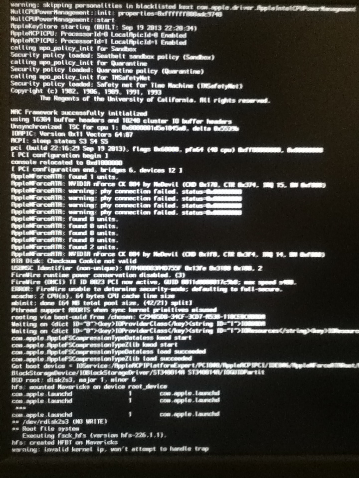

Could you provide me some clear and readable pics of the KP?
I could try to trace it...
i got me camera out
