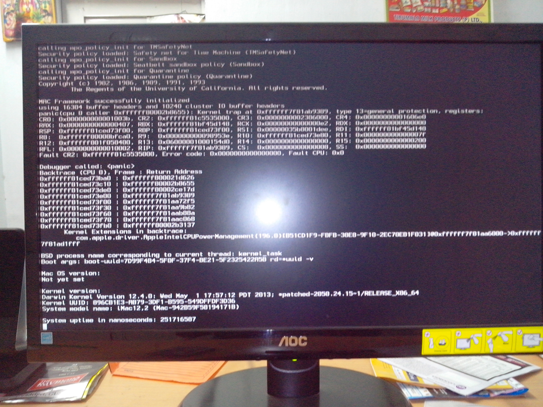

tej720 Posted September 17, 2013 Share Posted September 17, 2013 Hello sir, I Followed the steps carefully but when i boot with -v mode i got this problem can anyone help me.... Link to comment https://www.insanelymac.com/forum/topic/280756-guide-the-all-in-one-guide-to-vanilla-os-x-including-chameleon-dsdt-for-beginners-updated-for-yosemite/page/20/#findComment-1946409 Share on other sites More sharing options...
k3nny Posted September 17, 2013 Share Posted September 17, 2013 @tej720: You need to do step 1.C.2 - install the NullCPUPowerManagement kext. If you do not want it, you need to patch the AppleIntelCPUPowerManagement kext (see "Kernel extensions in backtrace"). 1 Link to comment https://www.insanelymac.com/forum/topic/280756-guide-the-all-in-one-guide-to-vanilla-os-x-including-chameleon-dsdt-for-beginners-updated-for-yosemite/page/20/#findComment-1946412 Share on other sites More sharing options...
tej720 Posted September 18, 2013 Share Posted September 18, 2013 Thanks for the help, I have patched the AppleIntelCPUPowerManagement.kext Now i got a black sreen what should i do. Please tell me..... my system Config : INTEL DH77KC I7 3770 Proccessor Zotak gt630 4GB Graphic Card Seagate 2TB Hard disk Zion 8GBx2 Ram Link to comment https://www.insanelymac.com/forum/topic/280756-guide-the-all-in-one-guide-to-vanilla-os-x-including-chameleon-dsdt-for-beginners-updated-for-yosemite/page/20/#findComment-1946652 Share on other sites More sharing options...
artur_pt Posted September 18, 2013 Share Posted September 18, 2013 hello try to boot -v GraphicsEnabler=No good hack 1 Link to comment https://www.insanelymac.com/forum/topic/280756-guide-the-all-in-one-guide-to-vanilla-os-x-including-chameleon-dsdt-for-beginners-updated-for-yosemite/page/20/#findComment-1946678 Share on other sites More sharing options...
tej720 Posted September 18, 2013 Share Posted September 18, 2013 Thanks for the help Tried to boot with -v GraphicsEnabler=NO This is also not working but -v GraphicsEnabler=YES make it to installation screen but not responding.... please help.... Link to comment https://www.insanelymac.com/forum/topic/280756-guide-the-all-in-one-guide-to-vanilla-os-x-including-chameleon-dsdt-for-beginners-updated-for-yosemite/page/20/#findComment-1946774 Share on other sites More sharing options...
