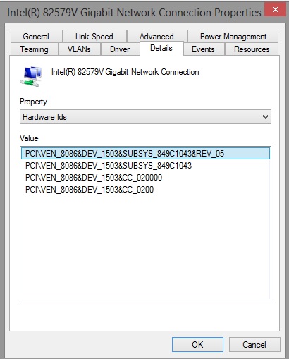

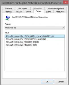

artur_pt Posted May 13, 2013 Share Posted May 13, 2013 hello man if u install the system ... and gonna see in /system/library/extensions.. u will see that all the kext are there.. now if all working enjoy and learn how to work with mac os x... and read all about the system. try this for lan.. http://www.insanelymac.com/forum/topic/213990-appleintele1000kext/ good hack Link to comment https://www.insanelymac.com/forum/topic/280756-guide-the-all-in-one-guide-to-vanilla-os-x-including-chameleon-dsdt-for-beginners-updated-for-yosemite/page/15/#findComment-1914806 Share on other sites More sharing options...
catalinz Posted May 13, 2013 Share Posted May 13, 2013 hello man if u install the system ... and gonna see in /system/library/extensions.. u will see that all the kext are there.. now if all working enjoy and learn how to work with mac os x... and read all about the system. try this for lan.. http://www.insanelym...intele1000kext/ good hack Unfortunately my adapter version is not there, mine is "Intel 82579V Gigabit Network Connection" with ROM: Intel® Boot Agent GE v1.4.10 IBA GE Slot 0000 v1410 PXE 2.1 Build 092 (WfM 2.0) Link to comment https://www.insanelymac.com/forum/topic/280756-guide-the-all-in-one-guide-to-vanilla-os-x-including-chameleon-dsdt-for-beginners-updated-for-yosemite/page/15/#findComment-1914811 Share on other sites More sharing options...
artur_pt Posted May 13, 2013 Share Posted May 13, 2013 hello have u try the kext ? u can try also insert in it... info.plist u dev id and vendor id good hack Link to comment https://www.insanelymac.com/forum/topic/280756-guide-the-all-in-one-guide-to-vanilla-os-x-including-chameleon-dsdt-for-beginners-updated-for-yosemite/page/15/#findComment-1914813 Share on other sites More sharing options...
catalinz Posted May 13, 2013 Share Posted May 13, 2013 i will finish the dsdt and the rest of the guide, than if not work, ill try what you recommend but first to finish all the guide. in the previous post, i attached a pic with the device id also, i dont know exactly how to work with this ill need some specific explanation. Link to comment https://www.insanelymac.com/forum/topic/280756-guide-the-all-in-one-guide-to-vanilla-os-x-including-chameleon-dsdt-for-beginners-updated-for-yosemite/page/15/#findComment-1914814 Share on other sites More sharing options...
artur_pt Posted May 13, 2013 Share Posted May 13, 2013 hello it seem it work with that kext http://www.insanelymac.com/forum/topic/282649-ga-z77x-ud5h-myhack-mountain-lion-installed%E2%80%A6-whats-next/ good hack Link to comment https://www.insanelymac.com/forum/topic/280756-guide-the-all-in-one-guide-to-vanilla-os-x-including-chameleon-dsdt-for-beginners-updated-for-yosemite/page/15/#findComment-1914818 Share on other sites More sharing options...

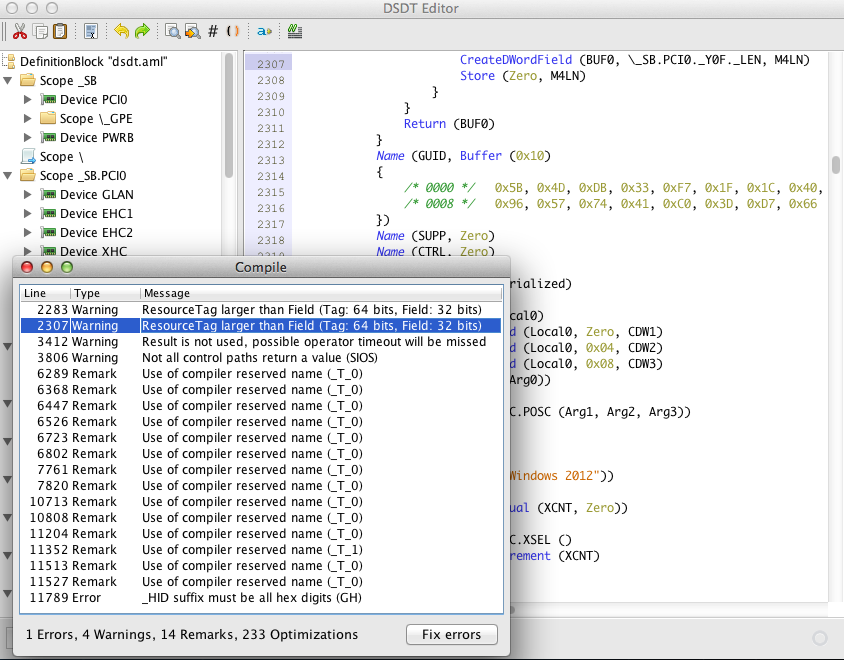

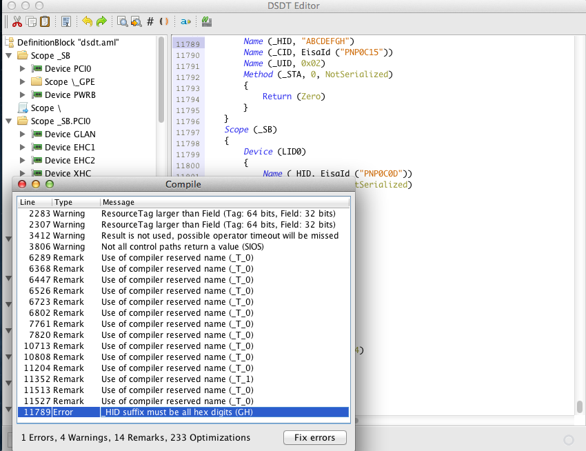

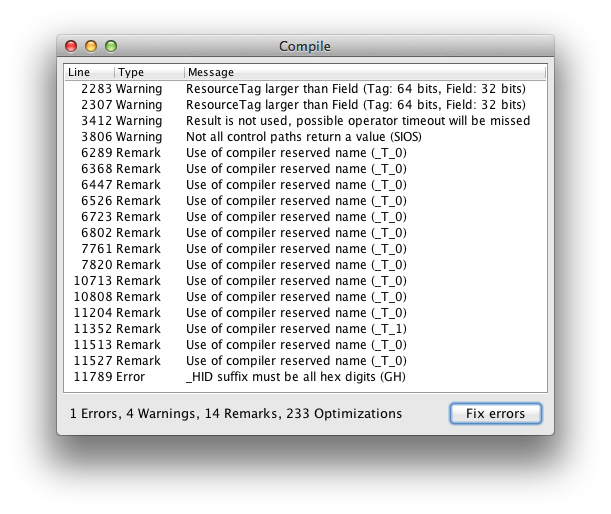

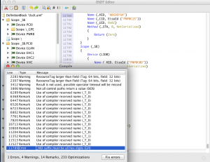

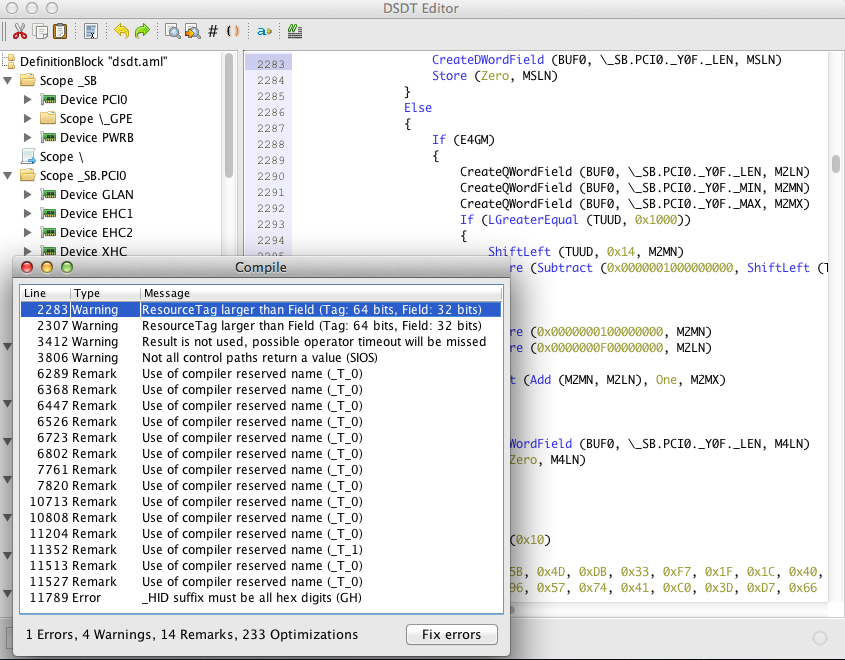

catalinz Posted May 15, 2013 Share Posted May 15, 2013 Hello, please help! At Part 5 -DSDT After i extract the dsdt and than go compile, finds 12 errors, It fixes 11 errors but 1 error it cannot fix it and i can`t save AML, i dont know what to do here please check the s-shots bellow and maybe you can help me, or i can save this way but how? Link to comment https://www.insanelymac.com/forum/topic/280756-guide-the-all-in-one-guide-to-vanilla-os-x-including-chameleon-dsdt-for-beginners-updated-for-yosemite/page/15/#findComment-1915259 Share on other sites More sharing options...
k3nny Posted May 15, 2013 Share Posted May 15, 2013 Search for the string "ABCDEFGH" and replace it with "ABCDEFF" for example. "G" and "H" are not hexadecimal digits, thus the error. The name should not matter. 1 Link to comment https://www.insanelymac.com/forum/topic/280756-guide-the-all-in-one-guide-to-vanilla-os-x-including-chameleon-dsdt-for-beginners-updated-for-yosemite/page/15/#findComment-1915262 Share on other sites More sharing options...
artur_pt Posted May 15, 2013 Share Posted May 15, 2013 hello replace the string by "PNP0C15" anyway only compile the dsdt.. if u don't apply any patches.. is already compiled... only use the original dsdt present in u bios.. good hack 1 Link to comment https://www.insanelymac.com/forum/topic/280756-guide-the-all-in-one-guide-to-vanilla-os-x-including-chameleon-dsdt-for-beginners-updated-for-yosemite/page/15/#findComment-1915264 Share on other sites More sharing options...

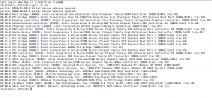

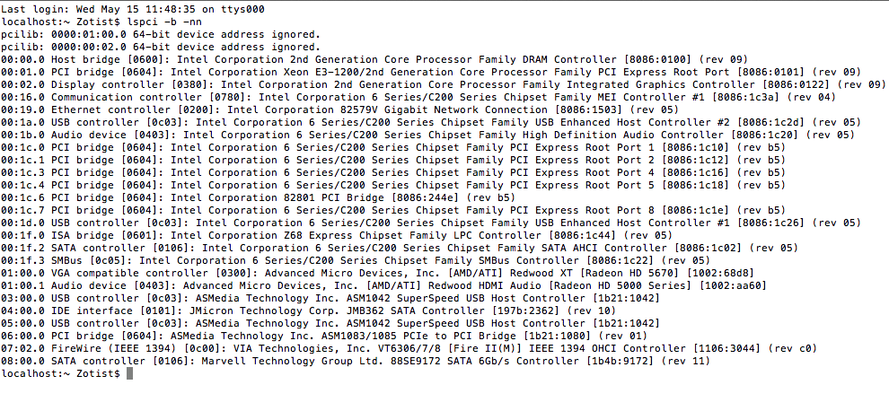

catalinz Posted May 15, 2013 Share Posted May 15, 2013 I deleted the old pci.ids.gz had a lot of UNKNOWN DEVICES and copy the latest one, that resolved almost all unknown devices here is how it looks now, so in this case do i need new dsdt? or compile save aml etc? hello replace the string by "PNP0C15" U mean this string ABCDEFGH ? anyway only compile the dsdt.. if u don't apply any patches.. is already compiled... only use the original dsdt present in u bios.. Hmm..can you be more specific details, im not sure i understand right Link to comment https://www.insanelymac.com/forum/topic/280756-guide-the-all-in-one-guide-to-vanilla-os-x-including-chameleon-dsdt-for-beginners-updated-for-yosemite/page/15/#findComment-1915268 Share on other sites More sharing options...
artur_pt Posted May 15, 2013 Share Posted May 15, 2013 hello if is all working good ,, u don't need to patch the dsdt.. u boot loader already apply to it the basic patches ... when u patch the dsdt .. is to try to resolve problems.. (like powermanagement , sound, usb..) but dsdt is not GOD... if it is i have a macbookpro (retina ) in my old notebook... rsrrsrsrs good hack hello what u are only using is a editor... if u don't apply nothing new to the dsdt.. no sense compile it take a good look here http://olarila.com/forum/viewtopic.php?f=19&t=634 good hack Link to comment https://www.insanelymac.com/forum/topic/280756-guide-the-all-in-one-guide-to-vanilla-os-x-including-chameleon-dsdt-for-beginners-updated-for-yosemite/page/15/#findComment-1915270 Share on other sites More sharing options...
