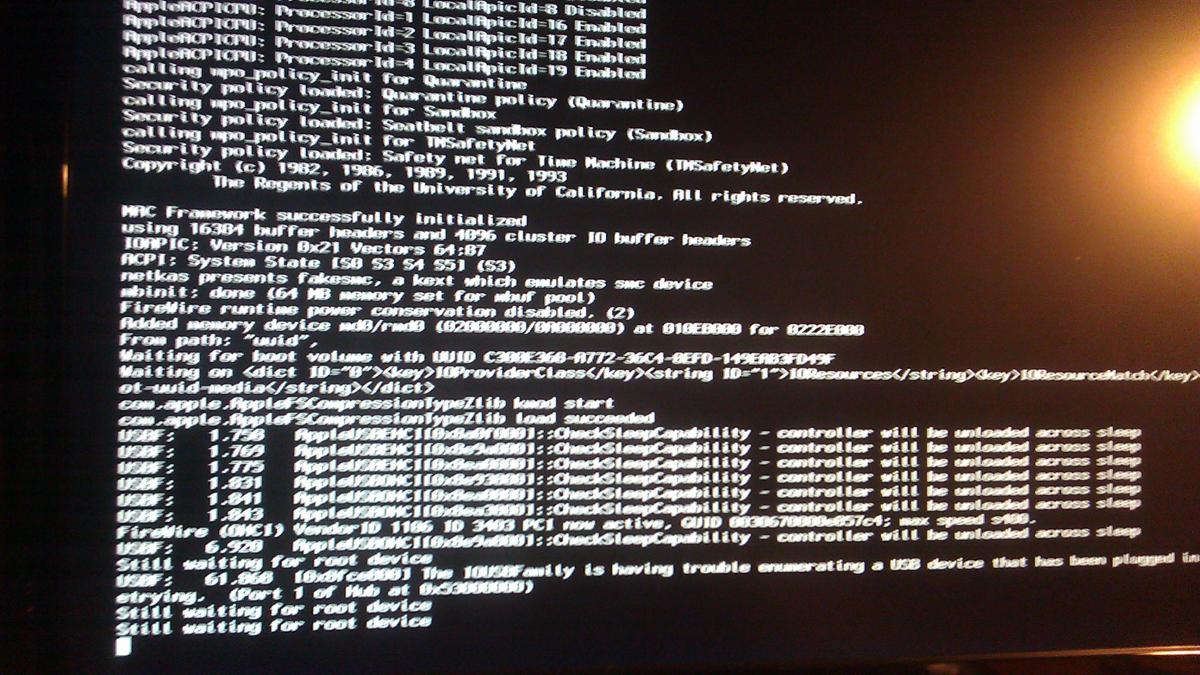

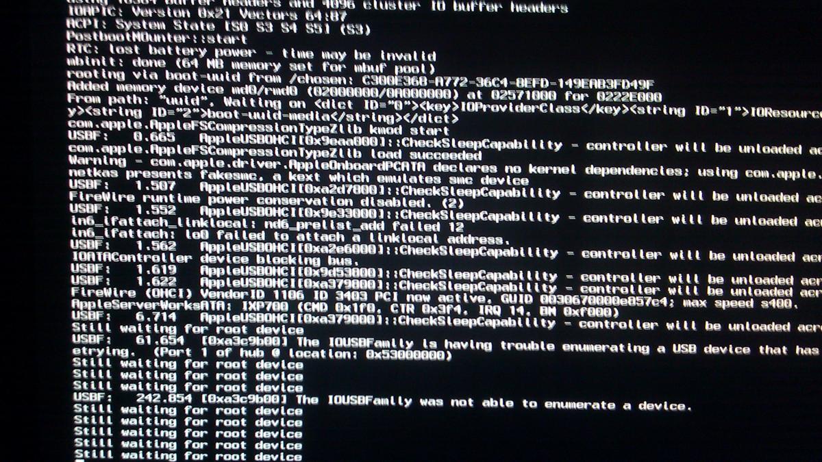

EvilMacMongo Posted March 19, 2012 Author Share Posted March 19, 2012 ok so I copied that stuff over and I got past the nullpowermanagement. and now I get this. Link to comment Share on other sites More sharing options...
ZØØT Posted March 19, 2012 Share Posted March 19, 2012 I got that last error from using a USB HUB that didn't have drivers at the boot stage. I unplugged the hub and everything was fine. I am able to use the HUB after the OS loads. I need to check IOReg to see which kext I should add to the preboot cache. I don't know at this point what will work and as usual your situation may be different to mine. Link to comment Share on other sites More sharing options...
EvilMacMongo Posted March 19, 2012 Author Share Posted March 19, 2012 well the USBS I have plugged in are my printer, mouse, keyboard, and phone cord. I'm not understanding this, it seems, (If I'm seeing this right) that since I copied the cd contents, and changed the strings to run off HD instead of RD that it should be identical, but why can it not load from the HDD? I even tried patching chameleon over this, and exact same thing Link to comment Share on other sites More sharing options...
ZØØT Posted March 19, 2012 Share Posted March 19, 2012 Here is the plist I have placed in the preboot image: try the usb fix command at the prompt. Man, I hate to think I dug another hole for you on this. <key>DSDT</key> <string>rd(0,0)/Extra/DSDT.aml</string> <key>Graphics Mode</key> <string>1280x1024x32@60</string> <key>GraphicsEnabler</key> <string>No</string> <key>Kernel</key> <string>rd(0,0)/Extra/legacy_kernel</string> <key>Kernel Flags</key> <string>maxmem=3072 cpus=1 arch=i386</string> <key>Legacy Logo</key> <string>No</string> <key>SMBIOS</key> <string>rd(0,0)/Extra/smbios.plist</string> <key>USBBusFix</key> <string>Yes</string> <key>Wait</key> <string>Yes</string> Link to comment Share on other sites More sharing options...
EvilMacMongo Posted March 19, 2012 Author Share Posted March 19, 2012 lol it's okay, even when I try the usbbusfix it is the same......I even made a dsdt.aml and moved the smbios over and changed from RD, to HD and still no dice. just gets the still waiting, and it doesn't freeze for like 10 mins, it just keeps giving a different still waiting for root.......then can't enumerate..... not my only problem so no biggie, can't get graphics card to register, and speakers have a nasty constant static. And can't update past 10.6.4 without errors... Link to comment Share on other sites More sharing options...

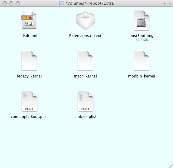

ZØØT Posted March 20, 2012 Share Posted March 20, 2012 Did your pre boot image look like this when you tried to install off the HDD? I think I left out the step where you place your DSDT file and SMBIOS into the pre boot image. The one off of the disk won't have a DSDT and it comes with a generic SMBIOS. Also did you choose to boot from USB as a first priority in your machine BIOS? Try MKextTool.app to rebuild your cahe as well. Link to comment Share on other sites More sharing options...
EvilMacMongo Posted March 20, 2012 Author Share Posted March 20, 2012 it had everything but the dsdt.aml. I made one of those with Dsdt patcher gui and stuck it in there as well, also changed the rd on the smbios, the dsdt, and the kernel to hd No first boot priority is my mac hdd, after CDROM everything in the /extra folder on my mac hdd: Extensions (folder) Themes (folder) dsdt.aml Extensions.bak legacy_kernel mach_kernel modbin_kernel org.chameleon.boot.plist (was changed from the com.apple.boot.plist) postboot.img smbios.plist Link to comment Share on other sites More sharing options...

EvilMacMongo Posted March 20, 2012 Author Share Posted March 20, 2012 Everything in my org.chameleon.boot.plist: <?xml version="1.0" encoding="UTF-8"?> <!DOCTYPE plist PUBLIC "-//Apple//DTD PLIST 1.0//EN" "http://www.apple.com/DTDs$ <plist version="1.0"> <dict> <key>DSDT</key> <string>hd(0,2)/Extra/DSDT.aml</string> <key>Kernel</key> <string>hd(0,2)/Extra/modbin_kernel</string> <key>Kernel Flags</key> <string>maxmem=4096 cpus=1 arch=i386 -v -f</string> <key>SMBIOS</key> <string>hd(0,2)/Extra/smbios.plist</string> <key>Wait</key> <string>Yes</string> </dict> </plist> and this is what happens.......but if while here, I put the modcd in, reboot, wait for it, type: rd(0,0)/extra/modbin_kernel -v -f it boots. If I don't -f even with permissions fixed and even extensions.mkext deleted it won't boot. To setting sata as master: Don't have that option. I can pick the HDD boot order, CD boot order and main boot order. Boot order is: cdrom, samsung HDD (mac),Disabled,Disabled. Link to comment Share on other sites More sharing options...

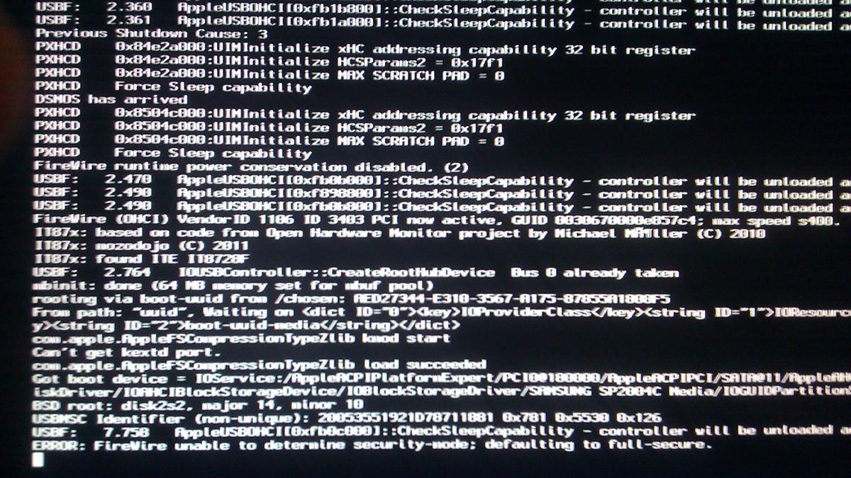

EvilMacMongo Posted March 22, 2012 Author Share Posted March 22, 2012 Issue on update. ok well I updated to the combo 10.6.7 and I can get the kernel to load using the test7 kernel but I run back into the USB problem where I had to copy the *ATA* directory off the SL install. Doesn't work this time. Any ideas on a fix? Link to comment Share on other sites More sharing options...
ZØØT Posted March 22, 2012 Share Posted March 22, 2012 Are you OC'd? Try running your machine at stock values if you are. Link to comment Share on other sites More sharing options...
EvilMacMongo Posted March 22, 2012 Author Share Posted March 22, 2012 why would being oc'd effect the usbf? Link to comment Share on other sites More sharing options...
