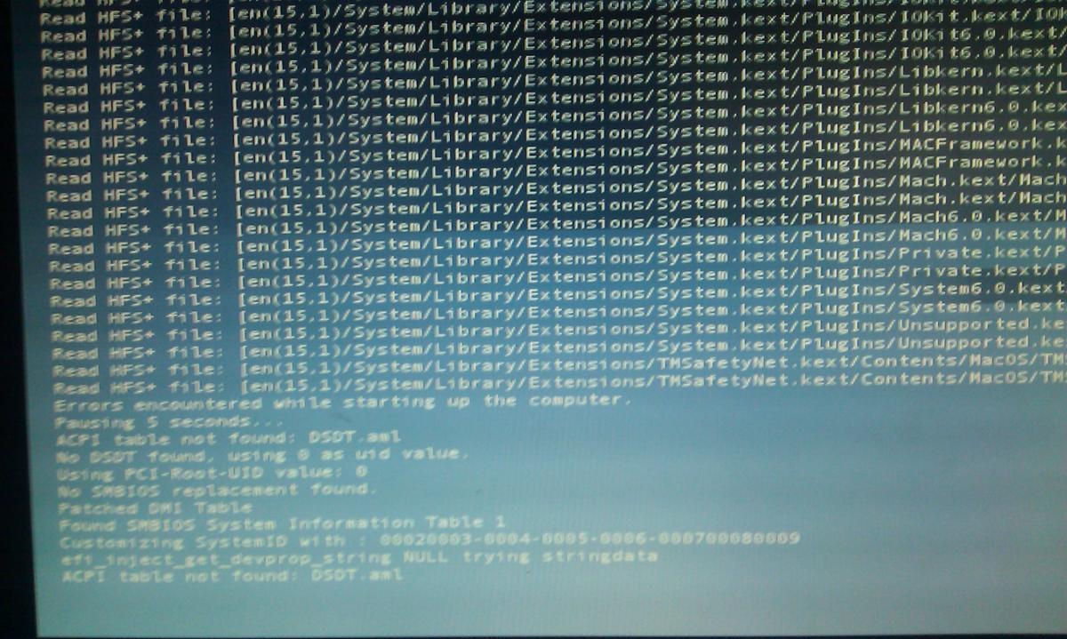

EvilMacMongo Posted February 16, 2012 Share Posted February 16, 2012 Ok I've been trying this for a few days. tried a few different distro's. hazard went the farthest, with booting -x -v I can get most of the hfs+ files to load through chameleon but it errors on the tmsafetynet.kext, pauses 5 seconds, displays: ACPI table not found. Dsdt.aml No DsDt found, using 0 as uid value Using PCI-root-uid value:0 No SMbios replacement Patched DMI table found SMbios system information Table 1 customizing systemID with 002-003-004-005-006007008009 efi_inject_get_devprp_string NULL trying stringdata Then it has another ACPI and reboots. System is Fx-4100 cpu, ta990fxe mb, radeon hd 6770 gpu, 8 gig corsair 1600 dual channel ram, seagate 250 gig sata 6.0gbs hdd. Please help a brother out Link to comment https://www.insanelymac.com/forum/topic/275953-maybe-some-help/ Share on other sites More sharing options...

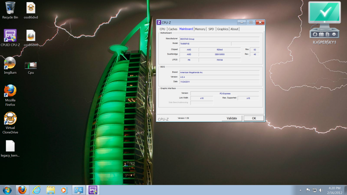

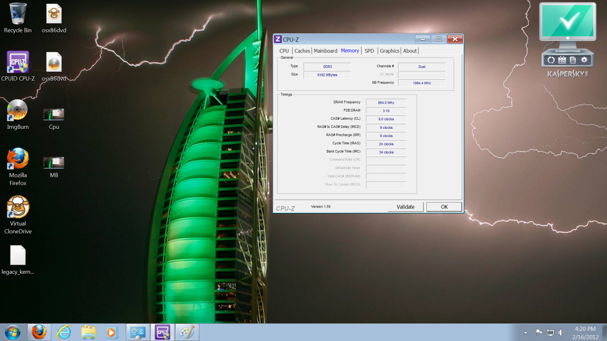

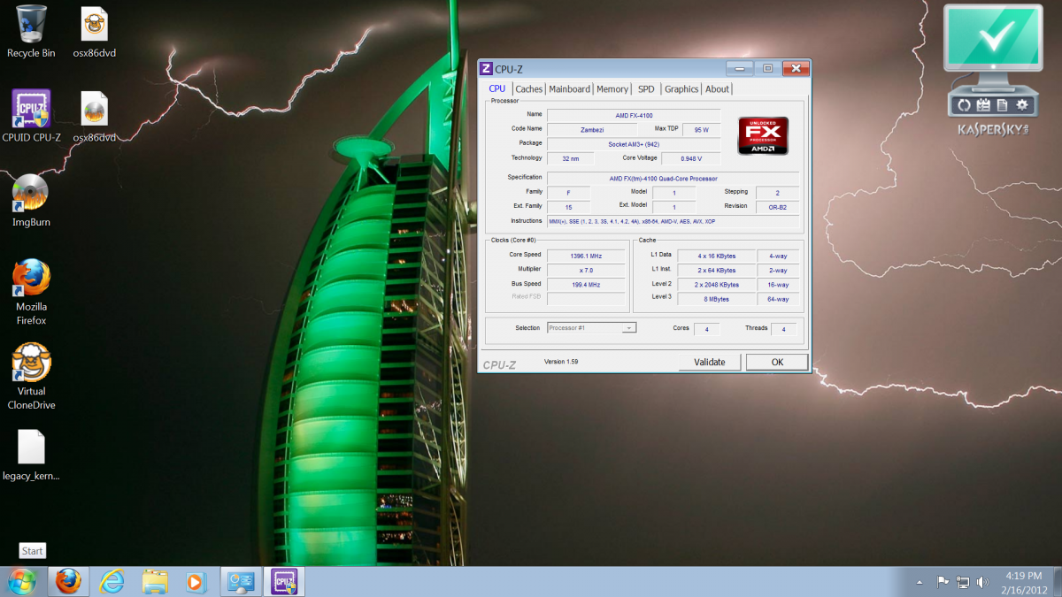

EvilMacMongo Posted February 17, 2012 Author Share Posted February 17, 2012 Here are shots from cpu-z......could it possibly have anything to do with the bulldozer architecture supporting sse3 as intel chips do. The hazard distro i'm using only seems to have Mach_kernel. Link to comment https://www.insanelymac.com/forum/topic/275953-maybe-some-help/#findComment-1797032 Share on other sites More sharing options...

Foxic Posted February 21, 2012 Share Posted February 21, 2012 Try using a 10.6.3 Snow Leopard retail disk with Nawcom's ModCD. This will give you a 'vanilla' (un-bastardised) install. This will be much easier to support as we know what goes on during the install. By using a distro like Hazard you are at the whim of the authors as to which kexts are patched/installed and to where. A distro may look like the easy option but I promise you it is not. There is a very steep learing curve with OS X 86 and this is where most seem to be put off. But if you stick with it, read as much as you can and don't be affraid to experiment, you should get there eventually. Link to comment https://www.insanelymac.com/forum/topic/275953-maybe-some-help/#findComment-1799187 Share on other sites More sharing options...

Foxic Posted March 4, 2012 Share Posted March 4, 2012 Just use dsdt editor in OS X to extract your dsdt Link to comment https://www.insanelymac.com/forum/topic/275953-maybe-some-help/#findComment-1802972 Share on other sites More sharing options...

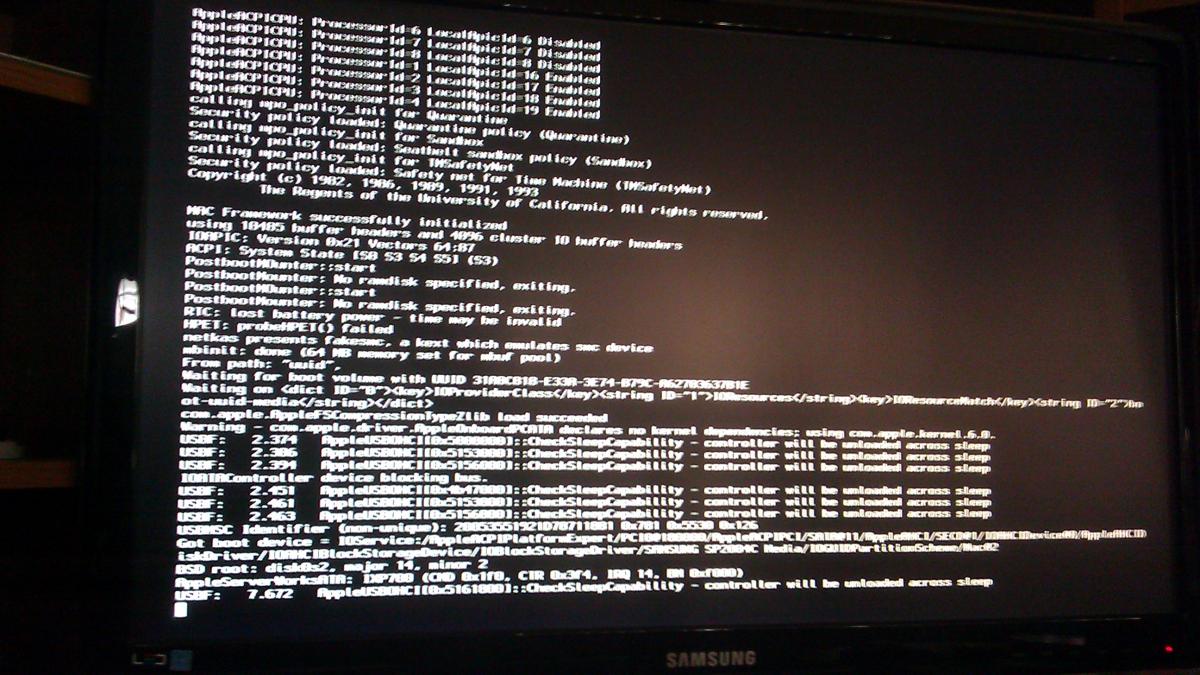

EvilMacMongo Posted March 17, 2012 Author Share Posted March 17, 2012 Gringo: I did try to disable firewire and same thing, On one boot it actually said waiting for root device. but the rest it just freezes. I just tried copying the ata kexts from the install dvd to the hard drive through terminal and that didn't seem to help either. Zoot: Yes I have 10.5.5 installed through vmware 8.0.1. I cant seem to get the permission to access a physical drive though. I keep getting an error and I have been trying to work around that so no dice on editing any files through the virtual machine. As for the installs I have 3 HDDs. My main is a 1.5tb WD I have that in 3 partations, 1 for win 7, 1 for data files, 1 for ubuntu. the second drive is a seagate 250gb that has win 8 on it, and the 3rd is a samsung 200gb that I have 1 partition for mac osx. My SL install is on a 8gb usb. Did I answer all your questions? Edit: Whatever device it is sticking on, the numbers may flucuate but the IRQ address is alway 14. How do I find out what this is? This is where it sticks, this is even after copying the ata kexts. and I must us the command rd(0,0)/extra/modbin_kernel or anything else reboots FYI to copy the kexts I loaded the boot usb and used terminal and used : cp -pr /Volumes/Snow/System/Library/Extensions/*ATA* /Volumes/Mac/System/Library/Extensions/ chown -R root:wheel /Volumes/Mac/System/Library/Extensions/*ATA* chmod -R 775 /Volumes/Mac/System/Library/Extensions/*ATA* rm -rf /Volumes/Mac/System/Library/Extensions.* then rebooted with -f Link to comment https://www.insanelymac.com/forum/topic/275953-maybe-some-help/#findComment-1806438 Share on other sites More sharing options...
EvilMacMongo Posted March 18, 2012 Author Share Posted March 18, 2012 ok after doing some digging I see what is causing my issue, just not sure how to fix yet. The appleserverworksATA is trying to access my IDE ATA/ATAPI controllers. That has the IRQ of 14 and that seems to be responsible for the hang up. Seems to have to do with the SB controller. Since, in the pic u can see that it is ixp700, giving this issue, it has something to do with the sb700 support on my MB. now my board will go up to 950SB so any ideas on how to correct this so I get rid of my hang? Link to comment https://www.insanelymac.com/forum/topic/275953-maybe-some-help/#findComment-1806601 Share on other sites More sharing options...
EvilMacMongo Posted March 18, 2012 Author Share Posted March 18, 2012 After playing around with the bios settings and my sata control I notice I have 4 options to choose from, native ide, raid, ahci, legacy ide. Now on ahci it sticks on the appleseverworksata, under legacy ide it makes it past the appleserverworksata but the next line in ATI ATA and it sticks there, same on native ide, and didn't even bother with raid mode, also it will allow me to enable or disable combined ide, with legacy ide and combined ide disabled, my cdrom does not load. Also a side note, now when I was just playing somehow instead of my boot menu from BCD that gives me win 7, win 8, ubuntu, and osx option has now been replaced with the chameleon bootloader and I have to select my win 7 drive to get back to my main bootloader. What would cause that? I was just playing with the sata controls in bios? Link to comment https://www.insanelymac.com/forum/topic/275953-maybe-some-help/#findComment-1806609 Share on other sites More sharing options...
Gringo Vermelho Posted March 18, 2012 Share Posted March 18, 2012 Don't use two different drivers for the same hardware at the same time. Link to comment https://www.insanelymac.com/forum/topic/275953-maybe-some-help/#findComment-1806612 Share on other sites More sharing options...
EvilMacMongo Posted March 18, 2012 Author Share Posted March 18, 2012 Success!!!!! IT BOOTED!!!!!!!!!!!! Ok so what I had to do.......The good, the bad, and the dirty. Reloaded the install usb, deselected every option on the customize screen except under chipset. I did not pick the atiata that it auto selected, it was the one down on the list for ati. After successful install, did not restart, opened terminal, copied all the kexts from the install usb, gave permission, rebooted modcd, typed rd(0,0)/extra/modbin -v -f. SUCCESS!!!!!!!!!!!! now I just gotta get everything else working.....but I got it to boot Link to comment https://www.insanelymac.com/forum/topic/275953-maybe-some-help/#findComment-1806634 Share on other sites More sharing options...
