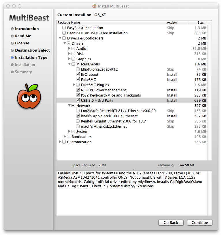

SimonLL Posted September 24, 2012 Share Posted September 24, 2012 @xxxhonyy For sound I followed joshhh guide. I'm using the patched AppleHDA.kext that I had in 10.8.0 and the DSDT edit he mentionned in this thread in the post right above mine. For the SD card reader, I use VoodooSDHC kext. I've attached both kexts. EDIT: The WiFi cards provided by Lenovo are not compatible with OSX. I don't have WiFi for now, but I'm looking to get a usb WiFi adapter that works with OSX. The one I'm looking at is the Asus USB-N10. When I get confirmation that it works in ML, I'm buying it and will finally have all the features of my computer in order. AppleHDA.kext-cx20590.zip VoodooSDHC.kext.zip Link to comment https://www.insanelymac.com/forum/topic/273621-guide-os-x-lion-on-thinkpad-w520/page/4/#findComment-1855249 Share on other sites More sharing options...
xxxhonyy Posted September 24, 2012 Share Posted September 24, 2012 Hi Simon, I'm really sorry to trouble you again with this but my osx86 ended up belly up and i cant start it up and restoring again would you do me a massive favour and explain me a bit more in details how you have done it, what tools did you use? I'm trying to apply what you say on Gothic's guide.. but i've probably misunderstood something and so i keep breaking my system over and over. Did you use ##### at all? (what setting?) how did you get your smbios.info and the othe info file to the system? I'm sure you know this but you can get a replacement for your internal wifi card that's suppose to work (one with atheros chipset listed here / ebay - 5$) Is your USB3.0 working as well? The webcamera? Tom Link to comment https://www.insanelymac.com/forum/topic/273621-guide-os-x-lion-on-thinkpad-w520/page/4/#findComment-1855525 Share on other sites More sharing options...
