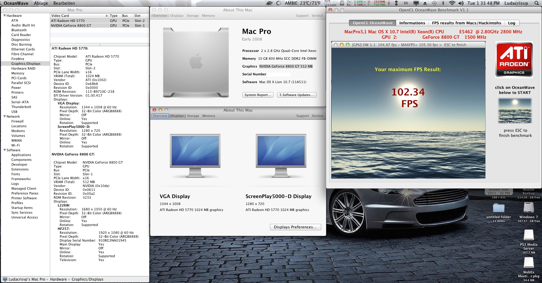

ludacrisvp Posted November 15, 2011 Share Posted November 15, 2011 Hello, As you can see there is no way to select the GPU to use for this test. In Slot-1 I have the stock 8800GT and in Slot-2 I have a XFX flashed 5770 card. In different places it sees one card and another in the other places. MacPro3,1 Mac OS X 10.7 Intel® Xeon® CPU E5462 @ 2.80GHz 2800 MHz GPU 2: GeForce 8800 GT 1500 MHz Mac OS X 10.7 RESULT: FPS= 102.34 OpenGL Extensions Viewer 4.0 has no issues in changing rendering device. Link to comment https://www.insanelymac.com/forum/topic/268209-opencl-oceanwave-bench-and-new-compubench-cl/page/5/#findComment-1770975 Share on other sites More sharing options...
mitch_de Posted November 16, 2011 Author Share Posted November 16, 2011 Yepp, GPU card selection isnst implemented in that version - maybe in V1.2 Link to comment https://www.insanelymac.com/forum/topic/268209-opencl-oceanwave-bench-and-new-compubench-cl/page/5/#findComment-1771048 Share on other sites More sharing options...

ludacrisvp Posted November 16, 2011 Share Posted November 16, 2011 Yepp, GPU card selection isnst implemented in that version - maybe in V1.2 Cool, not sure how hard that will be for you to code. Might you have any thoughts as to why some parts of OSX see the 8800GT and others see the 5770? 10.7.3 11D16same hardware as before... Now can you do a comparison to the MP3,1 value? Link to comment https://www.insanelymac.com/forum/topic/268209-opencl-oceanwave-bench-and-new-compubench-cl/page/5/#findComment-1771189 Share on other sites More sharing options...

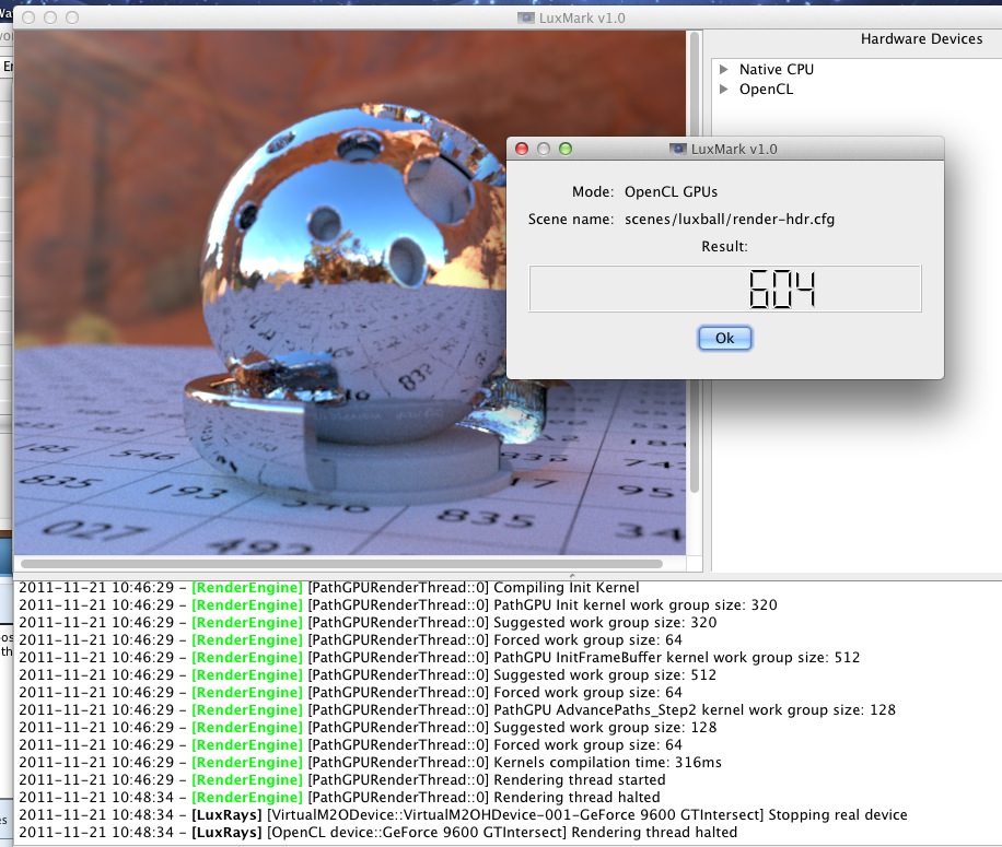

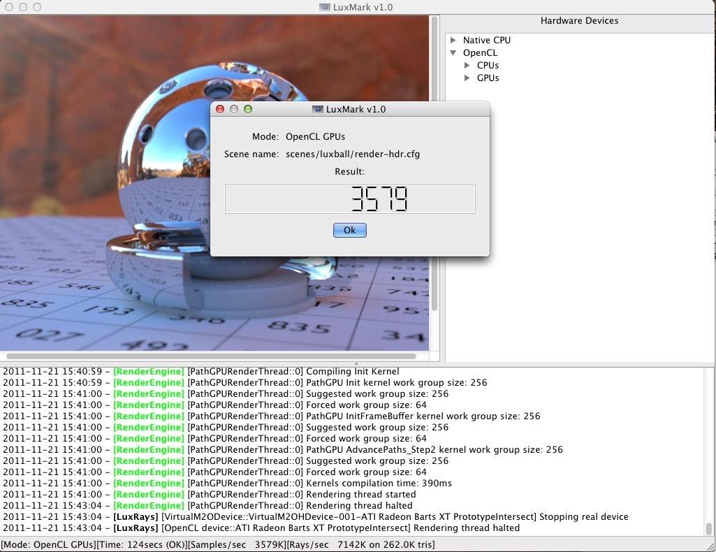

mitch_de Posted November 21, 2011 Author Share Posted November 21, 2011 Added LUXMARK (OpemCL Benchmark) info + dl Link + result link on first posting. LUXMARK can bench ALL OpenCL gpus - if you have more than one (and both not lowend) , maybe interesting. It has much higher CPU usage (beside OpenCL) / load so cpu speed does matter compared to OceanWave with very less cpu loads. To get close to the luxmark HEROs you need 8 * GTX 580 for results around 70000! Link to comment https://www.insanelymac.com/forum/topic/268209-opencl-oceanwave-bench-and-new-compubench-cl/page/5/#findComment-1772289 Share on other sites More sharing options...
HFW Posted November 21, 2011 Share Posted November 21, 2011 HACKINTOSH MacPro5,1 Mac OS X 10.7.2 Intel® Core i7 CPU 920 @ 2.67GHz 3500 MHz GPU ATI Radeon Barts XT Prototype 930 MHz FPS= 386.16 (AMD Radeon HD 6870) LuxMark: 8 * GTX 580? who needs that much power? o.o Link to comment https://www.insanelymac.com/forum/topic/268209-opencl-oceanwave-bench-and-new-compubench-cl/page/5/#findComment-1772388 Share on other sites More sharing options...
