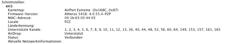

iLeopod Posted August 7, 2011 Share Posted August 7, 2011 I have the Atheros AR5BXB72 (full Size with there antenna connectors) I get Airdrop after adding pci168c,24 to AirPortAtheros40.kext. This seems also possible for Atheros AR5B95 /pci168c,2b. Link to comment https://www.insanelymac.com/forum/topic/259592-airdrop-wifi-compatible-cards/page/2/#findComment-1730905 Share on other sites More sharing options...
splonk Posted August 7, 2011 Share Posted August 7, 2011 I have the Atheros AR5BXB72 (full Size with there antenna connectors)I get Airdrop after adding pci168c,24 to AirPortAtheros40.kext. This seems also possible for Atheros AR5B95 /pci168c,2b. Interesting. I take it this is a third party card? This did not work for me with a genuine card in my MB or MBP. If I added it to Atheros40 and removed it from Atheros21 I just lost Airport. Link to comment https://www.insanelymac.com/forum/topic/259592-airdrop-wifi-compatible-cards/page/2/#findComment-1730910 Share on other sites More sharing options...
iLeopod Posted August 7, 2011 Share Posted August 7, 2011 Dont remove the id from Atheros21.kext. I use a Apple card. Link to comment https://www.insanelymac.com/forum/topic/259592-airdrop-wifi-compatible-cards/page/2/#findComment-1730916 Share on other sites More sharing options...
splonk Posted August 7, 2011 Share Posted August 7, 2011 OK, just tried this. Airport is up but cannot locate any signals. Only the Atheros21.kext seems to load. Link to comment https://www.insanelymac.com/forum/topic/259592-airdrop-wifi-compatible-cards/page/2/#findComment-1730969 Share on other sites More sharing options...
iLeopod Posted August 7, 2011 Share Posted August 7, 2011 What model you have? Look in IORegistry Explorer. System-profiler shows only the vendor and subsystem id which is the same for many models. Link to comment https://www.insanelymac.com/forum/topic/259592-airdrop-wifi-compatible-cards/page/2/#findComment-1731172 Share on other sites More sharing options...
splonk Posted August 7, 2011 Share Posted August 7, 2011 IORE gives me the hardware version as follows: MacRev: 0x2 PhyRev: 0x81 Radio: 0xc0 Link to comment https://www.insanelymac.com/forum/topic/259592-airdrop-wifi-compatible-cards/page/2/#findComment-1731242 Share on other sites More sharing options...
