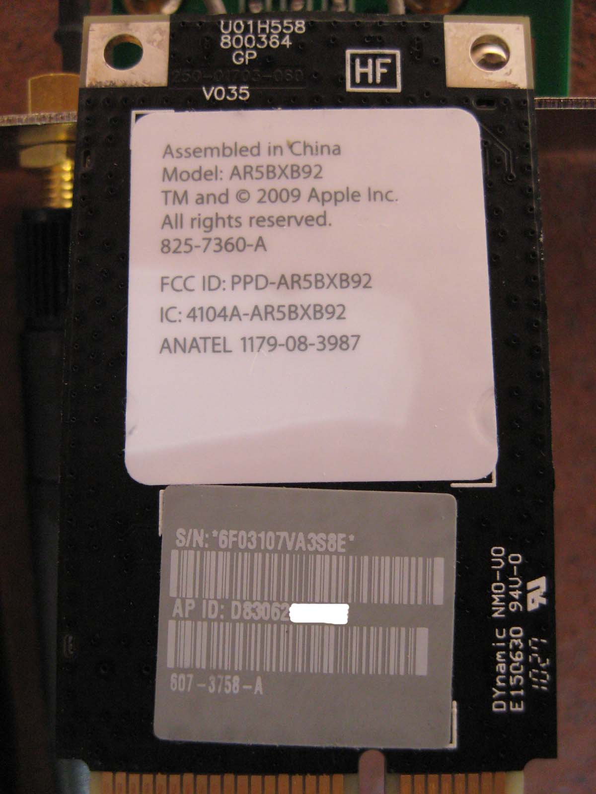

polum Posted August 26, 2011 Share Posted August 26, 2011 This is my card: New Apple Atheros AR9280 AR5BXB92 Mini Pci-e AGN 300Mbp This is the adaptor: mini PCI-E to PCI-E x1 wireless adapter with w antenna My system running Lion 10.7.1 Not runnig at all with IO80211Family.kext 4.0 / 4.1 Need IO80211Family.kext 3.2 to work ! But No Airdrop !!! Versiones de software: CoreWLAN: 2.0 (200.46) CoreWLANKit: 1.0 (100.43) Menú Extra: 7.0 (700.42) Módulo configd: 7.0 (700.57) Perfil de Sistema: 7.0 (700.3) Familia IO80211: 3.2 (320.1) Diagnóstico de Wi-Fi: 1.0 (100.26) Utilidad AirPort: 5.5.3 (553.20) Interfaces: en0: Tipo de tarjeta: AirPort Extreme (0x168C, 0x8F) Versión del firmware: Atheros 9280: 2.1.14.6 Dirección MAC: d8:30:62:xx:xx:xx Configuración regional: FCC Código del país: ES Modos PHY compatibles: 802.11 a/b/g/n Canales admitidos: 1, 2, 3, 4, 5, 6, 7, 8, 9, 10, 11, 12, 13, 36, 40, 44, 48, 52, 56, 60, 64, 100, 104, 108, 112, 116, 120, 124, 128, 132, 136, 140 Wake on Wireless: Compatible Estado: Servicio de red inactivo Could you see any differences with the working one? P2P firmware needed for Airdrop? It´s possible to upgrade firmware? Any help would be great... Thanks Link to comment https://www.insanelymac.com/forum/topic/259592-airdrop-wifi-compatible-cards/page/3/#findComment-1740545 Share on other sites More sharing options...
bulabula2001 Posted August 27, 2011 Share Posted August 27, 2011 Macbidouille has some news via xl8yourmac about which cards are compatible. With regard to the BCM94322MC, you need to make sure you have this ref: 487330-001. With regard to the AR9280, you need to have this model AR5BXB92 AGN. eBay is pot luck as to what you get. Bonne chance a tous. Hi, this worked for me OOTB for the BCM94322MC card. Recognized by Lion as "Third-Party Wireless". Link to comment https://www.insanelymac.com/forum/topic/259592-airdrop-wifi-compatible-cards/page/3/#findComment-1740684 Share on other sites More sharing options...
JBraddock Posted August 29, 2011 Share Posted August 29, 2011 This is my card:New Apple Atheros AR9280 AR5BXB92 Mini Pci-e AGN 300Mbp This is the adaptor: mini PCI-E to PCI-E x1 wireless adapter with w antenna My system running Lion 10.7.1 Not runnig at all with IO80211Family.kext 4.0 / 4.1 Need IO80211Family.kext 3.2 to work ! But No Airdrop !!! Versiones de software: CoreWLAN: 2.0 (200.46) CoreWLANKit: 1.0 (100.43) Menú Extra: 7.0 (700.42) Módulo configd: 7.0 (700.57) Perfil de Sistema: 7.0 (700.3) Familia IO80211: 3.2 (320.1) Diagnóstico de Wi-Fi: 1.0 (100.26) Utilidad AirPort: 5.5.3 (553.20) Interfaces: en0: Tipo de tarjeta: AirPort Extreme (0x168C, 0x8F) Versión del firmware: Atheros 9280: 2.1.14.6 Dirección MAC: d8:30:62:xx:xx:xx Configuración regional: FCC Código del país: ES Modos PHY compatibles: 802.11 a/b/g/n Canales admitidos: 1, 2, 3, 4, 5, 6, 7, 8, 9, 10, 11, 12, 13, 36, 40, 44, 48, 52, 56, 60, 64, 100, 104, 108, 112, 116, 120, 124, 128, 132, 136, 140 Wake on Wireless: Compatible Estado: Servicio de red inactivo Could you see any differences with the working one? P2P firmware needed for Airdrop? It´s possible to upgrade firmware? Any help would be great... Thanks Not sure if it would make any difference but here is the firmware version on iMac11,1. (This might later have been updated.) Card Type: AirPort Extreme (0x168C, 0x8F) Firmware Version: Atheros 9280: 2.1.8.11 The one I am using (HP Atheros 9280): AirPort Extreme (0x168C, 0x8F) Firmware Version: Atheros 9280: 4.0.55.4-P2P Link to comment https://www.insanelymac.com/forum/topic/259592-airdrop-wifi-compatible-cards/page/3/#findComment-1741653 Share on other sites More sharing options...
