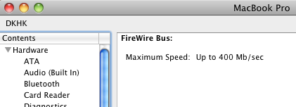

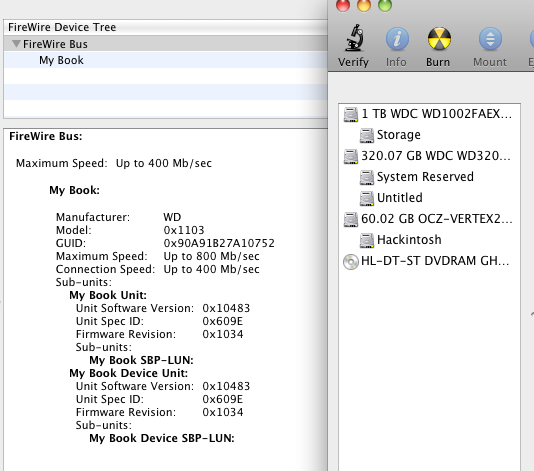

Hi Andy,
Everything is working like a charm except for eSata and Firewire. The eSata I can't really trust because I only have one drive that supports it and I've never actually used the feature (reading up about this particular WD drive seems to return a lot of people with problems accessing the eSata feature.) The firewire on the other hand is a different matter. With three tested drives, none of the three mount and it says that it has trouble identifying the drive but in system profiler it says "Firewire Bus: Maximum Speed: Up to 400Mb/sec." It sees the port both under hardware profiler and within the network pref, but I can't get it to work with any drives. Any suggestions? Is there a kext that I'm missing for this to work?
Cheers,
Dave
