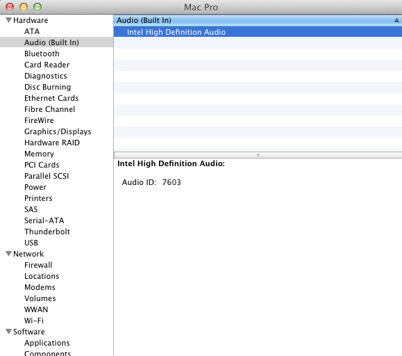

Cyrus the Great Posted August 25, 2011 Share Posted August 25, 2011 this is fully functional voodoohda .for 293E8086 -111D7603-IDT 92HD75B3X5 -autoswitching between headphone and speaker,also between mic -all input output work -volume change and mute work perfect -fix no sound after sleep problem that i had with Applehda if you get noise from mic install included prefpane and decrease the recording level replace your hdef device on your dsdt with thisafter adding it no need to delete applehda Device (HDEF) { Name (_ADR, 0x001B0000) Name (_S3D, 0x03) Name (RID, Zero) Name (_PRW, Package (0x02) { 0x05, 0x04 }) Method (_PSW, 1, NotSerialized) { Noop } } Archive.zip Link to comment https://www.insanelymac.com/forum/topic/250849-guide-mammoth-method-v200-hp-dvx-106x-fast-easy-comprehensive-installation-new-mammoth-boot-cd-for-i5-i3/page/33/#findComment-1740085 Share on other sites More sharing options...

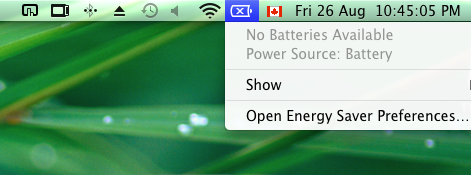

pablo101 Posted August 26, 2011 Share Posted August 26, 2011 I confirm what oskr66 says.This is my first comment on this site. I successfully installed snow leopard using mammoth method, and then I installed Lion, and updated to 10.7.1, using oskr66 DSDT, and the last mach_kernel posted here. Everything works perfectly, but 2 things. The first is the graphics enabler has to be Yes for the time being, and when I boot lion, it boots too many hfs files. One advice to the new people here. if you want to update the chameleon, all you have to to is to use the Chameleon Wizzard, find a new chameleon version (I installed r1447 (if I remember correctly), and you will not need to write any commands in the terminal... It will all be automatic. Since my pc-hac is the same as that of mammoth, oscr66 and pablo101, I think that a help to fix the graphics enabler thing by knowledgeable taptun or somebody else will be something great! At startup to prevent the cache reloading extensions every time you need to make cache command to create a cache. There are specific steps for Lion to do this. You then need to enable quiet boot without verbose mode. Mine boots much faster now Just going to upgrade to 10.7.1 after the break! Link to comment https://www.insanelymac.com/forum/topic/250849-guide-mammoth-method-v200-hp-dvx-106x-fast-easy-comprehensive-installation-new-mammoth-boot-cd-for-i5-i3/page/33/#findComment-1740444 Share on other sites More sharing options...
kurtosavros Posted August 26, 2011 Share Posted August 26, 2011 At startup to prevent the cache reloading extensions every time you need to make cache command to create a cache. There are specific steps for Lion to do this. You then need to enable quiet boot without verbose mode. Mine boots much faster now Just going to upgrade to 10.7.1 after the break! Hello pablo101. Thanks for your reply. although I am quite noob I somewhat understood what you said. I will try to do what you said. Though, what I am mostly concerned with is to be able to have a DSDT where there is no need for the graphics enabler to be yes. If you guys resolve this issue, I will be very grateful. Link to comment https://www.insanelymac.com/forum/topic/250849-guide-mammoth-method-v200-hp-dvx-106x-fast-easy-comprehensive-installation-new-mammoth-boot-cd-for-i5-i3/page/33/#findComment-1740496 Share on other sites More sharing options...
