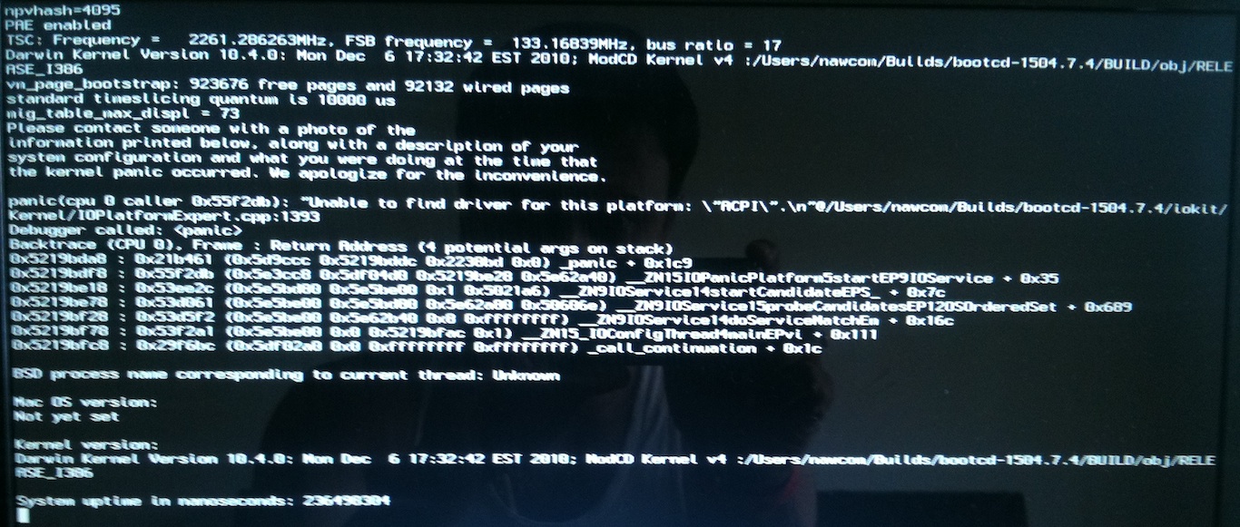

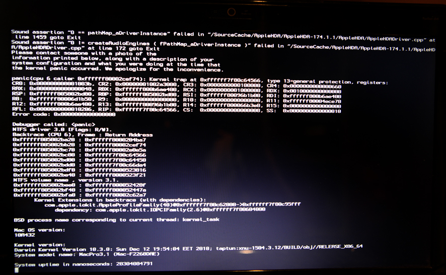

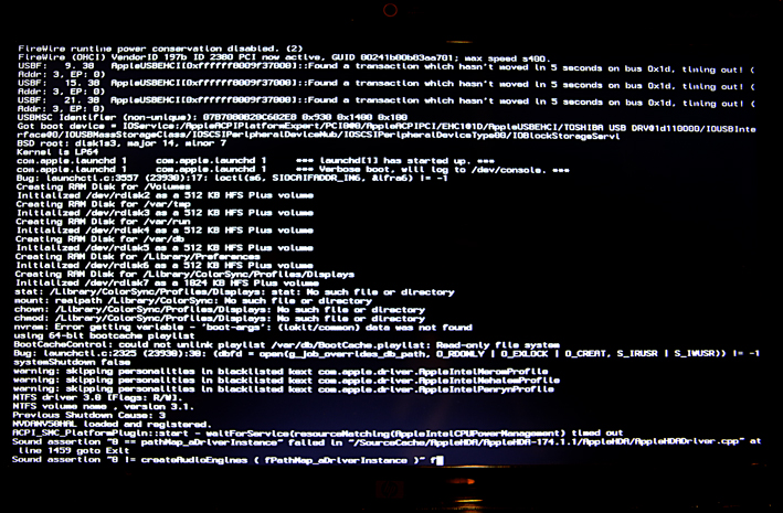

adam_ar Posted September 30, 2011 Share Posted September 30, 2011 Hi, I am following the version 2.0 guide mentioned in post 1 of this topic to install Mac OS X on HP Pavilion DV6. Specs in my signature. I am using an 8GB flash drive with 2 partitions. I used the Snow Leopard retail DVD 10.6.3. I tried the generic (MIIF_DVx-Generic_v2.00.03.dmg) as well as the generic i5i3 (MIIF_DVx_i5i3-Generic_v2.00.03.dmg) MIIF. I keep getting "Still waiting for root device" when booting without any flags. And when I use flags like -v -x -f, the installer proceeds further. But asks me to restart with the error "Mac OS X cannot be installed on this computer", after choosing the language. I am unable to attach dsdt and dsdt.dsl that were extracted using Linux live cd on the HP DV6. I still uploaded the dmesg from linux live cd on HP DV6. EDIT: Uploaded the acpi dump as per instructions at http://www.insanelymac.com/forum/index.php?showtopic=215844 Please let me know how to proceed or any other things I can try. HP_dmesg.txt ACPI_Tables_2011_09_30_13_46.zip Link to comment https://www.insanelymac.com/forum/topic/250849-guide-mammoth-method-v200-hp-dvx-106x-fast-easy-comprehensive-installation-new-mammoth-boot-cd-for-i5-i3/page/38/#findComment-1754600 Share on other sites More sharing options...

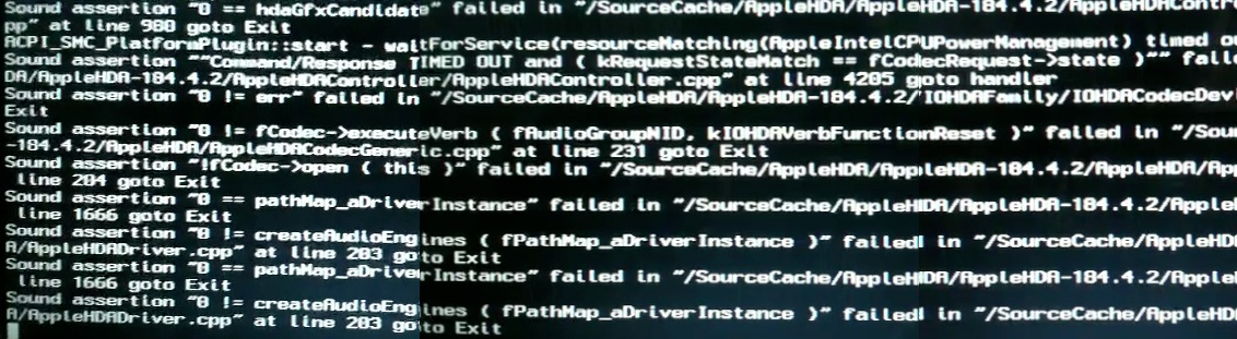

Taptun Posted September 30, 2011 Share Posted September 30, 2011 Any ideas about what i asked a few posts behind about IDT Audio? Cheers. Hi If you have a working AppleHDA from 10.6.x, use it @Taptun Link to comment https://www.insanelymac.com/forum/topic/250849-guide-mammoth-method-v200-hp-dvx-106x-fast-easy-comprehensive-installation-new-mammoth-boot-cd-for-i5-i3/page/38/#findComment-1754704 Share on other sites More sharing options...
Komano Posted October 1, 2011 Share Posted October 1, 2011 Hi If you have a working AppleHDA from 10.6.x, use it @Taptun Semi working, But i'll try. Link to comment https://www.insanelymac.com/forum/topic/250849-guide-mammoth-method-v200-hp-dvx-106x-fast-easy-comprehensive-installation-new-mammoth-boot-cd-for-i5-i3/page/38/#findComment-1754844 Share on other sites More sharing options...
adam_ar Posted October 1, 2011 Share Posted October 1, 2011 Hi . try it Adam_A_R_1.zip @Taptun Hi Taptun, appreciate your sooper quick reply. Thanks. Its kind of inviting "RTFM" or "STFF" comments. But could you help me with what I am supposed to do with the contents of the zip file? A link to a post/article would be great! EDIT: I copied the files smbios.plist, DSDT.aml and org.chameleon.Boot.plist to the /Extra folder on the MIID volume. When I booted using this setup, there was some output and then the machine rebooted itself. The behaviour was same even when I used -v -x -f flags. I have also uploaded the screenshot of last frame before reboot. Also, strange thing to note is that the existing smbios.plist on MIID was named SMBIOS.plist. Hello! First of all. Do you have Windows installed on to your computer? If you do, could you do this. Start -> Run -> msinfo32.exe -> File -> Export -> Report.txt and then upload that to somewhere? It'll take awhile to generate. If you don't have windows, do a "lspci -nn" on Linux and paste that here. Next question is, When you try to install OS X What is your drive partitioned to? Is it the GUID Partition Table or MBR? I'm not too sure about this OS X cannot be installed but i'll try to help you as beast as i can. Sorry if it seems like im asking repetitive questions. I just need to make sure. Hi Komano, Thanks for the reply. I *had* windows. I attempted an OSX install using a method mentioned elsewhere. I partitioned the HDD with GUID partition table. Install was ok. Could boot into the installation using the boot cd. Of course, no Ethernet, no WiFi, no 1366x768 resolution, etc. didnt try sleep/suspend. But sound was working OOTB. And then, I could not boot into the installation after upgrade to 10.6.7 and some auto-patching using a method specified elsewhere. Even with the boot cd I could not boot into OSX. After that I found this topic which deals specifically with HP Pavilion DV6 which I am using. So, started afresh. Well, another thing I could try, is to format the HDD using Ubuntu LiveCD and retry. Any suggestions as to: - keep the GUID partition table or switch to MBR - File System to use? not sure if Ubuntu can format drive using that used by Mac OSX. Link to comment https://www.insanelymac.com/forum/topic/250849-guide-mammoth-method-v200-hp-dvx-106x-fast-easy-comprehensive-installation-new-mammoth-boot-cd-for-i5-i3/page/38/#findComment-1754853 Share on other sites More sharing options...

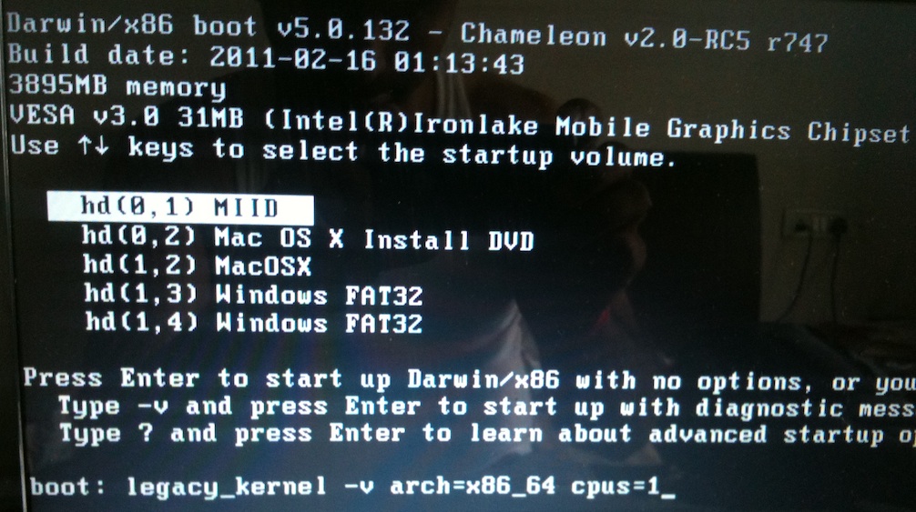

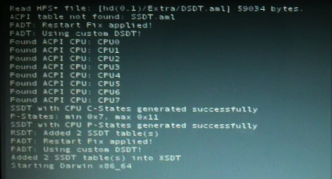

adam_ar Posted October 1, 2011 Share Posted October 1, 2011 Yes i do. However, an i3-350m shouldn't have any issues with OS X actually. What version of Chameleon are you on? As per my boot screen Darwin/x86 boot v5.0.132 - Chameleon v2.0-RC5 r747 Link to comment https://www.insanelymac.com/forum/topic/250849-guide-mammoth-method-v200-hp-dvx-106x-fast-easy-comprehensive-installation-new-mammoth-boot-cd-for-i5-i3/page/38/#findComment-1755023 Share on other sites More sharing options...
Komano Posted October 1, 2011 Share Posted October 1, 2011 Woopsie, Seemed to have missed that. EDIT: Actually, Your bootscreen doesn't have that line. It's before. Try the latest builds. http://builds.voodooprojects.org/builds/Xcode4.1/ Link to comment https://www.insanelymac.com/forum/topic/250849-guide-mammoth-method-v200-hp-dvx-106x-fast-easy-comprehensive-installation-new-mammoth-boot-cd-for-i5-i3/page/38/#findComment-1755033 Share on other sites More sharing options...

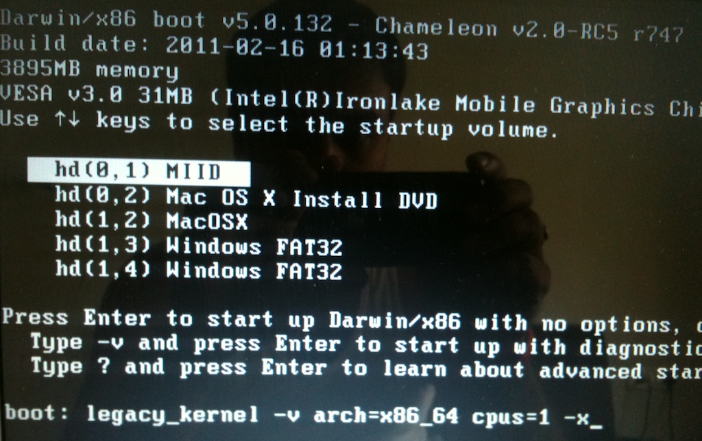

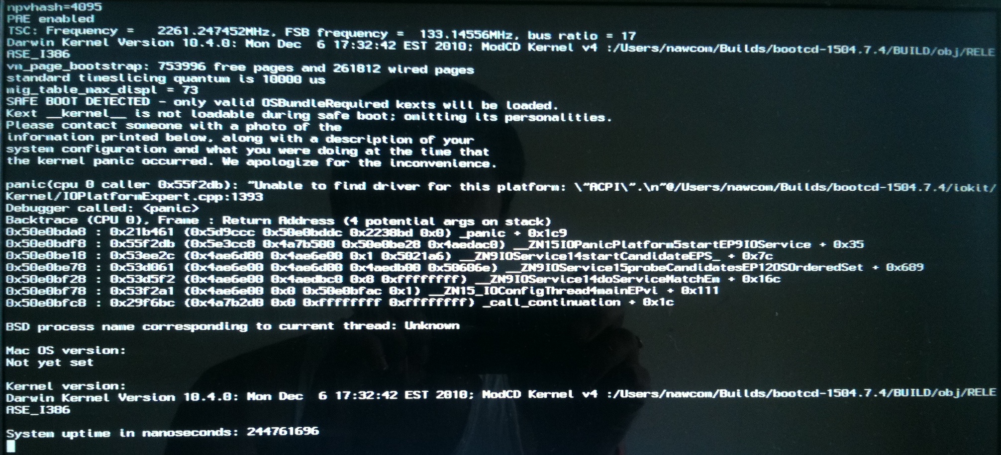

adam_ar Posted October 1, 2011 Share Posted October 1, 2011 Woopsie, Seemed to have missed that. EDIT: Actually, Your bootscreen doesn't have that line. It's before. Try the latest builds. http://builds.voodooprojects.org/builds/Xcode4.1/ Komano, of course, the screenshot attached does not have it! sorry if my statement appeared that way. what i meant was "from the boot screen that appears on my laptop"! Also, do I just replace my MIID's Extra and usr folders with contents from the archive file from the url? or do I have to do some command-line magic? if so, appreciate if you could point me to the right link/post/article. and thanks a lot for your replies... its good to know that someone out there is helping in-spite of all the deadlines/time crunch. EDIT: something like below? ~ > cd /Volumes/MIID/usr/standalone/i386 /Volumes/MIID/usr/standalone/i386 > ../../bin/fdisk440 -f boot0hfs -uy /dev/rdisk2 /Volumes/MIID/usr/standalone/i386 > dd if=boot1h of=/dev/rdisk2s1 /Volumes/MIID/usr/standalone/i386 > cp boot /Volumes/MIID/ Link to comment https://www.insanelymac.com/forum/topic/250849-guide-mammoth-method-v200-hp-dvx-106x-fast-easy-comprehensive-installation-new-mammoth-boot-cd-for-i5-i3/page/38/#findComment-1755051 Share on other sites More sharing options...
adam_ar Posted October 1, 2011 Share Posted October 1, 2011 Komano, of course, the screenshot attached does not have it! sorry if my statement appeared that way. what i meant was "from the boot screen that appears on my laptop"! Also, do I just replace my MIID's Extra and usr folders with contents from the archive file from the url? or do I have to do some command-line magic? if so, appreciate if you could point me to the right link/post/article. and thanks a lot for your replies... its good to know that someone out there is helping in-spite of all the deadlines/time crunch. EDIT: something like below? ~ > cd /Volumes/MIID/usr/standalone/i386 /Volumes/MIID/usr/standalone/i386 > ../../bin/fdisk440 -f boot0hfs -uy /dev/rdisk2 /Volumes/MIID/usr/standalone/i386 > dd if=boot1h of=/dev/rdisk2s1 /Volumes/MIID/usr/standalone/i386 > cp boot /Volumes/MIID/ Hi, I recreated the MIID partition on my thumbdrive. Then executed the following: mv /Volumes/MIID/Extra /Volumes/MIID/Extra.old cp -r ~/research/Mammoth/Chameleon-2.0-RC5-r1252/Extra /Volumes/MIID cp -r ~/research/Mammoth/Chameleon-2.0-RC5-r1252/usr /Volumes/MIID cp ~/Downloads/Adam_A_R_1/DSDT.aml /Volumes/MIID/Extra cp ~/Downloads/Adam_A_R_1/smbios.plist /Volumes/MIID/Extra cp ~/Downloads/Adam_A_R_1/org.chameleon.Boot.plist /Volumes/MIID /Volumes/MIID/usr/bin/fdisk440 -f /Volumes/MIID/usr/standalone/i386/boot0hfs -uy /dev/rdisk3 dd if=/Volumes/MIID/usr/standalone/i386/boot1h of=/dev/rdisk3s1 mv /Volumes/MIID/boot /Volumes/MIID/boot.original cp /Volumes/MIID/usr/standalone/i386/boot /Volumes/MIID/ chmod o+x /Volumes/MIID/boot I was not able to boot into MIID parition. It always wanted to load the mach_kernel. I got KP when I modified the Boot.plist to load taptun1067_kernel and the taptun1063_kernel. Same with legacy_kernel. I tried the following boot flags to no avail: arch=i386 cpus=1 cpus=1 -v cpus=1 busratio=20 cpus=1 busratio=20 -v cpus=1 busratio=20 -v -x cpus=1 busratio=20 -v -x -f I have attached the KP screen photo. Link to comment https://www.insanelymac.com/forum/topic/250849-guide-mammoth-method-v200-hp-dvx-106x-fast-easy-comprehensive-installation-new-mammoth-boot-cd-for-i5-i3/page/38/#findComment-1755097 Share on other sites More sharing options...
Komano Posted October 1, 2011 Share Posted October 1, 2011 Hi, I recreated the MIID partition on my thumbdrive. Then executed the following: mv /Volumes/MIID/Extra /Volumes/MIID/Extra.old cp -r ~/research/Mammoth/Chameleon-2.0-RC5-r1252/Extra /Volumes/MIID cp -r ~/research/Mammoth/Chameleon-2.0-RC5-r1252/usr /Volumes/MIID cp ~/Downloads/Adam_A_R_1/DSDT.aml /Volumes/MIID/Extra cp ~/Downloads/Adam_A_R_1/smbios.plist /Volumes/MIID/Extra cp ~/Downloads/Adam_A_R_1/org.chameleon.Boot.plist /Volumes/MIID /Volumes/MIID/usr/bin/fdisk440 -f /Volumes/MIID/usr/standalone/i386/boot0hfs -uy /dev/rdisk3 dd if=/Volumes/MIID/usr/standalone/i386/boot1h of=/dev/rdisk3s1 mv /Volumes/MIID/boot /Volumes/MIID/boot.original cp /Volumes/MIID/usr/standalone/i386/boot /Volumes/MIID/ chmod o+x /Volumes/MIID/boot I was not able to boot into MIID parition. It always wanted to load the mach_kernel. I got KP when I modified the Boot.plist to load taptun1067_kernel and the taptun1063_kernel. Same with legacy_kernel. I tried the following boot flags to no avail: arch=i386 cpus=1 cpus=1 -v cpus=1 busratio=20 cpus=1 busratio=20 -v cpus=1 busratio=20 -v -x cpus=1 busratio=20 -v -x -f I have attached the KP screen photo. Sorry about that. Got distracted even though i saw your post and was looking at Camera Accesories. Okay, I believe that you've figured out your issue and you've solved it. Looking at the Kernel Panic, you're having the exact same issue as one of the people im helping to get OS X onto their Envy. I'm not too sure which issue this is tied to so can i request you to check your bios and make sure the Sata Controller is in AHCI mode, HPET in 64bit mode, Virtualization Enabled, Graphics set to Discrete Graphics. If your bios doesn't have all this, it doesn't matter. But if it does, would you please set them? Could you show me the KP with the legacy kernel? Also, Your DV6 definitely supports 64bit. Could you put the legacy kernel and try "legacy_kernel -v arch=x86_64 cpus=1" then try appending -x. The 10.6.3 Installation definitely needs the legacy kernel. EDIT: Also, is the DSDT in the Extra Folder? I don't know the Acronym's about MIID, MIIX or etc. Since i don't really follow the way Mammoth explains it in his guide. Personally i find it confusing to have so many Acronym's since they aren't really necessary. But i guess its good for beginners. I don't like using two different partitions to do stuff so i usually do it in the same partition. EDIT 2: Any suggestions as to:- keep the GUID partition table or switch to MBR - File System to use? not sure if Ubuntu can format drive using that used by Mac OSX. Woops. Sorry about not answering your questions. 1. Personally i prefer MBR. As i like to Install Windows 7 First then OS X. So i keep MBR and i use MBR patches for the Installation 2. File System to use? for OS X, it's definitely HFS+ ( Mac OS Extended Journaled) and for Windows its NTFS. If you want a great utility for managing the partitions, i would really suggest GParted. I have used it for all sorts of things and its my favourite utility for changing boot flags, partitioning and resizing hard drives. Right, I've decided to go for the lion install from scratch method rather than updating. there's a dv8 dtst which works perfectly for 10.6.x so I'll use that. Is there anything else, audio drivers etc which I should back up? Finally, which guide shall I use to install and will this make my USB stick with sl/cham stuff redundent? Cheers I seemed to have missed your post! You should backup all your kext files. Use MaLd0n's here Yes it will. You'll have to do it all over again. I hope you know how to "mix" guides. Link to comment https://www.insanelymac.com/forum/topic/250849-guide-mammoth-method-v200-hp-dvx-106x-fast-easy-comprehensive-installation-new-mammoth-boot-cd-for-i5-i3/page/38/#findComment-1755102 Share on other sites More sharing options...

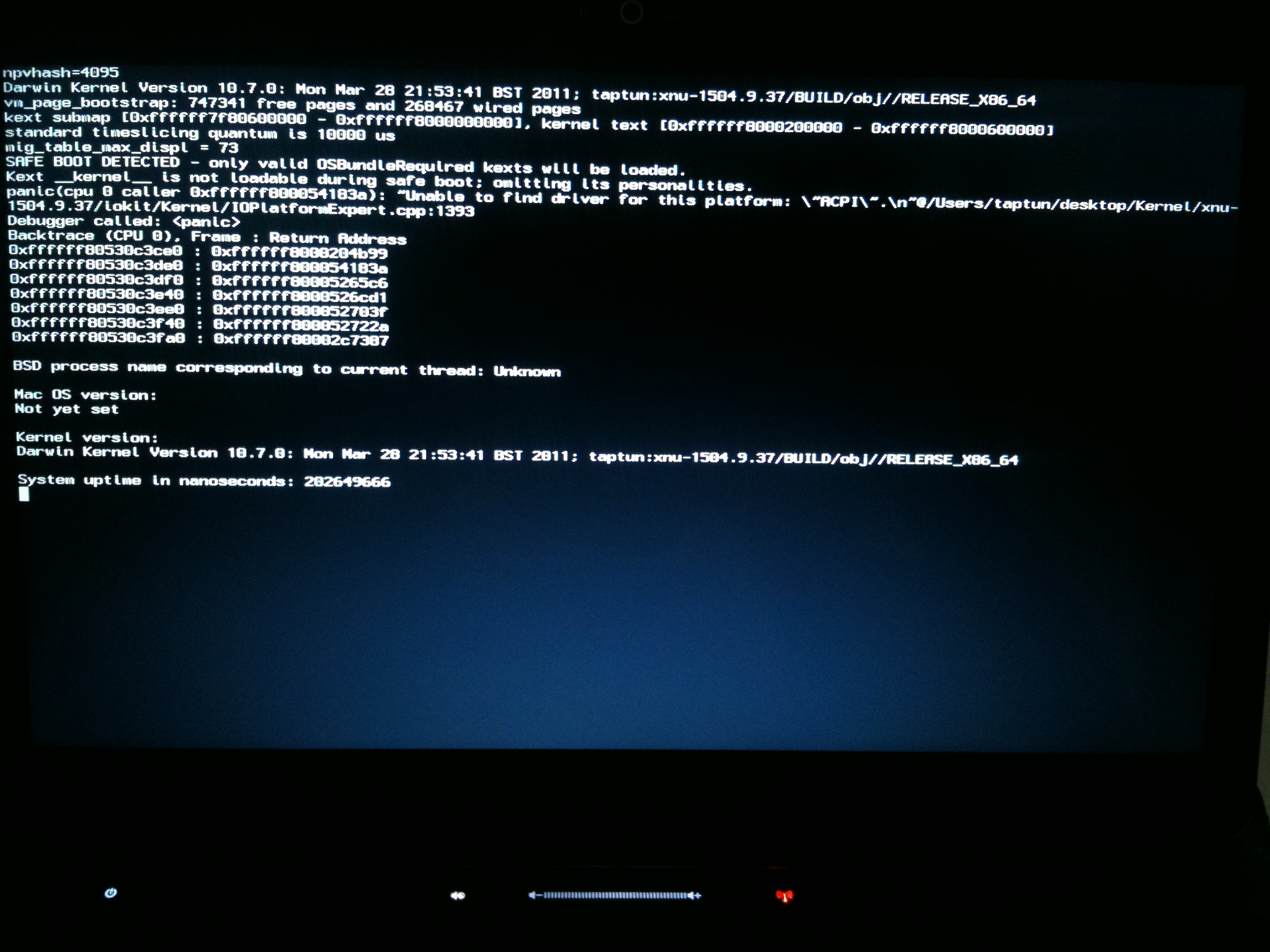

adam_ar Posted October 2, 2011 Share Posted October 2, 2011 Sorry about that. Got distracted even though i saw your post and was looking at Camera Accesories. Okay, I believe that you've figured out your issue and you've solved it. Looking at the Kernel Panic, you're having the exact same issue as one of the people im helping to get OS X onto their Envy. I'm not too sure which issue this is tied to so can i request you to check your bios and make sure the Sata Controller is in AHCI mode, HPET in 64bit mode, Virtualization Enabled, Graphics set to Discrete Graphics. If your bios doesn't have all this, it doesn't matter. But if it does, would you please set them? Could you show me the KP with the legacy kernel? Also, Your DV6 definitely supports 64bit. Could you put the legacy kernel and try "legacy_kernel -v arch=x86_64 cpus=1" then try appending -x. The 10.6.3 Installation definitely needs the legacy kernel. EDIT: Also, is the DSDT in the Extra Folder? I don't know the Acronym's about MIID, MIIX or etc. Since i don't really follow the way Mammoth explains it in his guide. Personally i find it confusing to have so many Acronym's since they aren't really necessary. But i guess its good for beginners. I don't like using two different partitions to do stuff so i usually do it in the same partition. EDIT 2: Woops. Sorry about not answering your questions. 1. Personally i prefer MBR. As i like to Install Windows 7 First then OS X. So i keep MBR and i use MBR patches for the Installation 2. File System to use? for OS X, it's definitely HFS+ ( Mac OS Extended Journaled) and for Windows its NTFS. If you want a great utility for managing the partitions, i would really suggest GParted. I have used it for all sorts of things and its my favourite utility for changing boot flags, partitioning and resizing hard drives. I seemed to have missed your post! You should backup all your kext files. Use MaLd0n's here Yes it will. You'll have to do it all over again. I hope you know how to "mix" guides. Hi Komano, The DSDT.aml file is in the Extra folder of the boot partition. I have skipped the DSDT.dsl file. My InSyde bios lets me change only my boot order and power on password, etc. So cant change anything you mentioned. I have attached the boot and the kernel panic photos with and without -x flag. I am using the DSDT.aml edited by taptun in post#929. I figured that I should be choosing the "Mac OSX Install DVD" partition to boot! instead of the MIID partition. So, I copied the Extra folder to the Mac OSX Install DVD partition and copied the legacy_kernel to the root of this partition. Nevertheless, booting into the "Mac OSX Install DVD" patition, I am not getting KP. Case1: When not using -x flag. The text flows for a few seconds and I get some sound assertions. Then if I wait long enough (couple of minutes) a light bluish gray background is seen with the mouse near the top left corner. After some time the cursor changes to the color wheel and keeps spinning. I waited for a very long time with this (15-20 minutes) without any change. Case2: When using -x flag. behaviour is same as without -x. except that the sound assertions do NOT appear. I have attached the screen capture of the sound assertions and the mouse appearing at the top left hand corner. I too am a photo enthusiast and an amateur photographer. Which forums are you active on for the photography stuff? Link to comment https://www.insanelymac.com/forum/topic/250849-guide-mammoth-method-v200-hp-dvx-106x-fast-easy-comprehensive-installation-new-mammoth-boot-cd-for-i5-i3/page/38/#findComment-1755294 Share on other sites More sharing options...
Komano Posted October 3, 2011 Share Posted October 3, 2011 Hi Komano, The DSDT.aml file is in the Extra folder of the boot partition. I have skipped the DSDT.dsl file. My InSyde bios lets me change only my boot order and power on password, etc. So cant change anything you mentioned. I have attached the boot and the kernel panic photos with and without -x flag. I am using the DSDT.aml edited by taptun in post#929. I figured that I should be choosing the "Mac OSX Install DVD" partition to boot! instead of the MIID partition. So, I copied the Extra folder to the Mac OSX Install DVD partition and copied the legacy_kernel to the root of this partition. Nevertheless, booting into the "Mac OSX Install DVD" patition, I am not getting KP. Case1: When not using -x flag. The text flows for a few seconds and I get some sound assertions. Then if I wait long enough (couple of minutes) a light bluish gray background is seen with the mouse near the top left corner. After some time the cursor changes to the color wheel and keeps spinning. I waited for a very long time with this (15-20 minutes) without any change. Case2: When using -x flag. behaviour is same as without -x. except that the sound assertions do NOT appear. I have attached the screen capture of the sound assertions and the mouse appearing at the top left hand corner. I too am a photo enthusiast and an amateur photographer. Which forums are you active on for the photography stuff? Okay. Good. You should use that DSDT. YES! You should have been choosing that instead of the MIID partition! See what i mean when you have too many partitions then you get confused? . Actually, the Extra Folder and legacy_kernel can stay in the MIID partition but it doesn't matter. GOOD! You shouldn't! I believe the Sound Assertions are from AppleHDA, ignore that for awhile. The mouse appearing on the screen is basically the OS X Installation. Up to this point, there has to be a lot of trial and error and there's not much i can do. Try with GraphicsEnabler=Yes and GraphicsEnabler=No. Update your Boot files and etc. I really think you should try Lion. Has improved? driver support i suppose. I'm usually on ClubSnap but that's for a bit. I'm trying to get my gear together first. I don't even have a bag for my camera. Link to comment https://www.insanelymac.com/forum/topic/250849-guide-mammoth-method-v200-hp-dvx-106x-fast-easy-comprehensive-installation-new-mammoth-boot-cd-for-i5-i3/page/38/#findComment-1755544 Share on other sites More sharing options...
