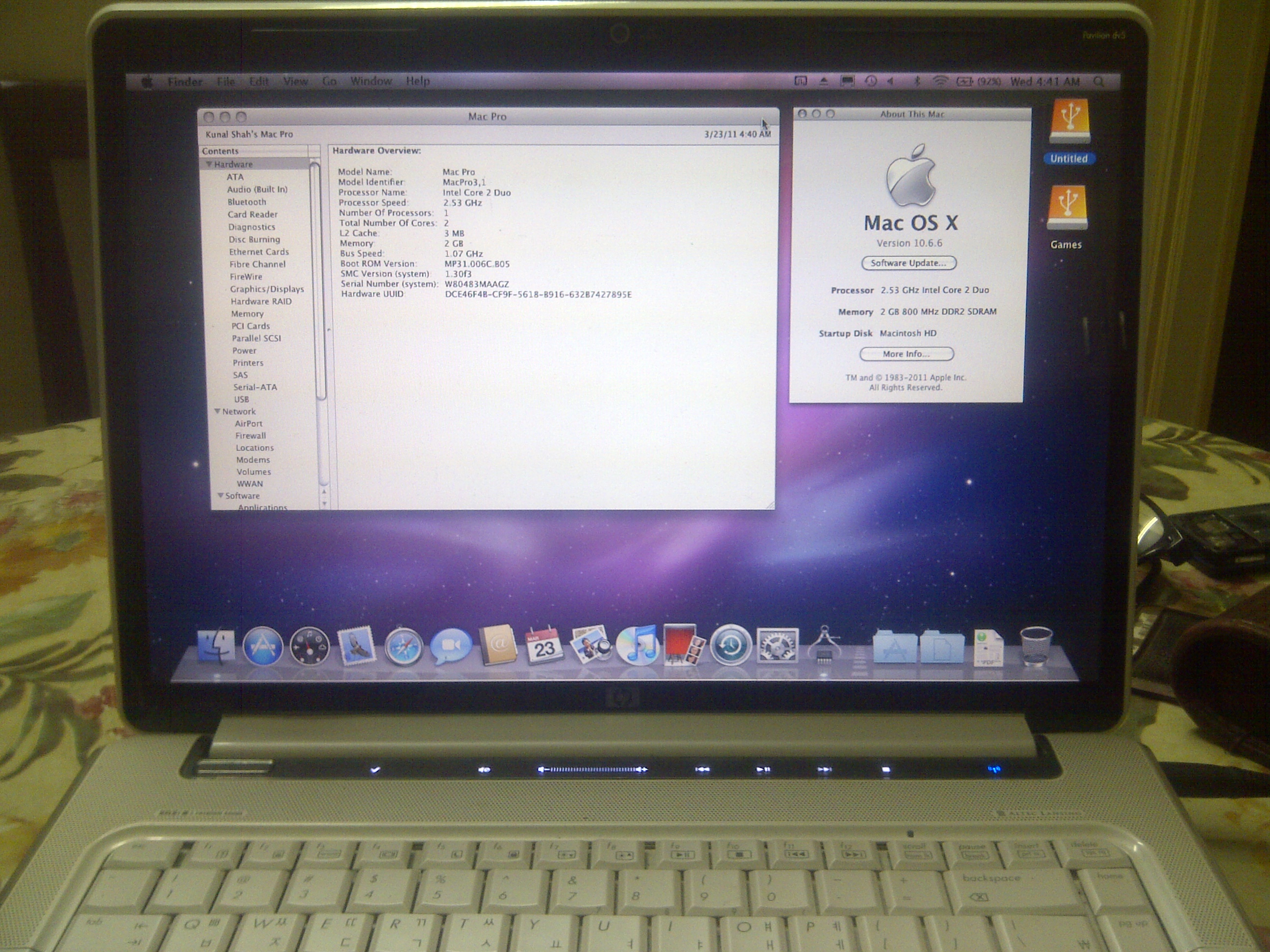

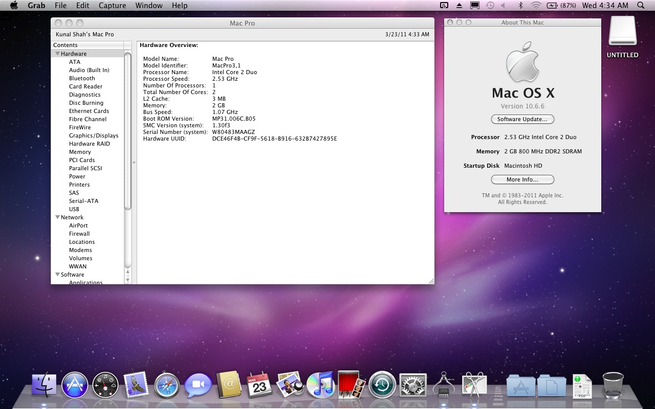

KiD KuN Posted March 22, 2011 Share Posted March 22, 2011 @Mammoth!! SUCCESS!!! I had a successful install. Firstly I will tell you how I did it, had a couple of things that are not working and things that I noticed. Initially the V2.00 did not work for me until I did not replace the SMBIOS.plist in the extra folder. I got the SMBIOS.plist from the "preboot.dmg" file from the Mammoth V1.5 Boot CD. This file was copied to the V2.00 MIID(in to the extra folder). I then booted the in to the installer, executed the "installer log" trick. Now as noted by another user, it is not "/Volumes/Cham/Finish" It is "/Volumes/CIIF/Finish" As expected the "/Volumes/CIIF/Finish" command installed the bootloader to the internal disk drive and it was the Macpro3,1 SMBIOS.plist provided by default during installation. So during my first boot I used the bootloader on the internal drive and there I am sitting on my OS X Destop. I also successfully updated to 10.6.6 and i am using chocolate kernel. In theory it might look complicated but it is not as complicated. Now the things that are not working are: # Audio: I followed what the guide said and "enableaudio" was run before 10.6.6 COMBO update restart. Despite all that, i get a grayed out volume control. In system preferences i get "No output device" I think this is because Mammoth your audio chip is "IDT 92HD75B3" and mine is "IDT 92HD71B7" so if possible can Taptun and/or you please look in to this and get back to me. # Brightness: My brightness controls dont work. Both controls( Fn+F7 or F8) or using the application in the guide. ( What must be causing this, i also wanted a fix this !) # HDMI: When i connect my HDMI cable, the screen goes blank for a second then comes back. In display it does see "LG TV" but even thought i try mirror or not, all resolution there is no display on the TV, more like there is no signal, but the laptop can see the TV, otherwise it would not have said "LG TV" (wanted to fix this but i guess i will have to wait till my audio) if fix available please let me know! NB: The smbios.plist used by me (obtained from Mammoth V1.5 Boot CD) was "MacBookPro6,2" Also attached are the images showing the OS X desktop. One is a screenshot, one of my laptop showing the desktop. Once Again Thanks to Mammoth,NIxin,Taptun and Mald0n! And all the other people that made this possible. It is the most stable system I have ever had. Thanks to Mammoth for On-the-fly editing of files since it is all USB based. Hope to get everything fixed soon so that i can use this as my main machine! Link to comment https://www.insanelymac.com/forum/topic/250849-guide-mammoth-method-v200-hp-dvx-106x-fast-easy-comprehensive-installation-new-mammoth-boot-cd-for-i5-i3/page/2/#findComment-1659377 Share on other sites More sharing options...
pablo101 Posted March 23, 2011 Share Posted March 23, 2011 To reiterate what KiD KuN has just posted: I have just finished updating to 10.6.6 YES THANKYOU LOL And to reiterate the CIIF finish thingy is needed. The 10.6.3 kernel is strangely not working, at least for me, but 10.6.6 kernel works fine after 10.6.6 update. And audio is fine, lan is fine after running the lan program from the old mammoth boot disk. graphics fine, cpu fine. A few queries: 1) In activity monitor I only see 1 cpu. Haven't we got all the cpus/cores working?? 2) The audio from the speakers is noticeably "duller" than under windows, a driver problem or my own setup or DSDT perhaps, any advice? thanks Link to comment https://www.insanelymac.com/forum/topic/250849-guide-mammoth-method-v200-hp-dvx-106x-fast-easy-comprehensive-installation-new-mammoth-boot-cd-for-i5-i3/page/2/#findComment-1659389 Share on other sites More sharing options...
