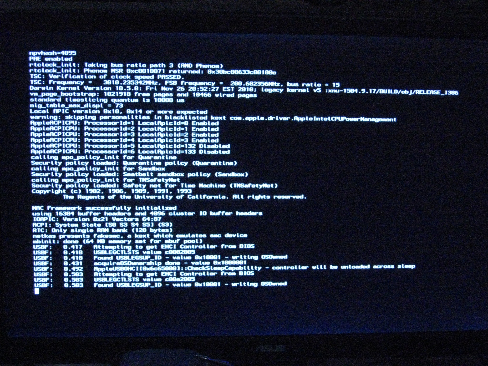

jeisom Posted December 11, 2010 Share Posted December 11, 2010 I got my system to finally boot ( still running 10.6.3) using the kernel pkg from this forum. I have a athlon II 640 with a ASUS M4A78 PRO motherboard. To boot I need to disable ehci usb in the bios and "arch=i386". If I do use ehci the kernel hangs, no KP. if I use -force64 some apps don't run,(Firefox for example). any ideas on the usb2 issue? Link to comment https://www.insanelymac.com/forum/topic/237538-1065-legacy-kernel-for-intelamd-3264bit-ready-to-download-by-qoopznawcomanvblackknightmucha-a-few-new-features/page/5/#findComment-1600476 Share on other sites More sharing options...
Andy Vandijck Posted December 11, 2010 Author Share Posted December 11, 2010 I got my system to finally boot ( still running 10.6.3) using the kernel pkg from this forum. I have a athlon II 640 with a ASUS M4A78 PRO motherboard. To boot I need to disable ehci usb in the bios and "arch=i386". If I do use ehci the kernel hangs, no KP. if I use -force64 some apps don't run,(Firefox for example). any ideas on the usb2 issue? Try my custom IOUSBFamily Link to comment https://www.insanelymac.com/forum/topic/237538-1065-legacy-kernel-for-intelamd-3264bit-ready-to-download-by-qoopznawcomanvblackknightmucha-a-few-new-features/page/5/#findComment-1600516 Share on other sites More sharing options...
jeisom Posted December 12, 2010 Share Posted December 12, 2010 Try my custom IOUSBFamily Didn't work. Dies "Attempting to get EHCI controller from bios" I believe. EDIT: Could this be a bios bug? Link to comment https://www.insanelymac.com/forum/topic/237538-1065-legacy-kernel-for-intelamd-3264bit-ready-to-download-by-qoopznawcomanvblackknightmucha-a-few-new-features/page/5/#findComment-1601151 Share on other sites More sharing options...
Mohamed Khairy Posted December 12, 2010 Share Posted December 12, 2010 Didn't work. Dies "Attempting to get EHCI controller from bios" I believe.EDIT: Could this be a bios bug? try update bios and also play around usb setting on bios setting Link to comment https://www.insanelymac.com/forum/topic/237538-1065-legacy-kernel-for-intelamd-3264bit-ready-to-download-by-qoopznawcomanvblackknightmucha-a-few-new-features/page/5/#findComment-1601166 Share on other sites More sharing options...
jeisom Posted December 12, 2010 Share Posted December 12, 2010 try update bios and also play around usb setting on bios setting Had the lastest and even tried downgrading. The only thing I can find that works is disabling EHCI all together. Link to comment https://www.insanelymac.com/forum/topic/237538-1065-legacy-kernel-for-intelamd-3264bit-ready-to-download-by-qoopznawcomanvblackknightmucha-a-few-new-features/page/5/#findComment-1601167 Share on other sites More sharing options...
jeisom Posted December 13, 2010 Share Posted December 13, 2010 Had the lastest and even tried downgrading. The only thing I can find that works is disabling EHCI all together. Did some more testing. If I set "USB 2.0 Controller Mode" to FullSpeed I have a 50/50 chance of actually get the system up with EHCI controllers running. It appears to stall somewhere else then on the times it fails to boot. Link to comment https://www.insanelymac.com/forum/topic/237538-1065-legacy-kernel-for-intelamd-3264bit-ready-to-download-by-qoopznawcomanvblackknightmucha-a-few-new-features/page/5/#findComment-1601290 Share on other sites More sharing options...
