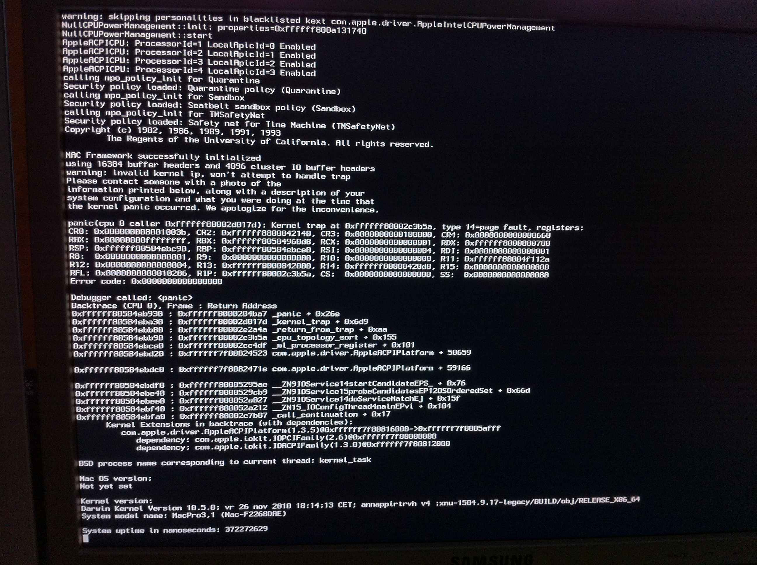

Andy Vandijck Posted November 28, 2010 Author Share Posted November 28, 2010 bump! i dont know either probably fakesmc.. shed some light pls.. It is not fakesmc. It has to do with AppleACPIPlatform, it just indicates that AppleIntelCPUPowerManagement won't work on this cpu (but we allready knew this, right?) The second point: That it fails decryption untill dsmos arrives is normal (standard kernel just isn't that verbose on it). It just waits on DSMOS arrival and then decrypts + executes the binaries. Link to comment https://www.insanelymac.com/forum/topic/237538-1065-legacy-kernel-for-intelamd-3264bit-ready-to-download-by-qoopznawcomanvblackknightmucha-a-few-new-features/page/3/#findComment-1592999 Share on other sites More sharing options...

mac_carol Posted November 29, 2010 Share Posted November 29, 2010 Thanks a lot Andy (and also Nawcom) for this new update when I use the "arch=i386 -force64" everything works like a charm, both 32 & 64 bits apps but when I use the "arch=x86_64" (with or without -force64), I get stuck with this KP related to AppleACPIPlatform FYI, I'm running the SL (retail) updated to 10.6.5 on my AMD P-II x4 & my ATI SB790 mobo (using your AppleATIATA-7 kext) Link to comment https://www.insanelymac.com/forum/topic/237538-1065-legacy-kernel-for-intelamd-3264bit-ready-to-download-by-qoopznawcomanvblackknightmucha-a-few-new-features/page/3/#findComment-1593373 Share on other sites More sharing options...
defix Posted November 29, 2010 Share Posted November 29, 2010 I can second mac_carol. Asus SB700 based board with a Phenom 2 955, Retail SL with fakesms, appleatiata-7, nullcpupowermanagement kexts in e/e and appleazaliaaudio in s/l/e. Chameleon RC3 (RC4 does not make a difference though). i386 with -force64 -notscverify works perfectly, arch=x86_64 I get pretty much the exact same KP he does. Thanks for your great work nawcom and anv, without you guys we amd folks would be pretty screwed . Edit: Screenshot attached. Link to comment https://www.insanelymac.com/forum/topic/237538-1065-legacy-kernel-for-intelamd-3264bit-ready-to-download-by-qoopznawcomanvblackknightmucha-a-few-new-features/page/3/#findComment-1593404 Share on other sites More sharing options...
