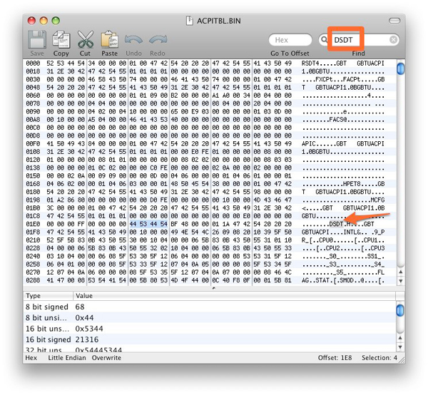

mitch_de Posted November 13, 2010 Share Posted November 13, 2010 General Question - How can i get an unmodded/orig. DSDT.AML (or .dsl) out of an orig. BIOS.ROM file ? I most use DSDT to boot OS X. All working so far. But i want compare my handmade dsdt with that autopatcher one. i cant use the buildin feature to read the dsdt i belive (because its already loaded orig. unpatched dsdt ) How can i use the Autoppatcher to generate an new one ? I mean how can i get an orig. DSDT out of my BIOS file (orig.) . I dont have that dsdt-orig. anymore for usage as input file for that great patcher Would be nice if someone could tell me teh steps - running OS X / Vmware Win - how to get an dsdt.dsl out of my BIOS.ROM file. Link to comment https://www.insanelymac.com/forum/topic/235523-dsdt-auto-patcher/page/8/#findComment-1582610 Share on other sites More sharing options...

el coniglio Posted November 13, 2010 Share Posted November 13, 2010 @mitch_de Did you flash your bios with a modded dsdt? If you didn't do this you can just boot a live cd and extract it from there (or into windows if you have it). If you really flashed it you can extract the dsdt from rom using the bios manufacturer proper tool, but there are only available for windows (IMO). If its an AMI bios, http://www.ami.com/support/bios.cfm AWARD you'll use cbrom32 and so on, you can get them from google in a sec. If you cannot do it (doesn't have windows) post the rom and bios spec. Link to comment https://www.insanelymac.com/forum/topic/235523-dsdt-auto-patcher/page/8/#findComment-1582722 Share on other sites More sharing options...

mitch_de Posted November 13, 2010 Share Posted November 13, 2010 @mitch_de Did you flash your bios with a modded dsdt? If you didn't do this you can just boot a live cd and extract it from there (or into windows if you have it). If you really flashed it you can extract the dsdt from rom using the bios manufacturer proper tool, but there are only available for windows (IMO). If its an AMI bios, http://www.ami.com/support/bios.cfm AWARD you'll use cbrom32 and so on, you can get them from google in a sec. If you cannot do it (doesn't have windows) post the rom and bios spec. I dont have linux live CD nor native win installed. I tried cbrom32 (OS X + Vmware Win) already with half sucess, because but did someting wrong - perhaps wrong command line parameters?) . I get some disassembled Table content, but not the long dsdt.dsl. Here is that bios (award) which is orig. (also orig. on the mainboard). EP35DS3.F5a.zip Link to comment https://www.insanelymac.com/forum/topic/235523-dsdt-auto-patcher/page/8/#findComment-1582785 Share on other sites More sharing options...
oldnapalm Posted November 13, 2010 Share Posted November 13, 2010 2 -> Extract the ACPI table. On the command prompt execute: cbrom biosfilename.bin /acpitbl extract This will extract an ACPITBL.BIN file to your working folder. You might need to press Enter twice. 3 -> Extract the DSDT (Differentiated System Description Table) from ACPITBL.BIN. For this open ACPITBL.BIN file with an HEX Editor. Search for an ASCII signature labeled DSDT. Select all the bytes starting immediately before the D of the DSDT word to the end of the ACPITBL.BIN file. Now copy all these bytes to a new file on the HEX Editor and save this new file as DSDT.bin placed on your working folder. http://www.rebelshavenforum.com/sis-bin/ul...c;f=52;t=000143 Link to comment https://www.insanelymac.com/forum/topic/235523-dsdt-auto-patcher/page/8/#findComment-1582794 Share on other sites More sharing options...
MaLd0n Posted November 13, 2010 Author Share Posted November 13, 2010 SS by EvoTeam Guide Link to comment https://www.insanelymac.com/forum/topic/235523-dsdt-auto-patcher/page/8/#findComment-1582802 Share on other sites More sharing options...
