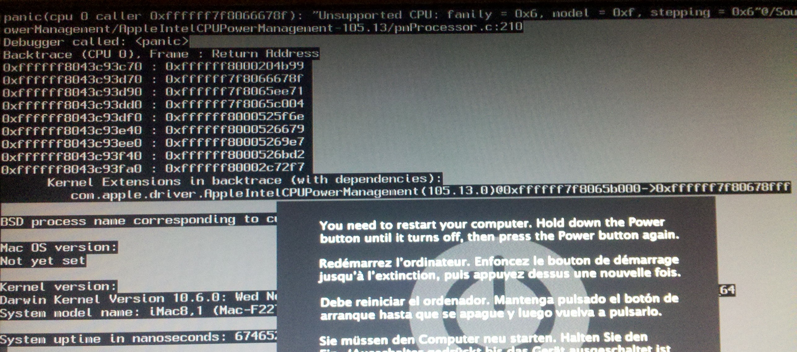

toology Posted January 23, 2011 Share Posted January 23, 2011 First of all, thanks for the great tool! I used to use a hackintosh but had to format the hdd. Now I'm back, but have a bit of a DSDT issue. I have an ASUS P5B mobo and when I put the DSDT your tool creates in the root of the drive, it's not used. I get a kernel panic from apple cpu power management. I know my computer is capabale of using it, since oldnapalm from DSDT editor thread made me a working DSDT. I tried using it now and I get the same error. I reinstalled disabler kext so I can use the OS, but I have no idea what to do. BTW I use the latest build of Chameleon RC5 (699). Other components of interest would be Core2Duo CPU and NVIDIA 8800 GTS 320MB graphics (added via EFI string). I'm also attaching both patched DSDTs for your reference. Hope that you can help me and thank you once again! Regards, Mihailo dsdt.zip Link to comment https://www.insanelymac.com/forum/topic/235523-dsdt-auto-patcher/page/69/#findComment-1627811 Share on other sites More sharing options...

MaLd0n Posted January 23, 2011 Author Share Posted January 23, 2011 First of all, thanks for the great tool! I used to use a hackintosh but had to format the hdd. Now I'm back, but have a bit of a DSDT issue. I have an ASUS P5B mobo and when I put the DSDT your tool creates in the root of the drive, it's not used. I get a kernel panic from apple cpu power management. I know my computer is capabale of using it, since oldnapalm from DSDT editor thread made me a working DSDT. I tried using it now and I get the same error. I reinstalled disabler kext so I can use the OS, but I have no idea what to do. BTW I use the latest build of Chameleon RC5 (699). Other components of interest would be Core2Duo CPU and NVIDIA 8800 GTS 320MB graphics (added via EFI string). I'm also attaching both patched DSDTs for your reference. Hope that you can help me and thank you once again! Regards, Mihailo I need to see the screen of the KP this motherboard does not need the fix HPET but... i have both ide disabled in bios i will check my status...iirc combined is the only setting that shows the drives up (both sata dvd and hdd) any of the rest i set wont let the drives be seen any difference? performance? Link to comment https://www.insanelymac.com/forum/topic/235523-dsdt-auto-patcher/page/69/#findComment-1627935 Share on other sites More sharing options...

toology Posted January 23, 2011 Share Posted January 23, 2011 I need to see the screen of the KPthis motherboard does not need the fix HPET but... any difference? performance? Here is the picture. Link to comment https://www.insanelymac.com/forum/topic/235523-dsdt-auto-patcher/page/69/#findComment-1628014 Share on other sites More sharing options...
MaLd0n Posted January 23, 2011 Author Share Posted January 23, 2011 Here is the picture. "unsupported cpu" this is the message use the search forum and try to find a solution Link to comment https://www.insanelymac.com/forum/topic/235523-dsdt-auto-patcher/page/69/#findComment-1628049 Share on other sites More sharing options...
toology Posted January 23, 2011 Share Posted January 23, 2011 As I mentioned, the cpu used to work with native power management, using the oldnapalm dsdt. Both times I installed using iATKOS S3 v2. I already have a SL disk that came with my macbook pro, but I couldn't install using it. The only thing that is different now is that the hdd is in IDE mode and that I am using the newest build of Chameleon RC5 and not the one that came with the distribution. Anyway, thanks for looking at it. Power and the fans are acceptable even when using VoodooPowerMini. Link to comment https://www.insanelymac.com/forum/topic/235523-dsdt-auto-patcher/page/69/#findComment-1628097 Share on other sites More sharing options...

toology Posted January 24, 2011 Share Posted January 24, 2011 I seem to have found the problem with Cpu Power Management. System profiler thinks that I run Core2Solo, instead of core2duo. Anyone know how to fix this? If this is OT please pm me. Thanks! Link to comment https://www.insanelymac.com/forum/topic/235523-dsdt-auto-patcher/page/69/#findComment-1628188 Share on other sites More sharing options...
MaLd0n Posted January 24, 2011 Author Share Posted January 24, 2011 I seem to have found the problem with Cpu Power Management. System profiler thinks that I run Core2Solo, instead of core2duo. Anyone know how to fix this? If this is OT please pm me. Thanks! look at your SMBIOS Link to comment https://www.insanelymac.com/forum/topic/235523-dsdt-auto-patcher/page/69/#findComment-1628196 Share on other sites More sharing options...
toology Posted January 24, 2011 Share Posted January 24, 2011 I created an iMac 9,1 SMBIOS in the Extra folder. <?xml version="1.0" encoding="UTF-8"?> <!DOCTYPE plist PUBLIC "-//Apple//DTD PLIST 1.0//EN" "http://www.apple.com/DTDs/PropertyList-1.0.dtd"> <plist version="1.0"> <dict> <key>SMbiosvendor</key> <string>Apple Inc.</string> <key>SMbiosversion</key> <string>IM91.88Z.008D.B08.0904271717</string> <key>SMmanufacter</key> <string>Apple Inc.</string> <key>SMproductname</key> <string>iMac9,1</string> <key>SMsystemversion</key> <string>1.0</string> <key>SMserial</key> <string>nnnnnnnnnnn</string> <key>SMfamily</key> <string>Mac</string> <key>SMboardmanufacter</key> <string>Apple Inc.</string> <key>SMboardproduct</key> <string>Mac-F2218FA9</string> <key>SMcputype</key> <string>769</string> <key>SMbustype</key> <string>0103</string> <key>SMexternalclock</key> <string>266</string> <key>SMmaximalclock</key> <string>2135</string> <key>SMmemtype</key> <string>19</string> <key>SMmemspeed</key> <string>800</string> <key>SMmemmanufacter_1</key> <string>Kingston Technology</string> <key>SMmemmanufacter_2</key> <string>Kingston Technology</string> <key>SMmemmanufacter_3</key> <string>Kingston Technology</string> <key>SMmemmanufacter_4</key> <string>Kingston Technology</string> <key>SMmempart_1</key> <string>KVR800D2N6/1G</string> <key>SMmempart_2</key> <string>KVR800D2N6/1G</string> <key>SMmempart_3</key> <string>KVR800D2N6/1G</string> <key>SMmempart_4</key> <string>KVR800D2N6/1G</string> <key>SMmemserial_1</key> <string>nnnnnnnn</string> <key>SMmemserial_2</key> <string>nnnnnnnn</string> <key>SMmemserial_3</key> <string>nnnnnnnn</string> <key>SMmemserial_3</key> <string>nnnnnnnn</string> </dict> </plist> From snooping around on the net, I found 2 keys that identify a Core 2 Duo: <key>SMcputype</key> <string>769</string> <key>SMbustype</key> <string>0103</string> But system config still shows Core 2 Solo, at the right GHz speed but only one core. Memory speed has changed according to my edit so I assume chameleon sees the file. Link to comment https://www.insanelymac.com/forum/topic/235523-dsdt-auto-patcher/page/69/#findComment-1628231 Share on other sites More sharing options...
