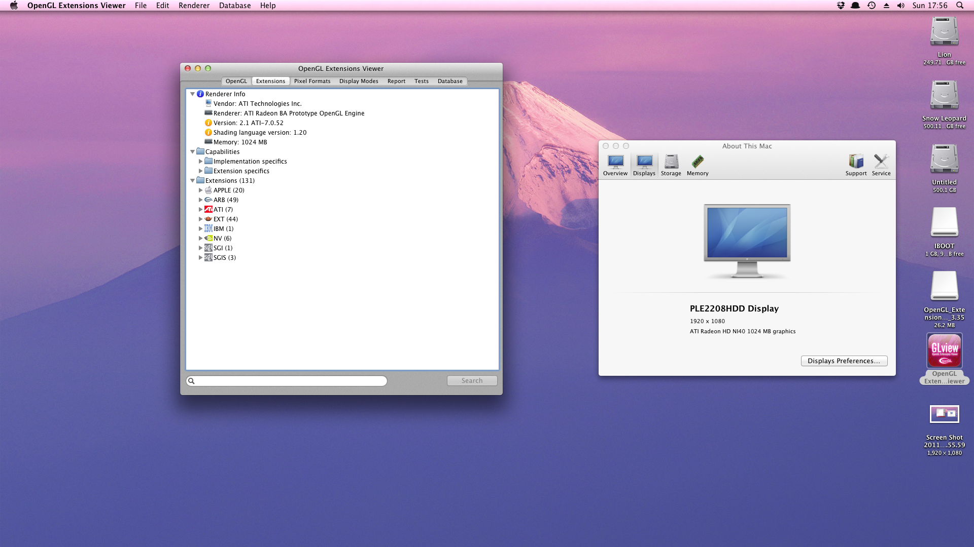

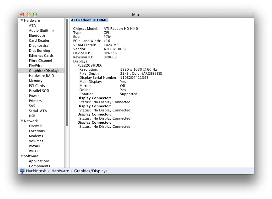

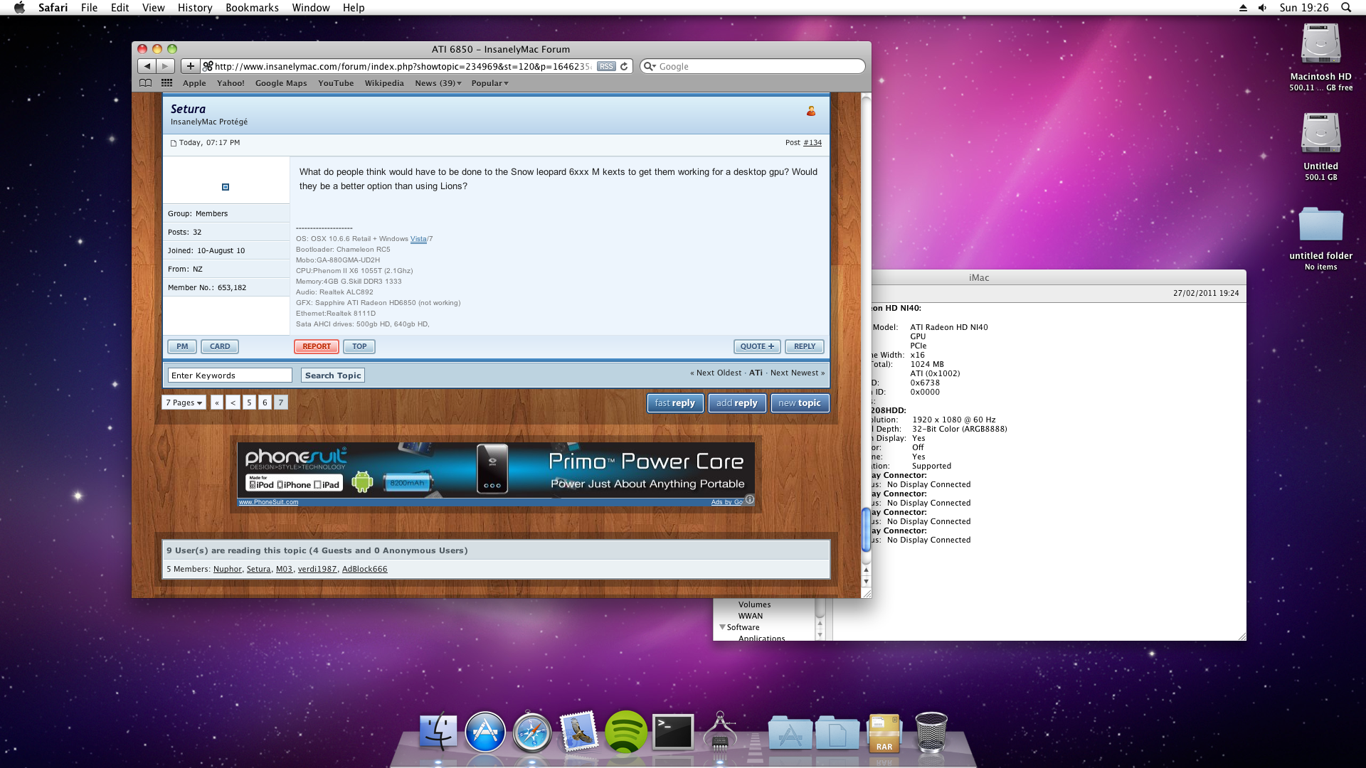

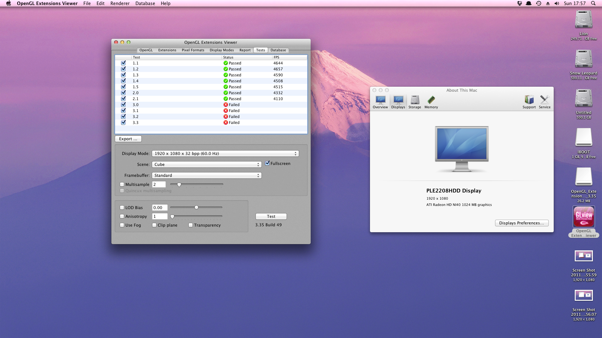

Nuphor Posted March 6, 2011 Share Posted March 6, 2011 Just installed Lion, have full QE/CI, res change, all ports working with my 6870 - the lot. All out of the box, with no injector. Link to comment https://www.insanelymac.com/forum/topic/234969-ati-6850/page/6/#findComment-1650129 Share on other sites More sharing options...
Guest ^Andy^ Posted March 6, 2011 Share Posted March 6, 2011 I have lion installed however it has several other problems ie the need to use a usb EFI boot loader which for various reasons locks solid if I use a custom dsdt which ultimately means I have graphics but no sound lol As soon as this ridiculously slow download of xcode 4.1 finishes I'm going to try a to a new chameleon build that will hopefully be able to boot lion and allow me to have working sound. I'll post back if it works (when the snails pace download finishes). Link to comment https://www.insanelymac.com/forum/topic/234969-ati-6850/page/6/#findComment-1650134 Share on other sites More sharing options...
jeanlain Posted March 6, 2011 Share Posted March 6, 2011 Just installed Lion, have full QE/CI, res change, all ports working with my 6870 - the lot. All out of the box, with no injector. How does the system report the card? Screenshots of system profiler, GLview benchmarks, etc... or it didn't happen. That makes your the first dude with a radeon 6XXX card (not integrated GPU) fully running on OS X. Good job. I'm interested to know if this could work on Mac Pros too. I have one from 2006. My guess is that it would work at least with another genuine Apple card (or flashed PC card) in it. But I only have one that requires 2 PCIe cables (4870), and I don't want 2 massive cards in my Mac. Plus, it's not guaranteed to work and I reluctant to wast money on a radeon 6XXX. Link to comment https://www.insanelymac.com/forum/topic/234969-ati-6850/page/6/#findComment-1650163 Share on other sites More sharing options...
Nuphor Posted March 6, 2011 Share Posted March 6, 2011 Think netkas just beat you to it Andy: netkas.org I'll post some screens in a few hours, but chances are others will have tried and posted before I get back to my machine. Link to comment https://www.insanelymac.com/forum/topic/234969-ati-6850/page/6/#findComment-1650165 Share on other sites More sharing options...
Nuphor Posted March 6, 2011 Share Posted March 6, 2011 Back - some screenshots attached. Link to comment https://www.insanelymac.com/forum/topic/234969-ati-6850/page/6/#findComment-1650265 Share on other sites More sharing options...
