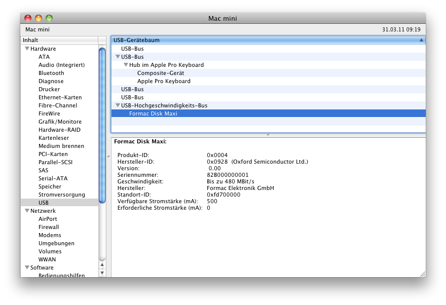

hueman Posted March 31, 2011 Share Posted March 31, 2011 So, I just installed the 10.6.7 legacy kernel from post #141 and I'm still having this issue. This is what the terminal says: $ uname -a Darwin mac-mini.fiedler.local 10.7.0 Darwin Kernel Version 10.7.0: Mon Mar 28 13:34:53 EDT 2011; legacy kernel v7 :xnu-1504.9.37/BUILD/obj/RELEASE_I386 i386 I can see my external HDD with the system profiler, but it won't mount or anything. A screenshot is attached. My USB-keyboard and mouse are working without problems. And I already tried different ports... Link to comment Share on other sites More sharing options...
Dellmantt Posted March 31, 2011 Author Share Posted March 31, 2011 So, I just installed the 10.6.7 legacy kernel from post #141 and I'm still having this issue.This is what the terminal says: $ uname -a Darwin mac-mini.fiedler.local 10.7.0 Darwin Kernel Version 10.7.0: Mon Mar 28 13:34:53 EDT 2011; legacy kernel v7 :xnu-1504.9.37/BUILD/obj/RELEASE_I386 i386 I can see my external HDD with the system profiler, but it won't mount or anything. A screenshot is attached. My USB-keyboard and mouse are working without problems. And I already tried different ports... Yes thats the 10.7 Legacy Kernel. You Should not be having USB problems with that kernel. Does "Disk Utility" see the drive? There was a problem with USB with a mismatch between kernel & system versions, but you should not be having that. If you continue to have problems then you could try rolling back the IOUSBFamily & IOUSBMassStorageClass kexts. you will find details on how to do that in the 10.6.6 & 10.6.7 update threads in the New Releases section. I did ask you once before Quote "What model do you have 520 or 620 and what CPU P4 or Pen D or Celeron ? (Good idea to have your specs in your signature)" Link to comment Share on other sites More sharing options...
