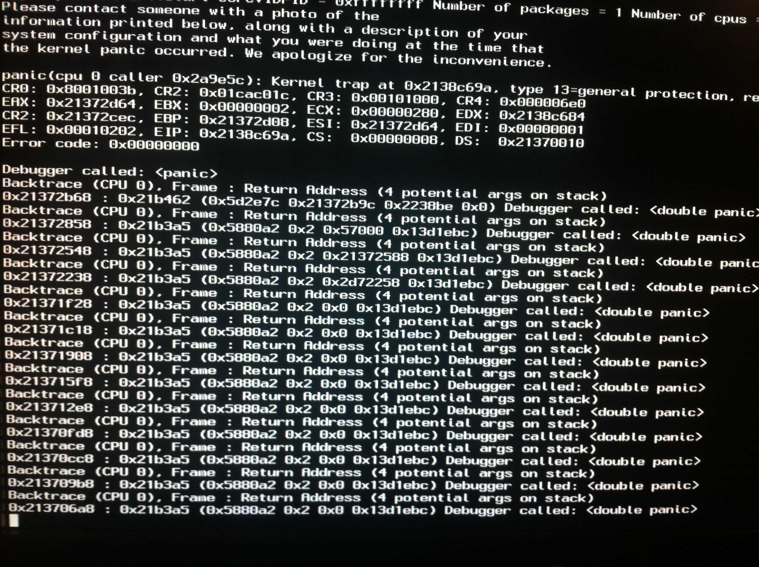

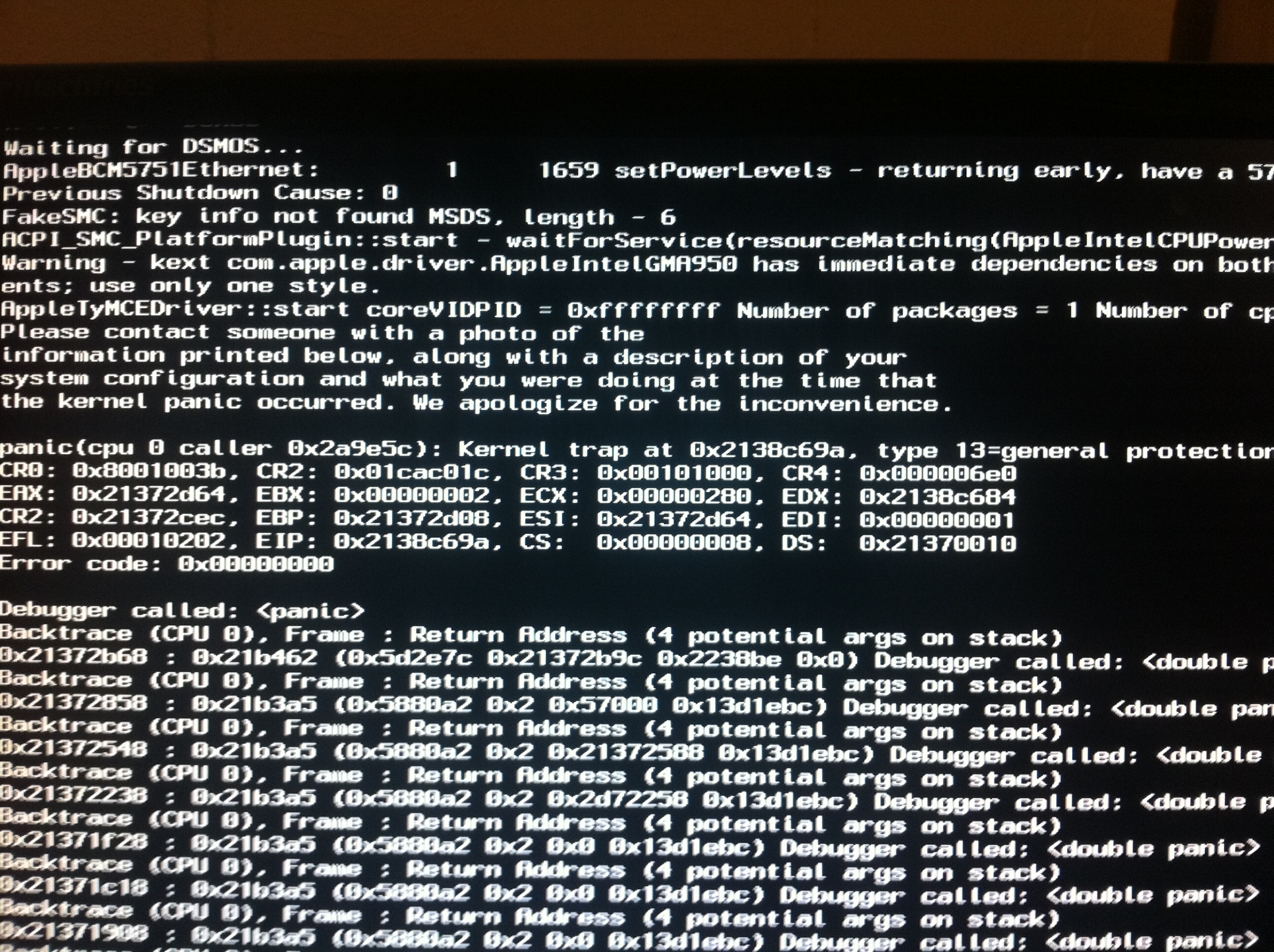

gladpants Posted June 10, 2011 Share Posted June 10, 2011 I keep getting these Kernel Panics. I wanted to ask to see if someone could pin point the problem. This only happens when I don't boot into safe mode. With safe mode, boot is accomplished. I was able to install the files necessary, everything works, (except Ethernet) due to mac issue. I have no idea how to find out what it is. Great tut, hopefully someone can guide me in the right direction. Gladpants Link to comment https://www.insanelymac.com/forum/topic/233396-dell-optiplex-gx520/page/9/#findComment-1695658 Share on other sites More sharing options...
Dellmantt Posted June 10, 2011 Author Share Posted June 10, 2011 I keep getting these Kernel Panics. I wanted to ask to see if someone could pin point the problem. This only happens when I don't boot into safe mode. With safe mode, boot is accomplished. I was able to install the files necessary, everything works, (except Ethernet) due to mac issue. I have no idea how to find out what it is. Great tut, hopefully someone can guide me in the right direction. Gladpants Which model 520 or 620? What CPU? Using Legacy or Vanilla kernel? Did you follow the guide exactly? Did the kernel panics start at first boot or have you changed something recently? Can you post your "com.apple.Boot.plist" from "Extra" Link to comment https://www.insanelymac.com/forum/topic/233396-dell-optiplex-gx520/page/9/#findComment-1695673 Share on other sites More sharing options...
gladpants Posted June 10, 2011 Share Posted June 10, 2011 Which model 520 or 620? What CPU? Using Legacy or Vanilla kernel? Did you follow the guide exactly? Did the kernel panics start at first boot or have you changed something recently? Can you post your "com.apple.Boot.plist" from "Extra" 620, Pentium d legacy 10.3.0 I did this with precompiled dvd because i have no mac available hence me creating a hackintosh.. if i had one available i wouldn't be making this one in fact im trying to make this one to make another one. I only selected the required items from this tut all of which were there. Boots fine into safe mode. Panics started at first boot. <?xml version="1.0" encoding="UTF-8"?> <!DOCTYPE plist PUBLIC "-//Apple//DTD PLIST 1.0//EN" "http://www.apple.com/DTDs/PropertyList-1.0.dtd"> <plist version="1.0"> <dict> <key>Kernel</key> <string>mach_kernel</string> <key>Kernel Flags</key> <string>-v arch=i386</string> <key>GraphicsEnabler</key> <string>y</string> <key>Timeout</key> <string>5</string> </dict> </plist> Link to comment https://www.insanelymac.com/forum/topic/233396-dell-optiplex-gx520/page/9/#findComment-1695699 Share on other sites More sharing options...
Dellmantt Posted June 10, 2011 Author Share Posted June 10, 2011 @ gladpants By "precompiled dvd" I assume you mean a "Distro". As I have indicated elsewhere in this thread, I prefer to keep the questions about installs done using this guide so it is easy to help when problem occur. If you installed patched kextst from the "precompiled dvd", I suggest you revert/install vanilla kexts and start form there. Try adding this to "com.apple.Boot.plist" <key>PciRoot</key> <string>1</string> Try running "fsck -fy" from single use mode as well. If you get it booting you could, if you have a spare disc or partition, use this install to do another install as per the guide. Link to comment https://www.insanelymac.com/forum/topic/233396-dell-optiplex-gx520/page/9/#findComment-1695712 Share on other sites More sharing options...
