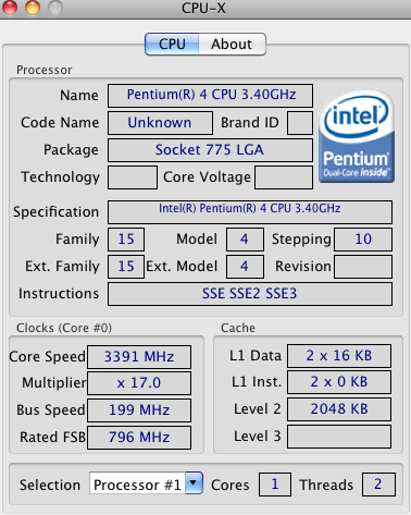

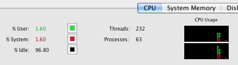

CoolFX Posted November 29, 2010 Share Posted November 29, 2010 Just found out this tread. I also own a GX620. One tip about sleep mode, it only works fine if you disable hypertreading technology on system bios. I have everything running fine with 10.6.4 and i just installed the new qoopz legacy kernel 10.5 witch made my hackintosh work in 64 bit mode. Amazing. The only problem i have is with the usbe aka hi-speed usb port, witch is on expansion slot mode. Everything works fine but when i have a external hard drive attached and the system wakes up from sleep mode, it just gives me an eject error. Besides that the macosx is perfect and running perfectly. Link to comment https://www.insanelymac.com/forum/topic/233396-dell-optiplex-gx520/page/3/#findComment-1593153 Share on other sites More sharing options...
Dellmantt Posted November 29, 2010 Author Share Posted November 29, 2010 Just found out this tread. I also own a GX620. One tip about sleep mode, it only works fine if you disable hypertreading technology on system bios. I have everything running fine with 10.6.4 and i just installed the new qoopz legacy kernel 10.5 witch made my hackintosh work in 64 bit mode. Amazing. The only problem i have is with the usbe aka hi-speed usb port, witch is on expansion slot mode. Everything works fine but when i have a external hard drive attached and the system wakes up from sleep mode, it just gives me an eject error. Besides that the macosx is perfect and running perfectly. If you disable hypertreading then you lose one core with the Core 2 Duo and a loss of performance (verified with Geekbench & Xbench) I am running the 10.5 legacy kernel with the 10.6.5 update and have had no problems. Am using the kernel from nawcom post 43 here http://www.insanelymac.com/forum/index.php...p;#entry1591520 Have not tried Andy Vandijck's version 2 yet. Link to comment https://www.insanelymac.com/forum/topic/233396-dell-optiplex-gx520/page/3/#findComment-1593217 Share on other sites More sharing options...
CoolFX Posted November 29, 2010 Share Posted November 29, 2010 If you disable hypertreading then you lose one core with the Core 2 Duo and a loss of performance (verified with Geekbench & Xbench)I am running the 10.5 legacy kernel with the 10.6.5 update and have had no problems. Am using the kernel from nawcom post 43 here http://www.insanelymac.com/forum/index.php...p;#entry1591520 Have not tried Andy Vandijck's version 2 yet. I'm using that one too. I think they are the same. I don't have a Core 2 Duo. Its a simple Pentium 4. Maybe thats why my sleep mode have a different behavior and only wake up with hyperthreading disabled. Did you fix the ehci usb on your osx? I'm trying to fix that with dsdt but with no luck. When i extract my dsdt there is no ehci on it for me to fix. Its very strange, i only have uhci usb on my dsdt. Link to comment https://www.insanelymac.com/forum/topic/233396-dell-optiplex-gx520/page/3/#findComment-1593750 Share on other sites More sharing options...
scififan68 Posted November 30, 2010 Share Posted November 30, 2010 I'm using that one too. I think they are the same. I don't have a Core 2 Duo. Its a simple Pentium 4. Maybe thats why my sleep mode have a different behavior and only wake up with hyperthreading disabled. Did you fix the ehci usb on your osx? I'm trying to fix that with dsdt but with no luck. When i extract my dsdt there is no ehci on it for me to fix. Its very strange, i only have uhci usb on my dsdt. Thats really weird, I have the GX620 with a 2.8GHz Pentium 4 with HT and my sleep works just fine with HT enabled in bios. I do not have usb issues "built in usb" is what it says in system profiler. The only time sleep doesn't work for me is when it boot into pure 64bit mode and it just wakes up immediately, but I've heard that is because the gma 950 has no 64bit kexts. I wonder if you have sleepenabler.kext installed into /Extra/Extensions ? Link to comment https://www.insanelymac.com/forum/topic/233396-dell-optiplex-gx520/page/3/#findComment-1593794 Share on other sites More sharing options...
Dellmantt Posted November 30, 2010 Author Share Posted November 30, 2010 I'm using that one too. I think they are the same. I don't have a Core 2 Duo. Its a simple Pentium 4. Maybe thats why my sleep mode have a different behavior and only wake up with hyperthreading disabled. Did you fix the ehci usb on your osx? I'm trying to fix that with dsdt but with no luck. When i extract my dsdt there is no ehci on it for me to fix. Its very strange, i only have uhci usb on my dsdt. You should have one of the following-intel® Pentium® 4 dual core, Intel® Celeron® D & Intel® Pentium® D-That what the GX520-620 came with. No USB fixes in DSDT only fix is for GMA950. As scififan68 says ensure you have the appropriate sleepenabler.kext in Extra/Extensions And remove the force64 part in the boot.plist just have arch=i386 Link to comment https://www.insanelymac.com/forum/topic/233396-dell-optiplex-gx520/page/3/#findComment-1593799 Share on other sites More sharing options...
CoolFX Posted December 1, 2010 Share Posted December 1, 2010 You should have one of the following-intel® Pentium® 4 dual core, Intel® Celeron® D & Intel® Pentium® D-That what the GX520-620 came with.No USB fixes in DSDT only fix is for GMA950. As scififan68 says ensure you have the appropriate sleepenabler.kext in Extra/Extensions And remove the force64 part in the boot.plist just have arch=i386 My Dell GX620 have a single core Pentium 4, 3.0Ghz. I used Xbench and got a total score of 100.37 without hyperthreading and 101.32 with hiperthreading. I guess with a single core processor it doesn't make any noticeable difference. I just have 2 kext installed on the \Extra directory: FakeSmc and LegacyAppleRtc. Just that and nothing more. Everything runs just fine, even sleep but with hyperthreading off. Can you post the link of the sleepenabler kext you guys use? I'll try that with HT on. One more thing: On my bios i have sata as normal. I think its faster than combination. I didnt install ioatafamily and all my drives runs fine, even my IDE Dvd-rom. I'm just saying this because probably we don't need all those kexts installed if the system runs stable without them. Thats really weird, I have the GX620 with a 2.8GHz Pentium 4 with HT and my sleep works just fine with HT enabled in bios. I do not have usb issues "built in usb" is what it says in system profiler. The only time sleep doesn't work for me is when it boot into pure 64bit mode and it just wakes up immediately, but I've heard that is because the gma 950 has no 64bit kexts. I wonder if you have sleepenabler.kext installed into /Extra/Extensions ? Please post a link of your sleepenabler kext, Ill try that. You have the Hi-speed Usb Bus as Built-in on system profiler? I have all Usb Bus Built-in except the Hi-Speed Bus witch is on Expansion Slot. That slows Usb 2.0 transfers and cuts power from external hard drives when the system goes to sleep. When the computer wake up, it shows you a message of a usb device removal warning. You can read the thread of this issue here : http://www.insanelymac.com/forum/index.php?showtopic=155345 ApexDE on post 43 of that thread found the solution. Post 43 But i can't apply that to my dsdt. I don't have any entry for ehci (hi-speed Usb) on my dsdt for me to apply his solution. Really strange. Link to comment https://www.insanelymac.com/forum/topic/233396-dell-optiplex-gx520/page/3/#findComment-1594466 Share on other sites More sharing options...
Dellmantt Posted December 1, 2010 Author Share Posted December 1, 2010 we don't need all those kexts installed if the system runs stable without them. Good point Please post a link of your sleepenabler kext, Ill try that. I got the impression from one of your earlier posts that you were running 10.6.4 with the 10.5 kernel..? you can find the 10.6.4 & 10.6.5 Sleep Enabler kexts at kexts.com Link to comment https://www.insanelymac.com/forum/topic/233396-dell-optiplex-gx520/page/3/#findComment-1595078 Share on other sites More sharing options...

CoolFX Posted December 9, 2010 Share Posted December 9, 2010 Dellmantt, do you really have a core 2 duo or is it a dual core? On dell page specs this mobo cant use a core 2 duo http://www.dell.com/us/en/dfh/desktops/opt...cs=22&s=dfh I'm thinking to upgrade my cpu but i think that the best processor this board suports is a Intel Pentium D 960 (Dual Core) 3.6 GHZ. Is this true?? Thanks Dellmantt. Link to comment https://www.insanelymac.com/forum/topic/233396-dell-optiplex-gx520/page/3/#findComment-1599409 Share on other sites More sharing options...
Dellmantt Posted December 9, 2010 Author Share Posted December 9, 2010 Dellmantt, do you really have a core 2 duo or is it a dual core? On dell page specs this mobo cant use a core 2 duo http://www.dell.com/us/en/dfh/desktops/opt...cs=22&s=dfh I'm thinking to upgrade my cpu but i think that the best processor this board suports is a Intel Pentium D 960 (Dual Core) 3.6 GHZ. Is this true?? Thanks Dellmantt. Thats funny Dell have changed that page (I have it bookmarked). It use to say 'The GX520 comes with 3 processors an intel® Pentium® 4 dual core, Intel® Celeron® D & Intel® Pentium® D", which is what I quoted in the guide. From what the site says now the Pentium D dual core seems to be the fastest option. I am wondering now about the accuracy of the page as further down it now says "Available DIMM Slots:Two Memory slots offering up to 2GB". It used to say 4GB, which I have. Maybe it is the wording and it means 2GB per slot, From memory the old page said for the CPU Pentium® 4 dual core -single core 2 threads Intel® Celeron® D - single core single thread Intel® Pentium® D - single core single thread I would be checking with Dell as to what processor your board can actually take. In another thread, that I now can't find, somebody tried to upgrade a GX520 from a Celeron to a P4 and could not get the computer to boot. Interesting, From http://en.community.dell.com/support-forum...t/18290488.aspx "Thank you for using the Dell Community Forum. The OptiPlex™ GX520 system supports the Intel® Pentium® 4 (Prescott) 5xx series and Pentium 4 Celeron® 3xx series processors. Beginning March 17, 2006, the GX520 also supports the Intel Pentium D (Smithfield) 8xx series processors." From the same site "I emailed Dell Tech Support and they have told me that the Pentium D is the latest CPU that will work in this system. Here are some compatible sSpec numbers: SL88T, SL8CP, SL88S, SL8CN, SL88R and SL8CM - these are all from the 820, 830 and 840 range (no 9xx range will work)" Link to comment https://www.insanelymac.com/forum/topic/233396-dell-optiplex-gx520/page/3/#findComment-1599549 Share on other sites More sharing options...
scififan68 Posted December 10, 2010 Share Posted December 10, 2010 (no 9xx range will work)" Actually with latest bios(A11) any Pentium D will work. including D 9xx series Link to comment https://www.insanelymac.com/forum/topic/233396-dell-optiplex-gx520/page/3/#findComment-1599772 Share on other sites More sharing options...
CoolFX Posted December 10, 2010 Share Posted December 10, 2010 Actually with latest bios(A11) any Pentium D will work. including D 9xx series But no Core 2 Duo support, wright? Only Pentium D Dual Core. Well i guess ill have to search ebay for a good business on those. I'm am wondering if the cooling system on my 620 is enough to those fastest 9 series. Link to comment https://www.insanelymac.com/forum/topic/233396-dell-optiplex-gx520/page/3/#findComment-1599962 Share on other sites More sharing options...
scififan68 Posted December 10, 2010 Share Posted December 10, 2010 But no Core 2 Duo support, wright? Only Pentium D Dual Core. Well i guess ill have to search ebay for a good business on those. I'm am wondering if the cooling system on my 620 is enough to those fastest 9 series. Yep ,no Core 2 support check out this thread: http://en.community.dell.com/support-forum...9/19549083.aspx Link to comment https://www.insanelymac.com/forum/topic/233396-dell-optiplex-gx520/page/3/#findComment-1600005 Share on other sites More sharing options...
