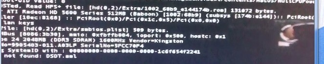

test hd5670 (640sp) failure

remake bootload
svn co -r HEAD Http://forge.voodooprojects.org/svn/chameleon/branches/Kabyl
edit ati.c
add { 0x68B9, 0xE144174B, CHIP_FAMILY_JUNIPER, "ATI Radeon HD 5600 Series", kBaboon },
MAKE V=99
CP BOOT ./
cp 1002_68b9_e144174b.rom /extra
edit ATI5000Controller.kext add 0x68B91002
edit com.apple.boot
<key>Kernel</key>
<string>mach_kernel</string>
<key>Kernel Flags</key>
<string>-v </string>
<key>UseAtiROM</key>
<string>yes</string>
<key>GraphicsEnabler</key>
<string>Yes</string>
<key>Timeout</key>
<string>1</string>
<key>Legacy Logo</key>
<key>EthernetBuiltIn</key>
</dict>
</plist>
reboot
test1
SET PCIORRTUUID=1
Login failed
Responsive keyboard does not crash
test2
set PCIROOTUUID=0
Log function
Identification failure Graphics Cards
