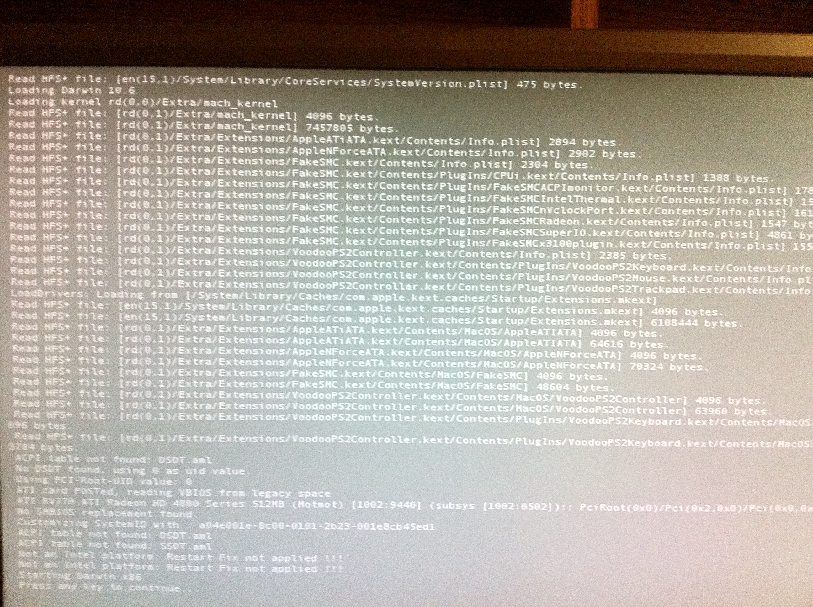

Hi,
I too have gone through all 30 AtiConfig framebuffer entries. I either get a hang just before the graphics should appear or I get a screen that is black with 4 columns of white vertical bars and misc snow.
I have a HD4870 512MB VisionTek running in a Asus M3A32-MVP Deluxe, 2 GB ram, AMD 9850 Phenom.
I run Leopard 10.5.8 and 10.5.6 on two different HD's with no problems.
Looking to move to SL on it's own drive but can't get past this video??? problem.
any suggestions would be appreciated.
Oh yes, 4870 Bios 011.003.000.001 I also ensured there is no overclocking set.
Cheers
which boot cd you used
and try boot with
Wait=yes -v
and take picture for this

use Nawcom ModCD instead.

hello all,
so upon successfully loading boot cd 1.6 i then swapped out the boot cd for the retail dvd and then hit f5. some code loaded across the screen and then it just hangs. the last few lines of code are as follows:
    com.apple.driver.AppleACPIPlatform(1.3.2)@0x7a157000->0x7a197fff
         dependency: com.apple.iokit.IOACPIFamily(1.3.0)@0x79ec4000
         dependency: com.apple. iokit.IOACPIFamily(2.6)@0x7a0b6000
my system:
amd phenom quad core
esc a79ogxm-a black series (mobo)
8g corsair (mem)
pny geforce 8400 gs (graphics card)
ocz 64 gb sdd
thanks,
ratroder
try use 4 gig of ram and load defualt of MB bios setting
Started all over again.
Got a new HardDisk for MAC.
->Booted from BootCD 1.6 & Installed MAC OSx 10.6.4
->Installed Combo Update 10.6.5 & Restarted.(Added IOUSB kext)
->Installed Chameleon RC4 2.0 , legacy kernel 10.5 (without -force64)
->Downloaded netkas ATY_int driver added Vervet ,installed in E/E.
->Installed ATI5000Controller.kext (with my device ID) , ATIFramebuffer.kext, ATISupport.kext to S/L/E/
->Restarted. Got my resolution correct.But no QE/CI.
->Added ATI3000.kext (with My Device ID),ATI3000GLDriver, ATI3000VADriver to S/L/E.
->Rebooted. Got the Desktop but NO QE/CI.(Also in verbose i get - ATI-68be already has keys set)
What am i missing?Plz help.
if you use gfx injection no need for aty
and did you do pfix after editing kexts
