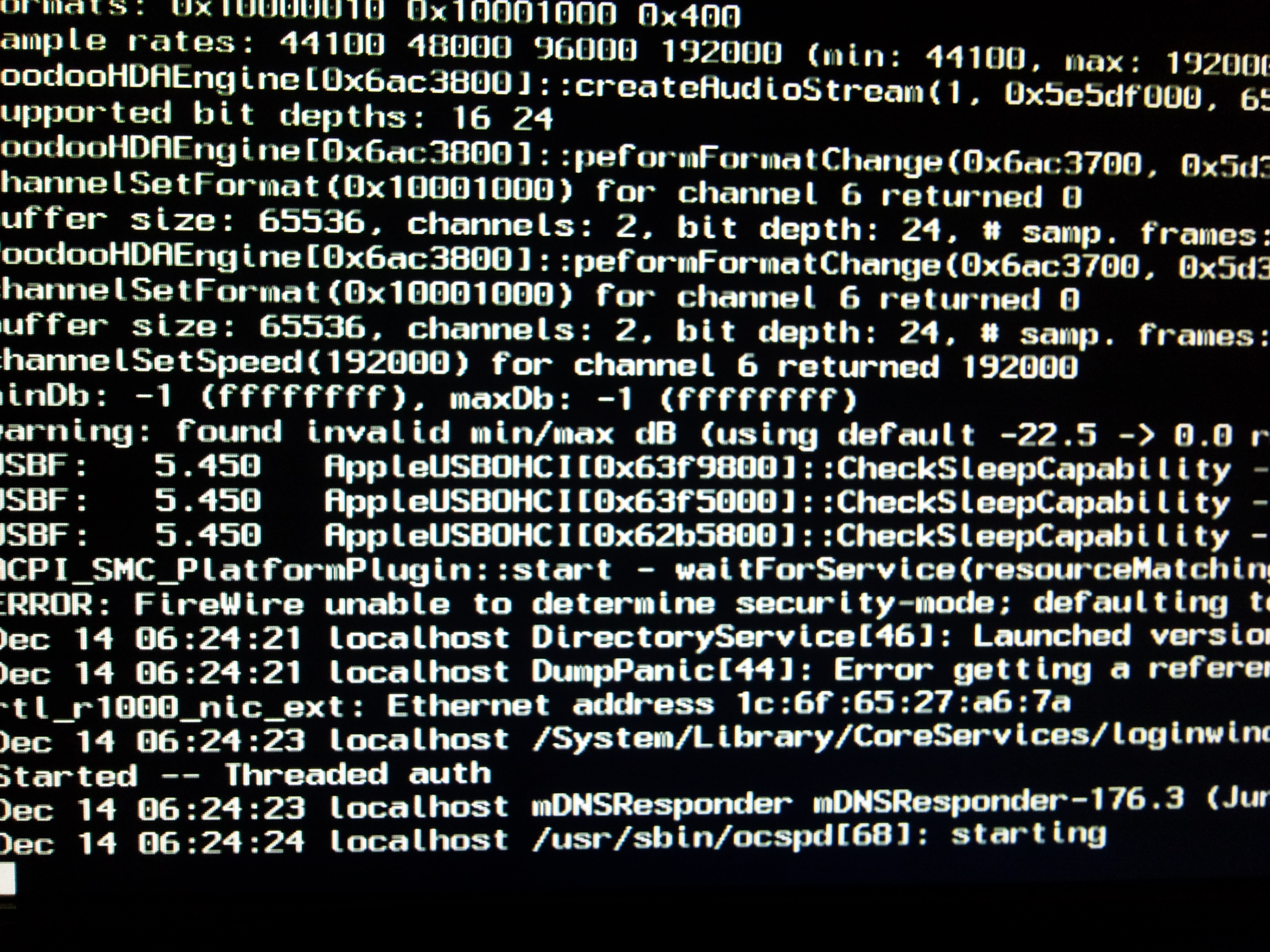

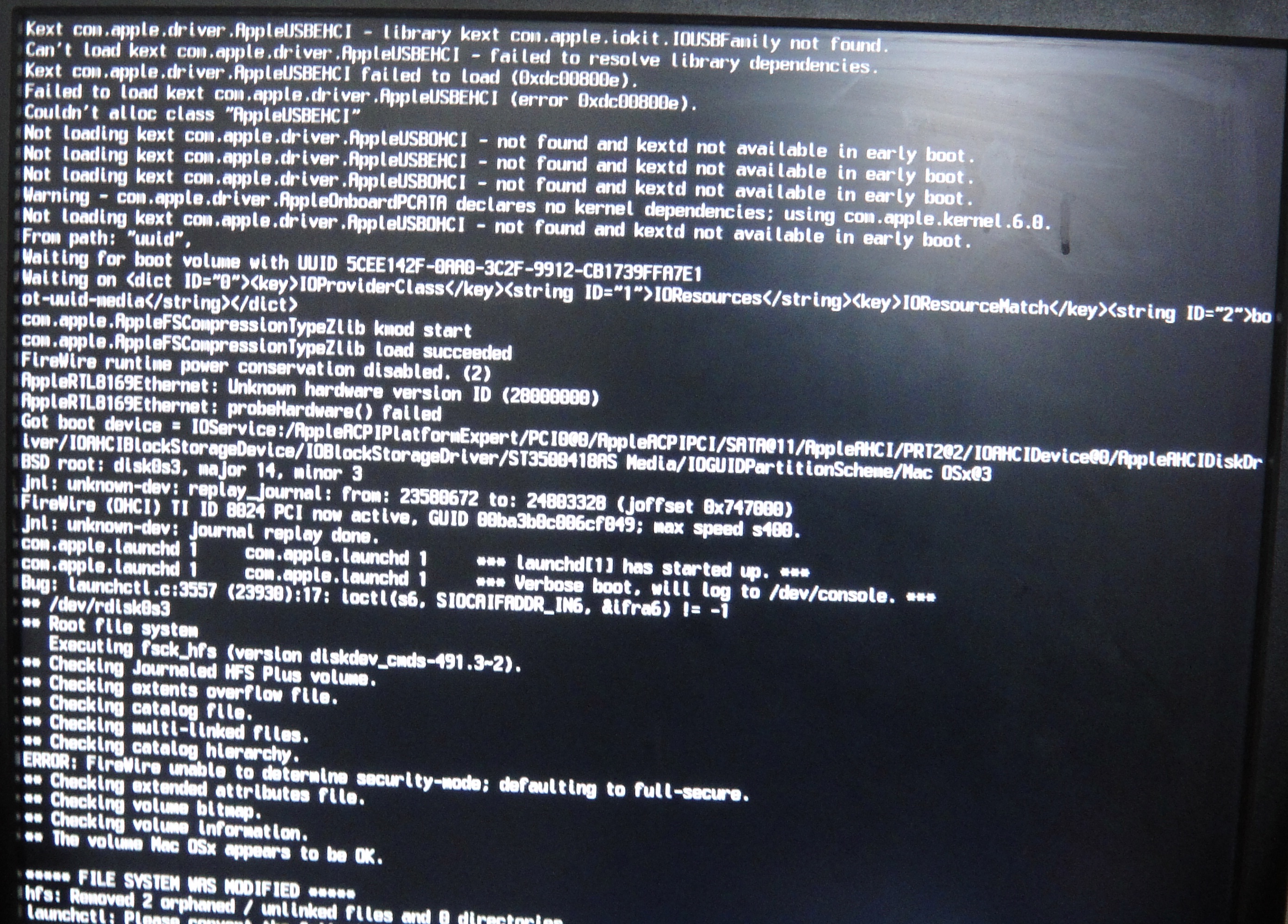

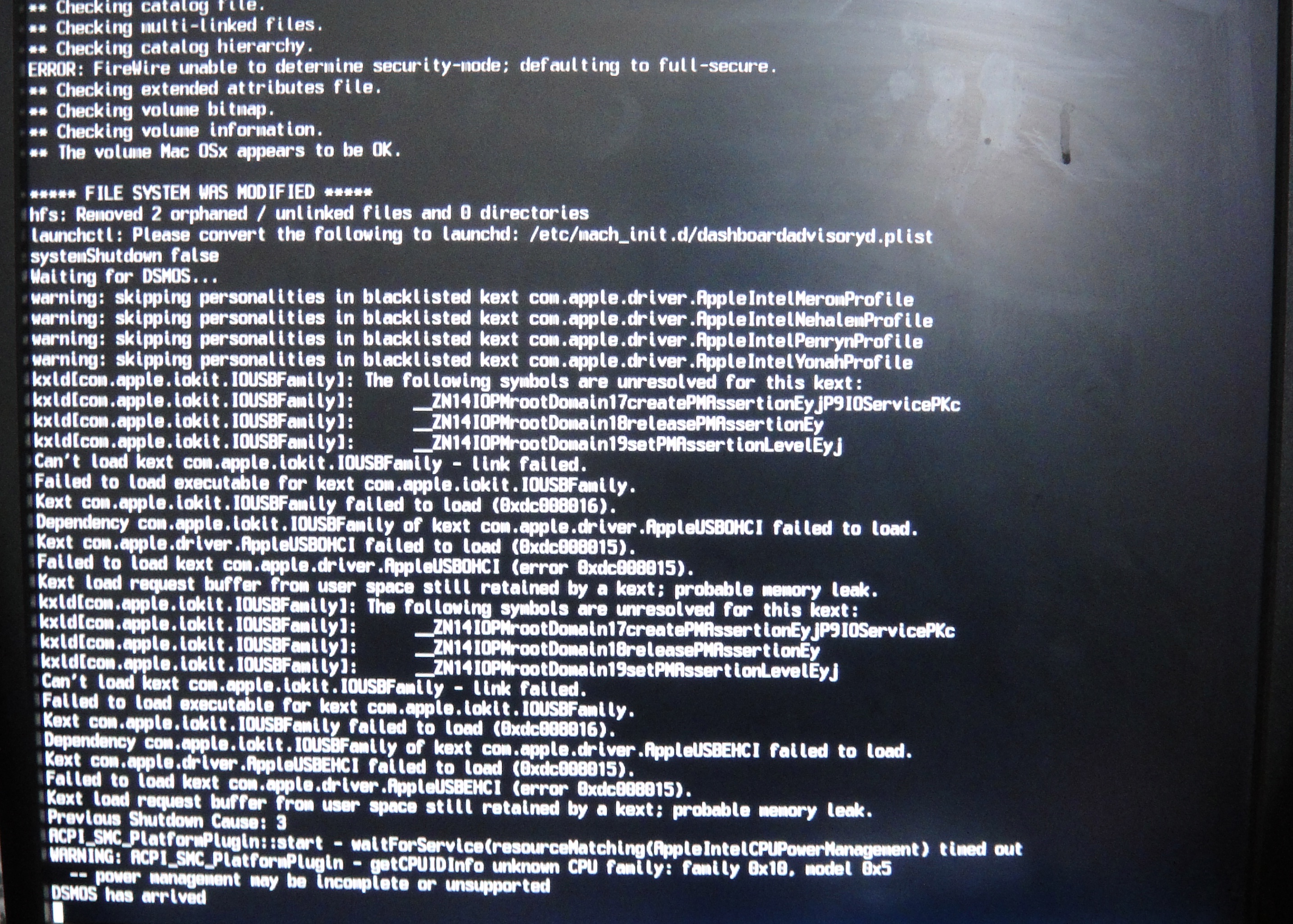

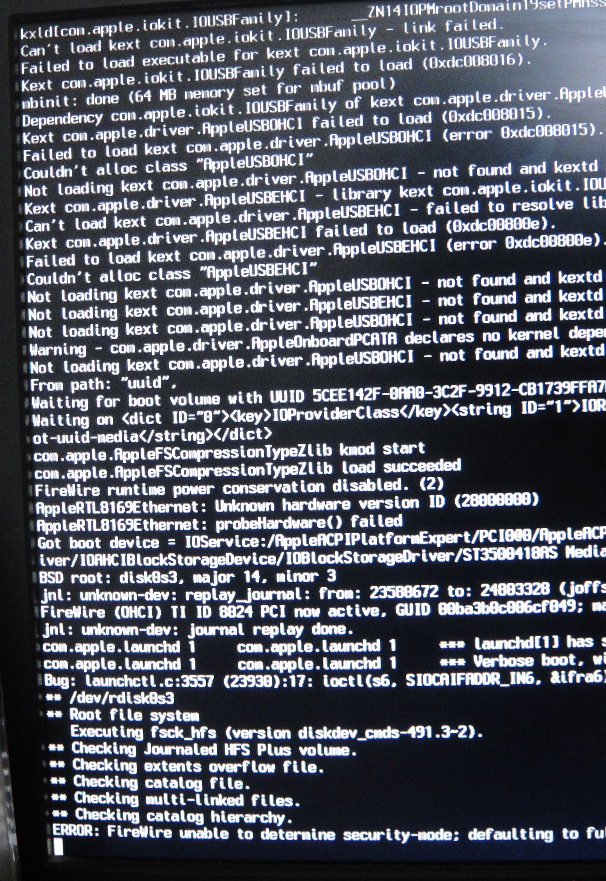

kalmdave Posted December 13, 2010 Share Posted December 13, 2010 Ok i'll do that, and update you. Please don't go, please. I neeed to get over it tonite. Thanks. Find me boot.plist edited that i used with the boot file that you gave. also find 2 screenies of the errors that i received post that. I could get a good resolution if screenies in one shot , so they are in two parts i hope they are informative enuff, or else i'll shoot one shot for you again. com.apple.Boot.plist_Edited.rtf Link to comment https://www.insanelymac.com/forum/topic/227592-amd-and-retail-snow-leopard-1065-1068-finalguide/page/35/#findComment-1601680 Share on other sites More sharing options...
Mohamed Khairy Posted December 13, 2010 Author Share Posted December 13, 2010 Ok i'll do that, and update you. Please don't go, please. I neeed to get over it tonite. Thanks. Find me boot.plist edited that i used with the boot file that you gave. also find 2 screenies of the errors that i received post that. I could get a good resolution if screenies in one shot , so they are in two parts i hope they are informative enuff, or else i'll shoot one shot for you again. picture doesnt show any thing spesifc can you see dmos recived ? Link to comment https://www.insanelymac.com/forum/topic/227592-amd-and-retail-snow-leopard-1065-1068-finalguide/page/35/#findComment-1601696 Share on other sites More sharing options...
kalmdave Posted December 13, 2010 Share Posted December 13, 2010 picture doesnt show any thing spesifccan you see dmos recived ? DMOS ? How do i find it? Link to comment https://www.insanelymac.com/forum/topic/227592-amd-and-retail-snow-leopard-1065-1068-finalguide/page/35/#findComment-1601704 Share on other sites More sharing options...
Mohamed Khairy Posted December 13, 2010 Author Share Posted December 13, 2010 DMOS ? How do i find it? do new picture for all screen Link to comment https://www.insanelymac.com/forum/topic/227592-amd-and-retail-snow-leopard-1065-1068-finalguide/page/35/#findComment-1601714 Share on other sites More sharing options...
kalmdave Posted December 13, 2010 Share Posted December 13, 2010 Ok I think i understood Dsmos.kext = Dont Steal Mac OS X.kext ? Are asking do i see that line Dont Steal Mac OS X line while booting in verbose mode? Ok i'll do all screens. Link to comment https://www.insanelymac.com/forum/topic/227592-amd-and-retail-snow-leopard-1065-1068-finalguide/page/35/#findComment-1601715 Share on other sites More sharing options...

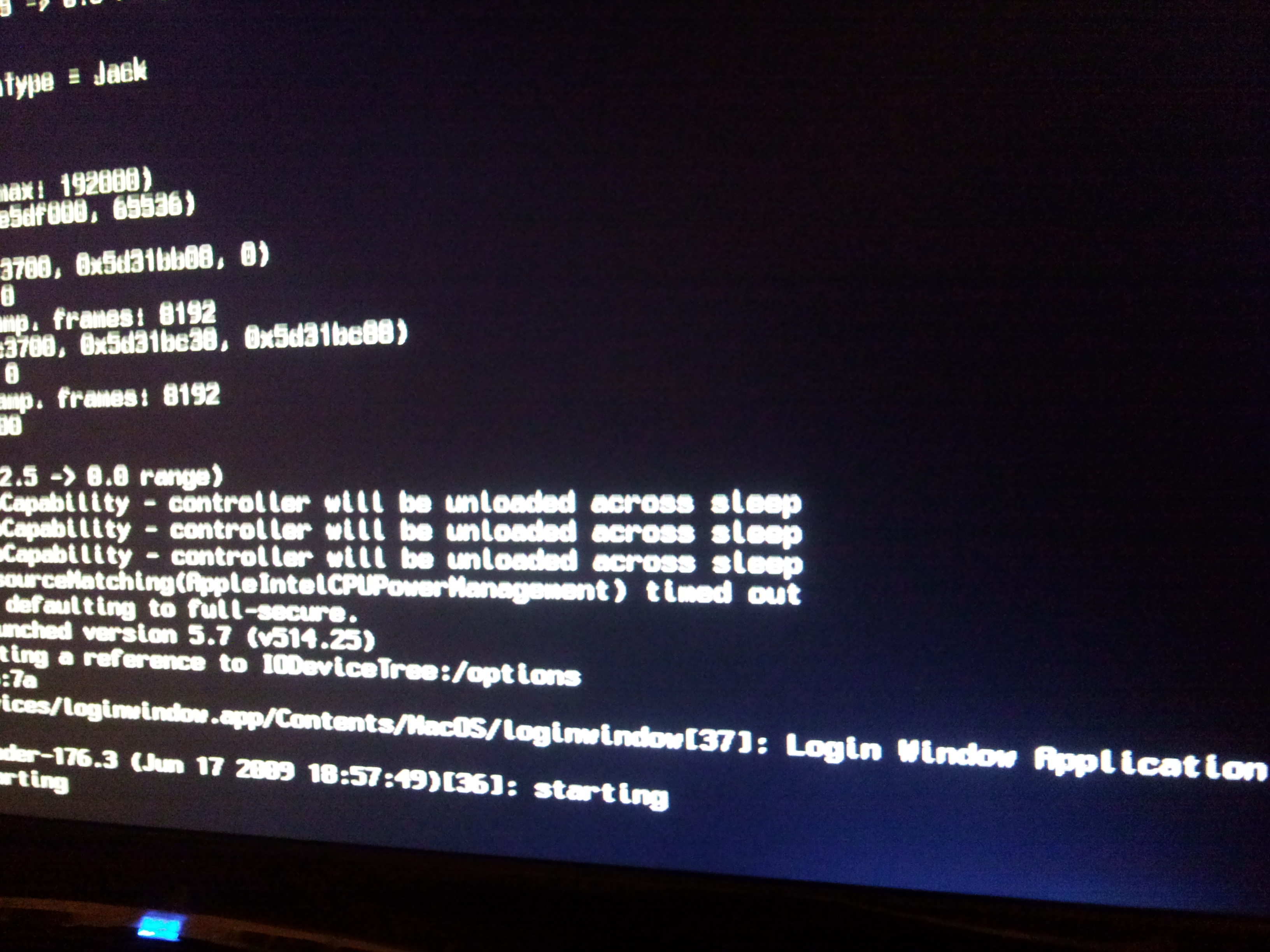

kalmdave Posted December 13, 2010 Share Posted December 13, 2010 Here's a combo of pics and video of my system. 14122010A1_.rar 14122010001.zip Link to comment https://www.insanelymac.com/forum/topic/227592-amd-and-retail-snow-leopard-1065-1068-finalguide/page/35/#findComment-1601726 Share on other sites More sharing options...

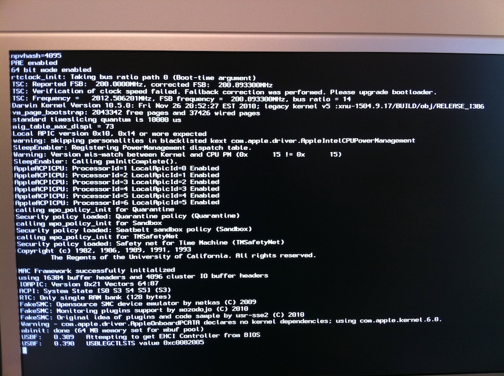

Malay Keshav Posted December 14, 2010 Share Posted December 14, 2010 which bootcd you used i used bootCD 1.5 given in the guide. The Screenshot :: Link to comment https://www.insanelymac.com/forum/topic/227592-amd-and-retail-snow-leopard-1065-1068-finalguide/page/35/#findComment-1601946 Share on other sites More sharing options...
Mohamed Khairy Posted December 14, 2010 Author Share Posted December 14, 2010 i used bootCD 1.5 given in the guide. The Screenshot :: make sure you use this bootcd not other as this only contain 10.5 kernel that support usb on 10.6.5 Link to comment https://www.insanelymac.com/forum/topic/227592-amd-and-retail-snow-leopard-1065-1068-finalguide/page/35/#findComment-1602090 Share on other sites More sharing options...
Malay Keshav Posted December 14, 2010 Share Posted December 14, 2010 make sure you use this bootcd not other as this only contain 10.5 kernel that support usb on 10.6.5 Installed legacy kernal 10.5 AND EVERYTHING WORKIN!!! I can boot from Hard Disk as well!!! Thanks for the awesom guide Mahamed!!! i had lost hope in installing MAC on my AMD PC, and was going to buy a mac pro.. now i can work on my project if possible, can you please guide how to get my ATI 5750 working? Link to comment https://www.insanelymac.com/forum/topic/227592-amd-and-retail-snow-leopard-1065-1068-finalguide/page/35/#findComment-1602108 Share on other sites More sharing options...

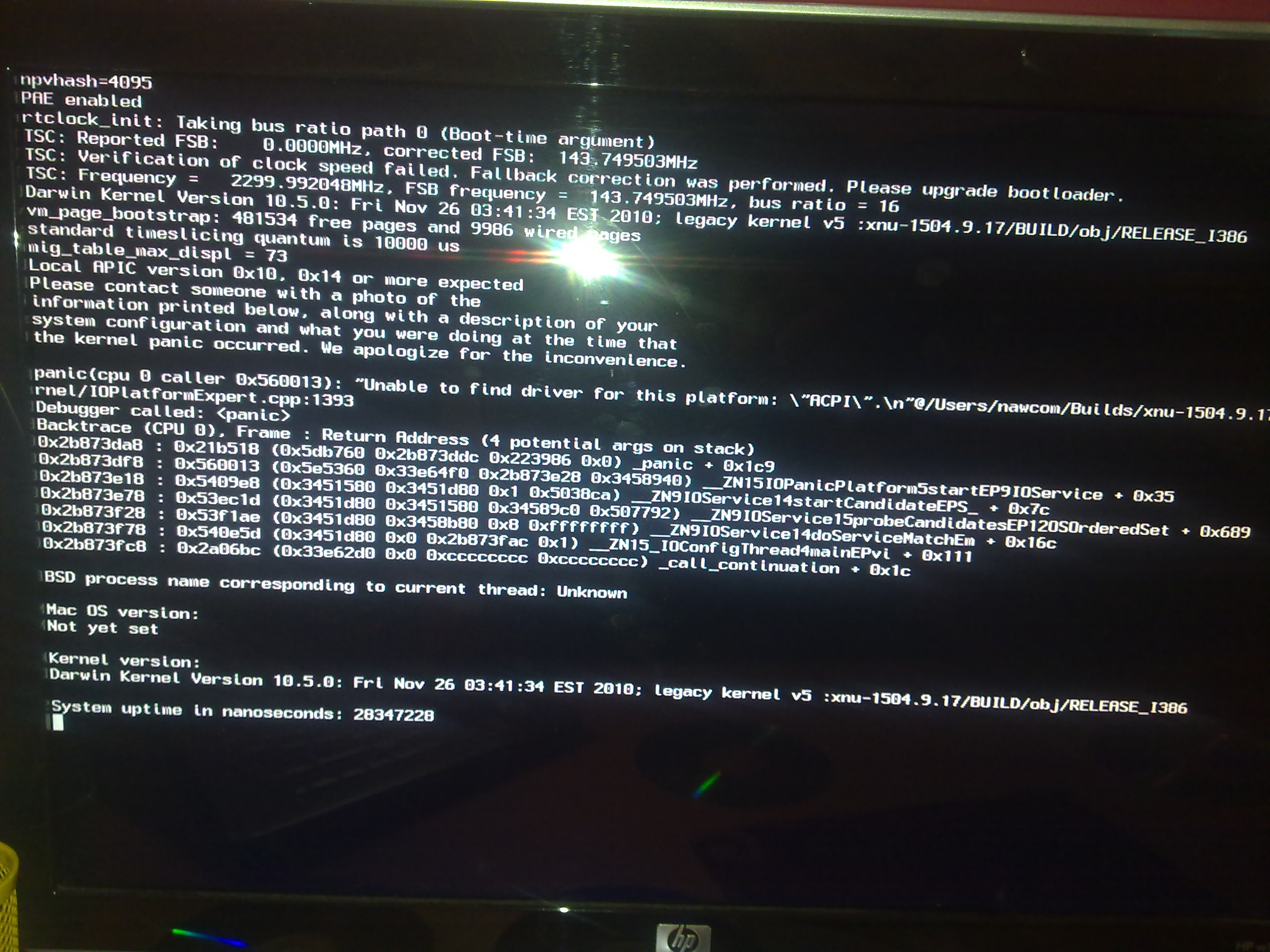

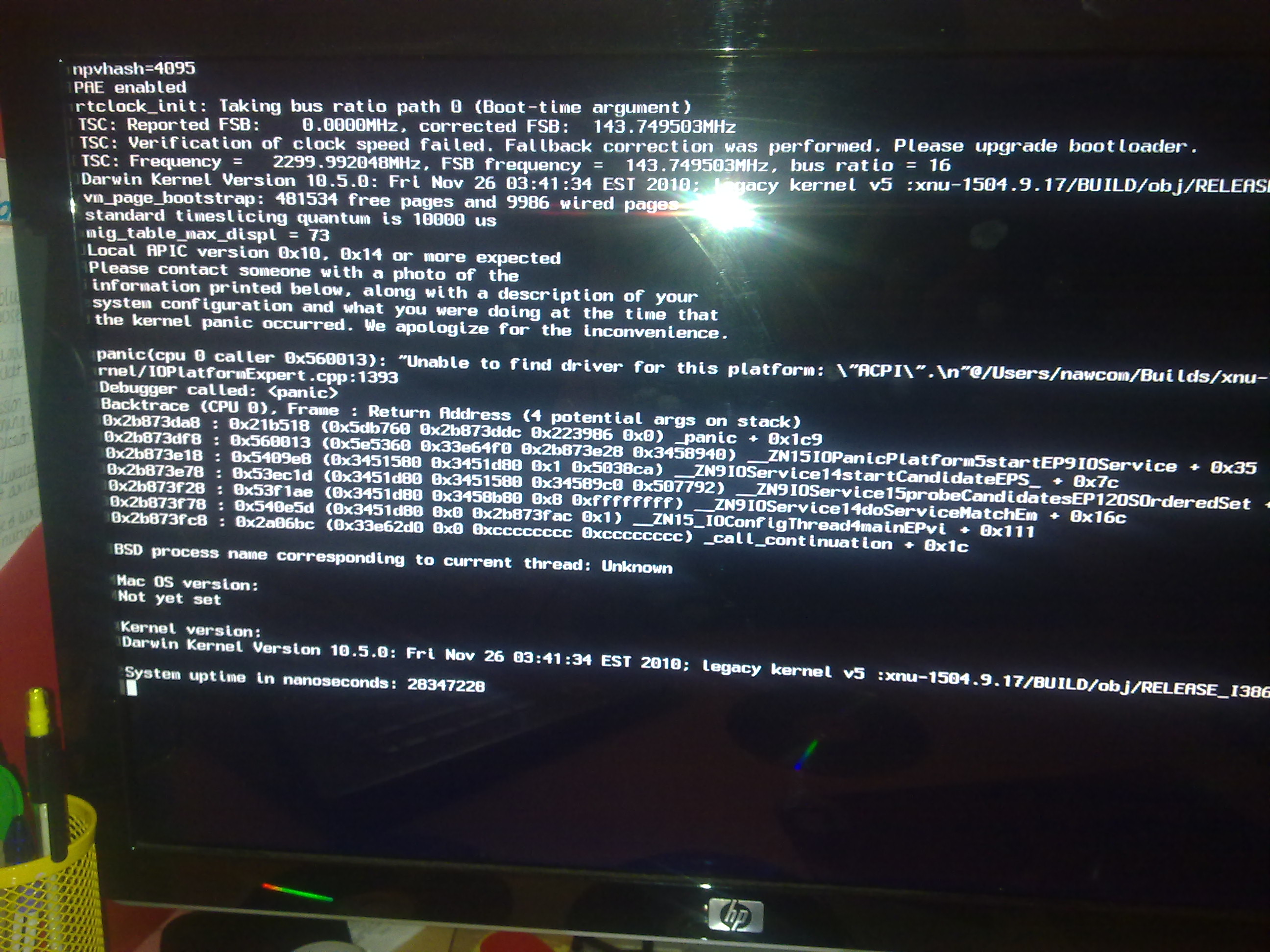

littledude565 Posted December 15, 2010 Share Posted December 15, 2010 I there man, great guide. I've downloaded the bootcd but when i try and boot it it gives me a load of errors. Heres a picture in the attachments Link to comment https://www.insanelymac.com/forum/topic/227592-amd-and-retail-snow-leopard-1065-1068-finalguide/page/35/#findComment-1602986 Share on other sites More sharing options...
Mohamed Khairy Posted December 15, 2010 Author Share Posted December 15, 2010 Question: My AMD Phenom II X6 1055T is being used in my Pro Tools, and when I try to bounce a song to disk it says (CPU Overload Occured) all 6 cores are activated, its as if its not running full speed or something. It cant go higher that 14 on the multiplier because its not the black edition, could the bus ratio slow down my CPU? you can see speed of cpu from system profiler I there man, great guide. I've downloaded the bootcd but when i try and boot it it gives me a load of errors. Heres a picture in the attachments what is your motherboard name and did you tried mac before on this pc i think no also if you have distru of mac like ideneb iatoks ..... try use them and see if there are the same error if there are same error you can try update bios play around bios setting to me i dont have solution yet for cant find driver for acpi Link to comment https://www.insanelymac.com/forum/topic/227592-amd-and-retail-snow-leopard-1065-1068-finalguide/page/35/#findComment-1602993 Share on other sites More sharing options...
littledude565 Posted December 15, 2010 Share Posted December 15, 2010 Hi thanks for replying, my motherboard is an ASUS m2n61-ar I've got the hazard one and the leo4allv3 they both boot and install fine, well sorta I can get them installed but when i try and boot I always get errors. So I guess my comp can boot MAC Link to comment https://www.insanelymac.com/forum/topic/227592-amd-and-retail-snow-leopard-1065-1068-finalguide/page/35/#findComment-1603013 Share on other sites More sharing options...
Mohamed Khairy Posted December 15, 2010 Author Share Posted December 15, 2010 Hi thanks for replying, my motherboard is an ASUS m2n61-ar I've got the hazard one and the leo4allv3 they both boot and install fine, well sorta I can get them installed but when i try and boot I always get errors. So I guess my comp can boot MAC did you tried snow leopard ones ? Link to comment https://www.insanelymac.com/forum/topic/227592-amd-and-retail-snow-leopard-1065-1068-finalguide/page/35/#findComment-1603020 Share on other sites More sharing options...
littledude565 Posted December 15, 2010 Share Posted December 15, 2010 Yes. I tried both snow leopard and leopard =/ Link to comment https://www.insanelymac.com/forum/topic/227592-amd-and-retail-snow-leopard-1065-1068-finalguide/page/35/#findComment-1603032 Share on other sites More sharing options...
Mohamed Khairy Posted December 15, 2010 Author Share Posted December 15, 2010 Yes. I tried both snow leopard and leopard =/ ithink may be pronlem from new kernel any way try anther boot cds try nawcom one http://www.kexts.com/view/586-nawcom_mod_cd_v0.3.html Link to comment https://www.insanelymac.com/forum/topic/227592-amd-and-retail-snow-leopard-1065-1068-finalguide/page/35/#findComment-1603034 Share on other sites More sharing options...
