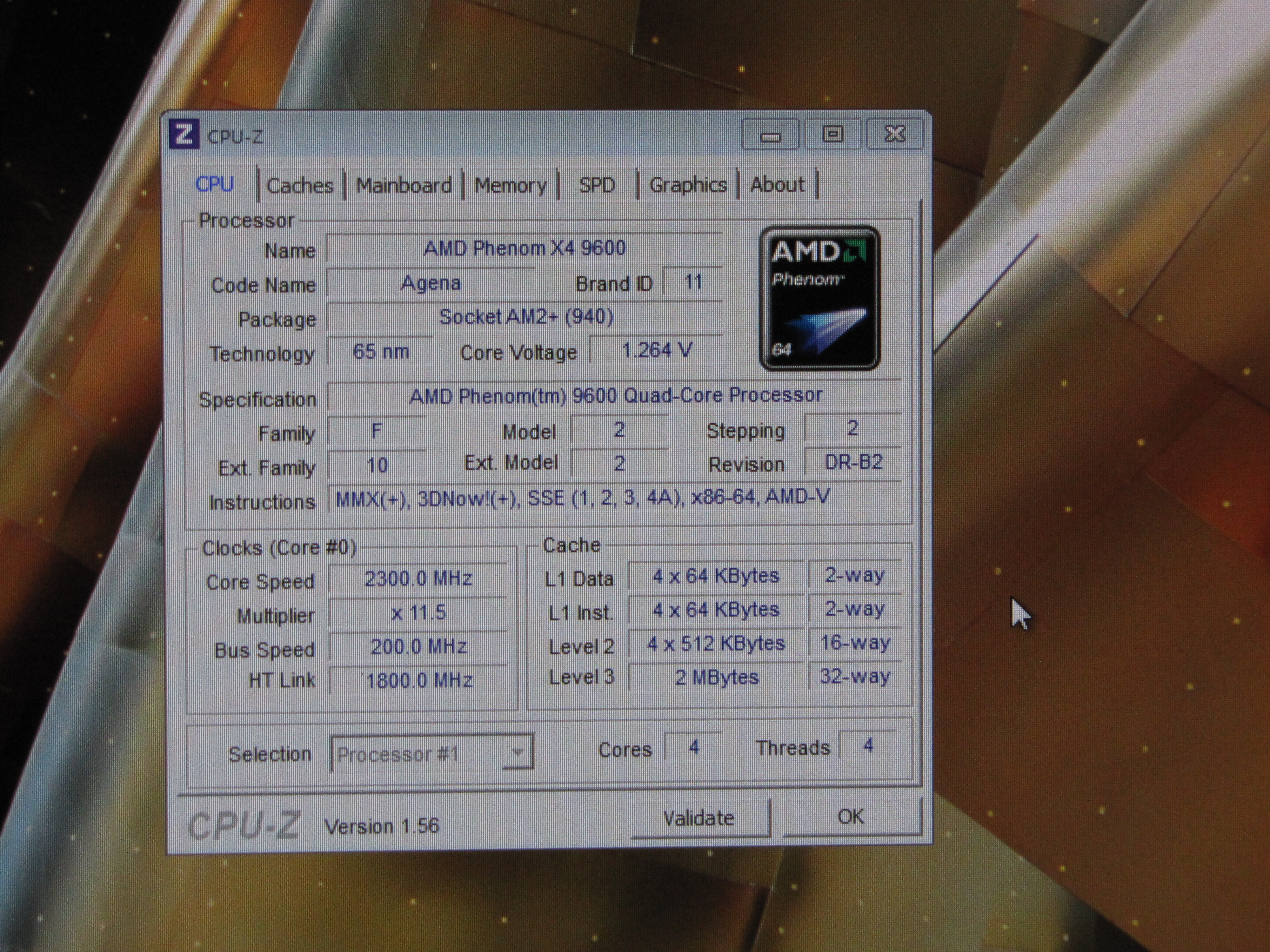

ratroder Posted January 10, 2011 Share Posted January 10, 2011 Config: [hd(0,2)/Extra/com.apple.Boot.plist] 357 bytes. CPU: AMD Phenom 9600 Quad-Core Processor CPU: Vendor/Family/ExtFamily: 0x68747541/0xf/0x1 CPU: Model/ExtModel/Stepping: 0x2/0x0/0x2 CPU: Multipliers x10: max=70, min=0 CPU: MaxDiv/CurrDiv: 0x0/0x1 CPU: TSCFreq: 2300MHz CPU: CPUFreq: 2300MHz CPU: FSBFreq: 328MHz CPU: NoCores/NoThreads: 1/4 CPU: Features: 0x36900221 Chipset is UNKNOWN (pci id 0x96001022) We have an NVIDIA Card Creating 2 Mode Tables New table with id : 0 New table with id : 1 First Standard VESA Table at offset 0x3f1c Second Standard VESA Table at offset 0x877a Table #0 has 16 modes Table #1 has 33 modes Aspect Ratio is 4/3 Patching Table #0 : Mode 1024x768 -> 1024x768 (1047 1183 1343 770 776 805) Patching Table #1 : Mode 640x200 -> 640x10 (664 672 720 18 H- V+) Mode 640x350 -> 640x10 (664 678 720 18 H- V+) Mode 640x400 -> 640x10 (664 680 720 18 H- V+) Mode 640x480 -> 640x10 (669 685 720 18 H- V+) Mode 640x480 -> 640x10 (669 685 720 18 H- V+) Mode 800x600 -> 800x2 (836 852 900 14 H- V+) Mode 800x600 -> 800x2 (836 852 900 14 H- V+) Mode 1024x768 -> 1024x5 (1071 1087 1152 21 H- V+) Mode 1024x768 -> 1024x5 (1071 1087 1152 21 H- V+) Mode 1280x1024 -> 1280x10 (1343 1359 1440 33 H- V+) Mode 1280x1024 -> 1280x10 (1343 1359 1440 33 H- V+) Mode 1280x720 -> 1280x10 (1324 1340 1440 17 H- V-) Mode 1280x800 -> 1280x10 (1330 1346 1440 45 H- V-) Mode 1400x1050 -> 1400x1 (1474 1488 1575 34 H+ V+) Mode 1440x900 -> 1440x2 (1496 1512 1620 38 H+ V-) Mode 1600x1200 -> 1600x4 (1674 1690 1800 29 H- V+) Mode 1680x1050 -> 1680x5 (1745 1761 1890 42 H+ V-) Mode 1920x1200 -> 1920x9 (1995 2011 2160 47 H+ V-) Mode 2048x1536 -> 2048x1 (2144 2160 2048 35 H+ V+) Mode 768x480 -> 768x1 (798 814 864 10 H- V-) Darwin/x86 boot v5.0.132 - Chameleon v5.1 r665:701 Build date: 2011-01-10 17:32:35 8190MB memory VESA v3.0 14MB (NVIDIA) Scanning device 80...Use keys to select the startup volume. hd(0,2) mac osx hd(1,1) Windows NTFS hd(2,1) external drive Press Enter to start up Darwin/x86 with no options, or you can: Type -v and press Enter to start up with diagnostic messages Type ? and press Enter to learn about advanced startup options boot: Config: [hd(0,2)/Extra/com.apple.Boot.plist] 357 bytes. Setting boot-uuid to: E6FB17A8-CA09-3D3C-B58D-EA22939E0CA1 Closing VBios Table #0 : Freeing backup [OK] Table #0 : Freeing [OK] Table #1 : Freeing backup [OK] Table #1 : Freeing [OK] Freeing map [OK] Loading Darwin 10.6 Loading kernel legacy_kernel LoadDrivers: /System/Library/Caches/com.apple.kext.caches/Startup/Extensions.mkext No DSDT found, using 0 as uid value. Using PCI-Root-UID value: 0 No SMBIOS replacement found. Patched DMI Table Found SMBIOS System Information Table 1 Customizing SystemID with : 00020003-0004-0005-0006-000700080009 efi_inject_get_devprop_string NULL trying stringdata Not an Intel platform: Restart Fix not applied !!! Patched ACPI version 1 DSDT Starting Darwin x86 logout [Process completed] that is what was in my terminal window or atleast the newer of the two anval folders. sorry about this but i seem to be having a brain fart on this, but can you explain the way first thing again in maybe a different way? Link to comment https://www.insanelymac.com/forum/topic/227592-amd-and-retail-snow-leopard-1065-1068-finalguide/page/42/#findComment-1619899 Share on other sites More sharing options...
Mohamed Khairy Posted January 10, 2011 Author Share Posted January 10, 2011 @ratroder can you give me picture for your cpu on windows by cpuz Link to comment https://www.insanelymac.com/forum/topic/227592-amd-and-retail-snow-leopard-1065-1068-finalguide/page/42/#findComment-1619904 Share on other sites More sharing options...
ratroder Posted January 10, 2011 Share Posted January 10, 2011 better yet i think, here is an html file link of the data from the program. Link to comment https://www.insanelymac.com/forum/topic/227592-amd-and-retail-snow-leopard-1065-1068-finalguide/page/42/#findComment-1619921 Share on other sites More sharing options...
Mohamed Khairy Posted January 10, 2011 Author Share Posted January 10, 2011 better yet i think, here is an html file link of the data from the program. file:///C:/Users/steve/Desktop/STEVE-PC.html lol you linked file from your computer upload it from forum Link to comment https://www.insanelymac.com/forum/topic/227592-amd-and-retail-snow-leopard-1065-1068-finalguide/page/42/#findComment-1619926 Share on other sites More sharing options...
ratroder Posted January 10, 2011 Share Posted January 10, 2011 it has been one of those days. here is an image of the info of the cpu and a txt file of the whole thing. PC.txt Link to comment https://www.insanelymac.com/forum/topic/227592-amd-and-retail-snow-leopard-1065-1068-finalguide/page/42/#findComment-1619934 Share on other sites More sharing options...
Mohamed Khairy Posted January 10, 2011 Author Share Posted January 10, 2011 it has been one of those days. here is an image of the info of the cpu and a txt file of the whole thing. thanks very much are you solved program crashes or not Link to comment https://www.insanelymac.com/forum/topic/227592-amd-and-retail-snow-leopard-1065-1068-finalguide/page/42/#findComment-1619937 Share on other sites More sharing options...
ratroder Posted January 10, 2011 Share Posted January 10, 2011 no problem. no still unable to open itunes, any kext installer, and fire fox. Link to comment https://www.insanelymac.com/forum/topic/227592-amd-and-retail-snow-leopard-1065-1068-finalguide/page/42/#findComment-1619938 Share on other sites More sharing options...
Mohamed Khairy Posted January 10, 2011 Author Share Posted January 10, 2011 no problem. no still unable to open itunes, any kext installer, and fire fox. go to mac open terminal type this sudo -s amd_insn_patcher /usr/lib/libSystem.B.dylib /usr/lib/libSystem.B.dylib.patched cp /usr/lib/libSystem.B.dylib.patched /usr/lib/libSystem.B.dylib Link to comment https://www.insanelymac.com/forum/topic/227592-amd-and-retail-snow-leopard-1065-1068-finalguide/page/42/#findComment-1619944 Share on other sites More sharing options...
