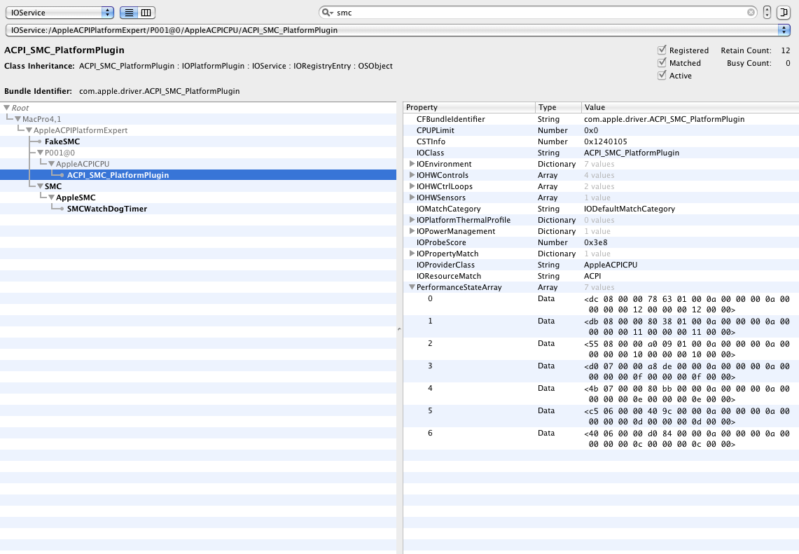

ToBeMac Posted November 5, 2010 Share Posted November 5, 2010 Ok, just an update: The problem again was that Speedstep was activated, 8 P-states generated (Checked using bdmesg and found 'em in ioreg) but the CPU was stuck on the lowest P-state (537Mhz). A further inspection of ioreg under: ACPI_SMC_PlatformPlugin i found the property "CPUPLimit" has a value of 0x7 which is P-State #8 (537Mhz), and after some googling i found that the reason for such a problem is that no MacBook/Pro/Air has 8 P-States, to solve it i had to do one of the following: * Choose another Mac model in SMbios.plist, a one that might have 8 P-States but since no MacBook has such a number i would have to choose a MacPro, iMac..etc , something that i didn't want to do since mine is a laptop. OR * Edit the plist file for the model i already choosed (MacBook3,1) in: S/L/E/IOPlatformPluginFamily.kext/Contents/PlugIns/ACPI_SMC_PlatfomPlugin/Contents/Resources/MacBook3_1.plist Then add the following lines just before "<key>StepDataDict</key>" : <key>PLimitDict</key> <dict> <key>MacBook3,1</key> <integer>0</integer> </dict> Those lines enforce the CPUPLimit property to be 0x0 hence speedstep will work in the full range of P-States. Sorry for making it that long but i just wanted to explain it in detail so it might help someone else with the same probelm. The rest of my problem now is that C-States are generated successfully but i can't see any CSTinfo in ioreg and memory speed is detected as 600Mhz instead of 667Mhz. Am using r629 which i compiled couple of days ago. Any hints? Thanks, ToBeMac Link to comment https://www.insanelymac.com/forum/topic/225766-chameleon-rc5-mode-with-mem-detection-enabled-and-automatic-p-states-c-states-generation-for-native-power-managment/page/41/#findComment-1577130 Share on other sites More sharing options...

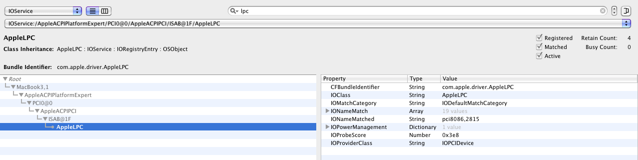

Gringo Vermelho Posted November 6, 2010 Share Posted November 6, 2010 * added the method you mentioned above with my own device id: That's your problem right there. If your LPC device's device ID was known by the driver, you would not need to patch the device ID in the first place! The whole idea of adding the device ID is to replace your LPC device's device ID with one that is recognized by AppleLPC.kext. Check info.plist inside and (not sure how much this matters) pick one that is close to your real ID. Link to comment https://www.insanelymac.com/forum/topic/225766-chameleon-rc5-mode-with-mem-detection-enabled-and-automatic-p-states-c-states-generation-for-native-power-managment/page/41/#findComment-1577467 Share on other sites More sharing options...
ToBeMac Posted November 6, 2010 Share Posted November 6, 2010 That's your problem right there. If your LPC device's device ID was known by the driver, you would not need to patch the device ID in the first place! The whole idea of adding the device ID is to replace your LPC device's device ID with one that is recognized by AppleLPC.kext. Check info.plist inside and (not sure how much this matters) pick one that is close to your real ID. Well, that's true i believe since with or without the method, i have AppleLPC load with the correct device ID: Yet the problem remains, getting the same C-State error at boot and no CSTinfo in ioreg. Maybe i have to do something in MacBook3_1.plist file in ACPI_SMC_PlatfomPlugin just like i did to change CPUPlimit to 0x0? or it's just the C-State "curse" of Dell? You are far from alone in this particular boat. Here is a good topic discussion which references this issue and its possible causes: http://www.insanelymac.com/forum/index.php?showtopic=190780 This is likely to be my last Dell. I'm getting a Mac next. Yep! the new MacBook Air is so seductive Link to comment https://www.insanelymac.com/forum/topic/225766-chameleon-rc5-mode-with-mem-detection-enabled-and-automatic-p-states-c-states-generation-for-native-power-managment/page/41/#findComment-1577928 Share on other sites More sharing options...

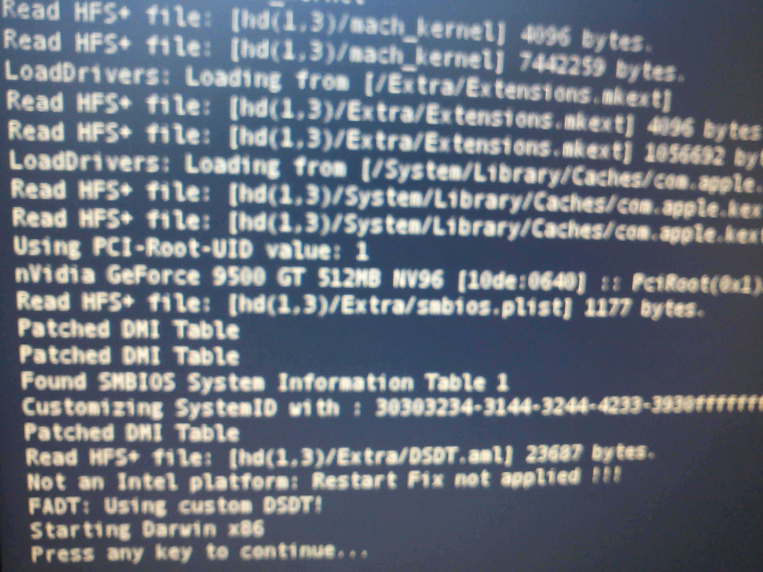

Peter_sm Posted November 7, 2010 Share Posted November 7, 2010 I have installed the new boot loader on my AMD machine, but now I can't boot :-( I think it must be a solution to fix this :-) Or is the only way to fix this to make a new installation of the OS ? I have attached a photo what's going on when booting, after "press any key to continue...." it's just reboots :-( Help EDIT I have try to boot with -x , but with no luck EDIT 2 I have made a new installation of the OS, it's looks like this boot loader don't like AMD //Peter Link to comment https://www.insanelymac.com/forum/topic/225766-chameleon-rc5-mode-with-mem-detection-enabled-and-automatic-p-states-c-states-generation-for-native-power-managment/page/41/#findComment-1578072 Share on other sites More sharing options...
