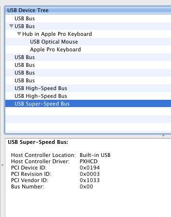

jestera Posted November 4, 2010 Share Posted November 4, 2010 Lacie have released a USB 3.0 driver for OSX. I have installed it ok on my hackintosh (Gigabyte x58-UDR3 v2.0) board and it comes up in system profiler as a 'USB Super speed Bus' (See the attachment). The downer is I haven't got a USB 3.0 device to test it out. You can get the driver from this link on the Lacie site: http://www.lacie.com/more/index.htm?id=10112 Read the instructions and you can see the download link. Can someone test it out? Link to comment https://www.insanelymac.com/forum/topic/224256-usb-30-osx-support-by-caldigit/#findComment-1576512 Share on other sites More sharing options...
cartri Posted November 4, 2010 Share Posted November 4, 2010 Lacie have released a USB 3.0 driver for OSX. I have installed it ok on my hackintosh (Gigabyte x58-UDR3 v2.0) board and it comes up in system profiler as a 'USB Super speed Bus' (See the attachment). The downer is I haven't got a USB 3.0 device to test it out. You can get the driver from this link on the Lacie site: http://www.lacie.com/more/index.htm?id=10112 Read the instructions and you can see the download link. Can someone test it out? Thaaaaaank you! do you know if its NEC based? Link to comment https://www.insanelymac.com/forum/topic/224256-usb-30-osx-support-by-caldigit/#findComment-1576530 Share on other sites More sharing options...
dtessier Posted November 4, 2010 Share Posted November 4, 2010 Thaaaaaank you!do you know if its NEC based? Since he installed the driver on his Gigabyte X58A-UD3R, and it seems to have picked up the device properly, I would say the LaCie PCIe USB3 card is indeed NEC-based (the X58A-UD3R has a NEC uPD720200 on-board). Link to comment https://www.insanelymac.com/forum/topic/224256-usb-30-osx-support-by-caldigit/#findComment-1576604 Share on other sites More sharing options...
jestera Posted November 4, 2010 Share Posted November 4, 2010 Lacie don't say exactly which chip it is, but they say: LaCie USB 3.0 PCI ExpressCard main features Add two USB 3.0 ports to your computer. The fastest technology available on the market (up to 5Gb/s). NEC component for the highest level of performance and compatibility. Backward compatible with USB 2.0 devices So it is NEC. Link to comment https://www.insanelymac.com/forum/topic/224256-usb-30-osx-support-by-caldigit/#findComment-1576633 Share on other sites More sharing options...
cartri Posted November 4, 2010 Share Posted November 4, 2010 Better then that, i could not see a subvendor id on this. it seems to simply match the 0330 class (usb3). And also it does not modify the IOUSBFamily, so, or this is some kind of cosmetical kext to make the ports just work as normal and say they are 3.0 or they really made a great job on that. I will test on U3S6 this weekend PS asus also uses D720200F1 NEC chip. these boards will sell like crazy if apple dont truncate the actual iousbfamily like they did with the ALC88x. Link to comment https://www.insanelymac.com/forum/topic/224256-usb-30-osx-support-by-caldigit/#findComment-1576654 Share on other sites More sharing options...
stellarola Posted November 4, 2010 Share Posted November 4, 2010 This is fantastic. I'm about to try it when I get off work. -Stell Link to comment https://www.insanelymac.com/forum/topic/224256-usb-30-osx-support-by-caldigit/#findComment-1576662 Share on other sites More sharing options...
cartri Posted November 4, 2010 Share Posted November 4, 2010 Argh, i cant hold myself, i will plug this right now, tell you what happens in some moments. it works works works works still no usb3 device here so it reports 500mAh and 480Mbps ill screenshot soon Link to comment https://www.insanelymac.com/forum/topic/224256-usb-30-osx-support-by-caldigit/#findComment-1576668 Share on other sites More sharing options...
jestera Posted November 4, 2010 Share Posted November 4, 2010 Thanks for the screenshots! Hopefully someone out there has a USB 3 device to definitely make sure it works and can let us know the kind of speeds they get using it. Link to comment https://www.insanelymac.com/forum/topic/224256-usb-30-osx-support-by-caldigit/#findComment-1576695 Share on other sites More sharing options...
cartri Posted November 4, 2010 Share Posted November 4, 2010 ops, i did shot one wrong, this is more valid: And so, can anyone get 0x3e8 (1Ah) or at least 0x384 (900mAh) in these ports current? Link to comment https://www.insanelymac.com/forum/topic/224256-usb-30-osx-support-by-caldigit/#findComment-1576699 Share on other sites More sharing options...
