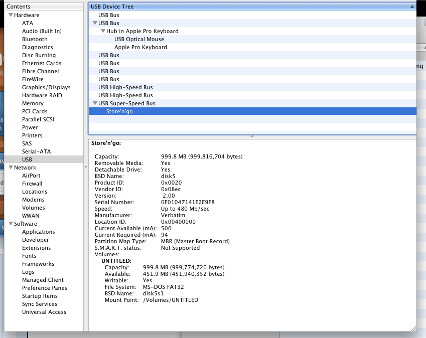

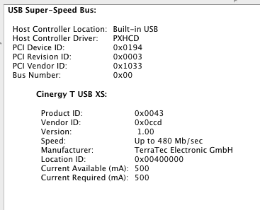

cartri Posted November 4, 2010 Share Posted November 4, 2010 as my mobo had no USB3 i did buy a U3S6 from asus, which has a bridge and uses a PCIe 4x slot, inside the board are marvell sataIII(6Gbps) and nec usb3, the sata part was always recognized normally as a AHCI port. But, as I dont have a SSD I cant really test its speed Link to comment https://www.insanelymac.com/forum/topic/224256-usb-30-osx-support-by-caldigit/page/2/#findComment-1576728 Share on other sites More sharing options...
Guiferreira Posted November 4, 2010 Share Posted November 4, 2010 @Cartri How did u get in that second screen, with the more complex info? Link to comment https://www.insanelymac.com/forum/topic/224256-usb-30-osx-support-by-caldigit/page/2/#findComment-1576737 Share on other sites More sharing options...
cartri Posted November 4, 2010 Share Posted November 4, 2010 @Cartri How did u get in that second screen, with the more complex info? IORegistry Explorer, a fency gui to the good and old command: ioreg -lw0 The app is included in XCode, available in latest versions trough the Apple (paid) developers program or inside your 10.6 installation disk. Link to comment https://www.insanelymac.com/forum/topic/224256-usb-30-osx-support-by-caldigit/page/2/#findComment-1576743 Share on other sites More sharing options...
Guiferreira Posted November 4, 2010 Share Posted November 4, 2010 IORegistry Explorer, a fency gui to the good and old command: ioreg -lw0 The app is included in XCode, available in latest versions trough the Apple (paid) developers program or inside your 10.6 installation disk. Ty for that. Odd thing we both from brazil speaking english. I'm just a noob on hackintosh, just did the basic [url="http://www.insanelymac.com/forum/topic/279450-why-insanelymac-does-not-support-tonymacx86/"]#####[/url] thing. But got everything up and running in 64 bits. Altough the more advanced stuff is like japanese for me. Link to comment https://www.insanelymac.com/forum/topic/224256-usb-30-osx-support-by-caldigit/page/2/#findComment-1576748 Share on other sites More sharing options...
jestera Posted November 4, 2010 Share Posted November 4, 2010 I don 't have any trouble mounting usb 2.0 devices. USB drive mounts fine. I can't get it to draw more power than 500mA, even with a tv tuner attached. Link to comment https://www.insanelymac.com/forum/topic/224256-usb-30-osx-support-by-caldigit/page/2/#findComment-1576755 Share on other sites More sharing options...
stellarola Posted November 4, 2010 Share Posted November 4, 2010 I don 't have any trouble mounting usb 2.0 devices. USB drive mounts fine. I can't get it to draw more power than 500mA, even with a tv tuner attached. Maybe it uses as much power as needed. Has anyone in this thread even hooked up a USB 3.0 device yet? Stell Link to comment https://www.insanelymac.com/forum/topic/224256-usb-30-osx-support-by-caldigit/page/2/#findComment-1576762 Share on other sites More sharing options...

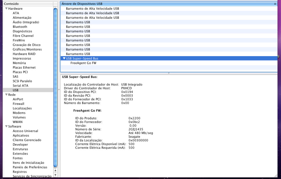

Guiferreira Posted November 5, 2010 Share Posted November 5, 2010 My usb 2.0 Lacie disk mounted, but not my seagate. I'm excited about Black Magic's usb 3 capture card, and areca 8 HD enclosure. I hope u guys manage to make it work. I cant offer anything but feedback. I have a x58a-Ud3r rev.2.0, bios FA Link to comment https://www.insanelymac.com/forum/topic/224256-usb-30-osx-support-by-caldigit/page/2/#findComment-1577226 Share on other sites More sharing options...
cartri Posted November 5, 2010 Share Posted November 5, 2010 My usb 2.0 Lacie disk mounted, but not my seagate. I'm excited about Black Magic's usb 3 capture card, and areca 8 HD enclosure. I hope u guys manage to make it work. I cant offer anything but feedback. I have a x58a-Ud3r rev.2.0, bios FA Pleeease test modbin patch, i was just coming back from work to try IDA on it and... its already done :-D Check his work and feedback! http://www.insanelymac.com/forum/index.php...t&p=1577139 Link to comment https://www.insanelymac.com/forum/topic/224256-usb-30-osx-support-by-caldigit/page/2/#findComment-1577233 Share on other sites More sharing options...
